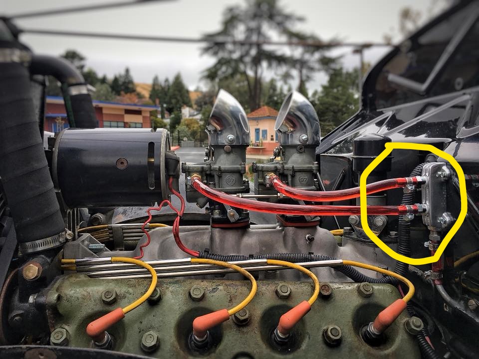

    I have a buddy who bent up some nice steel fuel lines for his flathead, and carefully covered them with the clear, red fuel hose because he liked the look. It looked good, and since it was not exposed to fuel, it did not discolor or become gummy. Though I think the plain, nicely bent steel lines would look better.

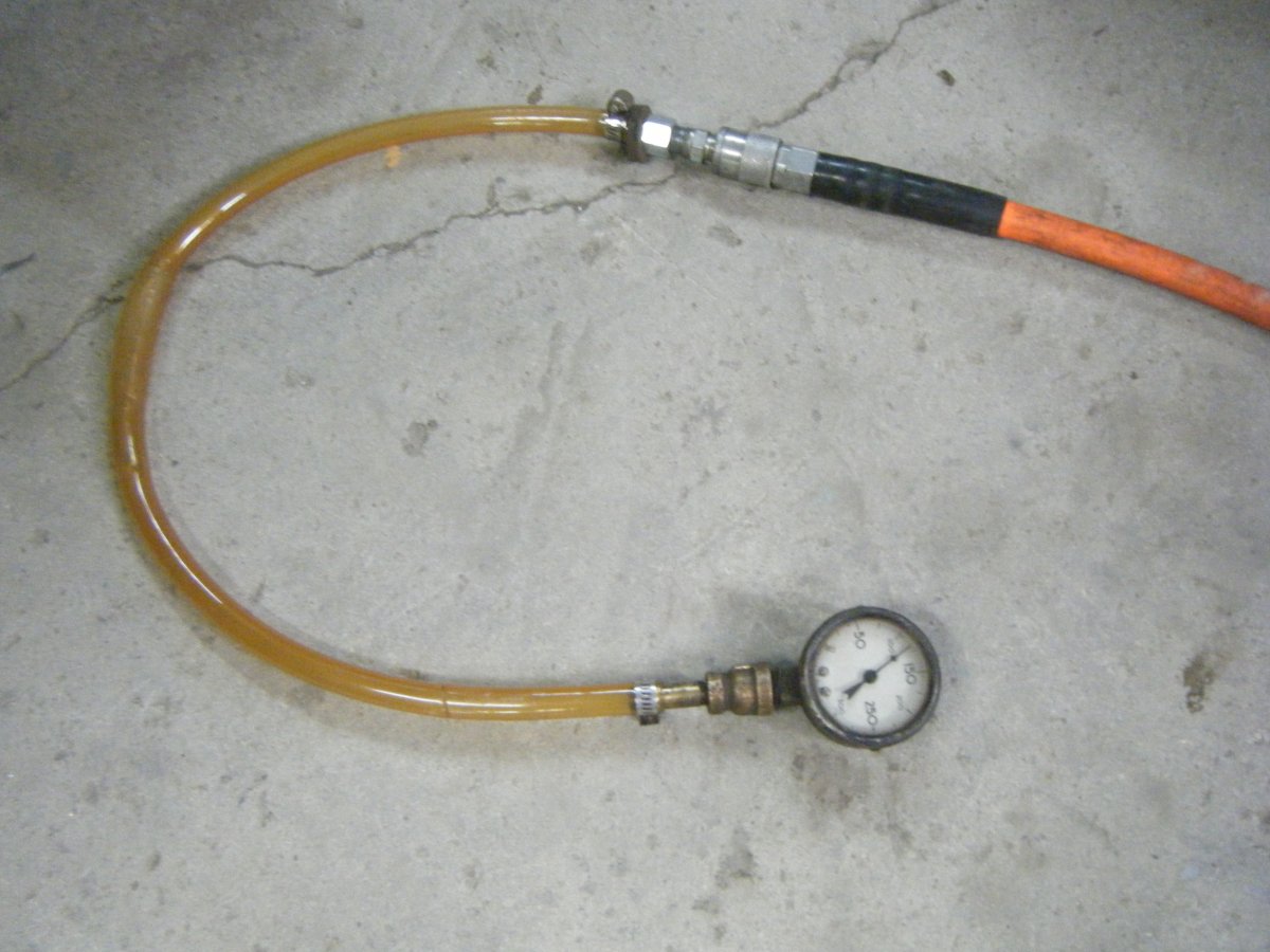

  4. this hose seamed fine and i don't think it would have failed any time soon but because of all the negative opinions i decided to give it a test. first i took the smaller of the two lines [rear carb] and put a gage in one end and a hose fitting in the other end, i then plugged it into an air line. over 110 psi held fine. DSCF0007.JPG

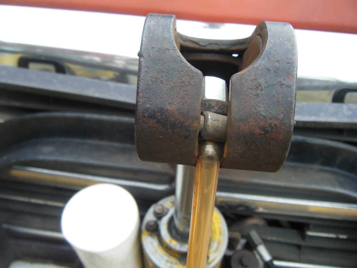

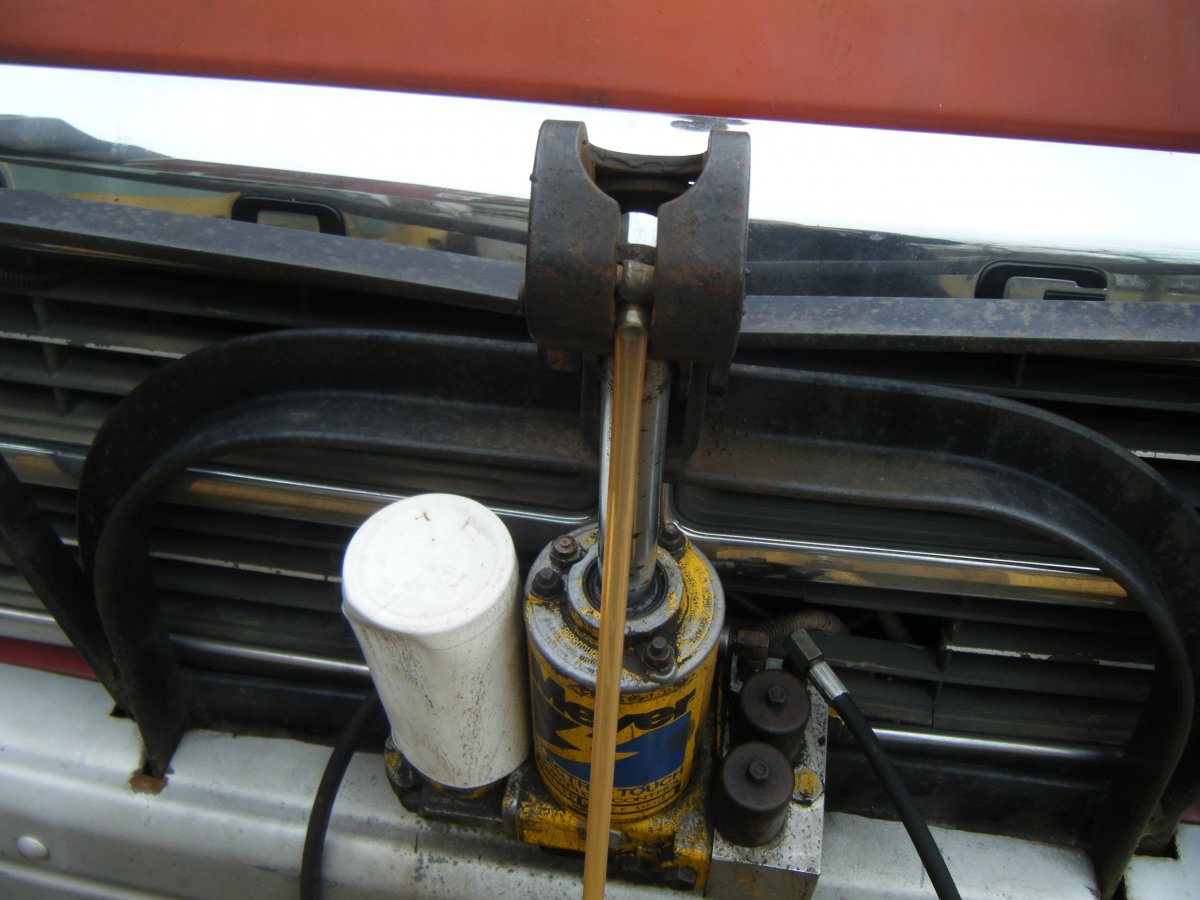

  5. to test just how much tension i could put on it, i took the longer hose and put a hose barb in the end, slid a washer over and then put a clamp on it. i slipped this into the arm on my snow plow pump, put he other end of the hose through the plow chain and tried to lift the plow. at full height the hose had stretched but didn't fail. so i lowered the arm and pulled the hose tighter [pre stretching it]. i then tried to lift the plow [600lbs?] it still didn't lift, but had stretched without breaking. so i pre stretched it some more [as hard as i could by hand] and repeated with the same results. DSCF0008.JPG DSCF0009.JPG DSCF0010.JPG

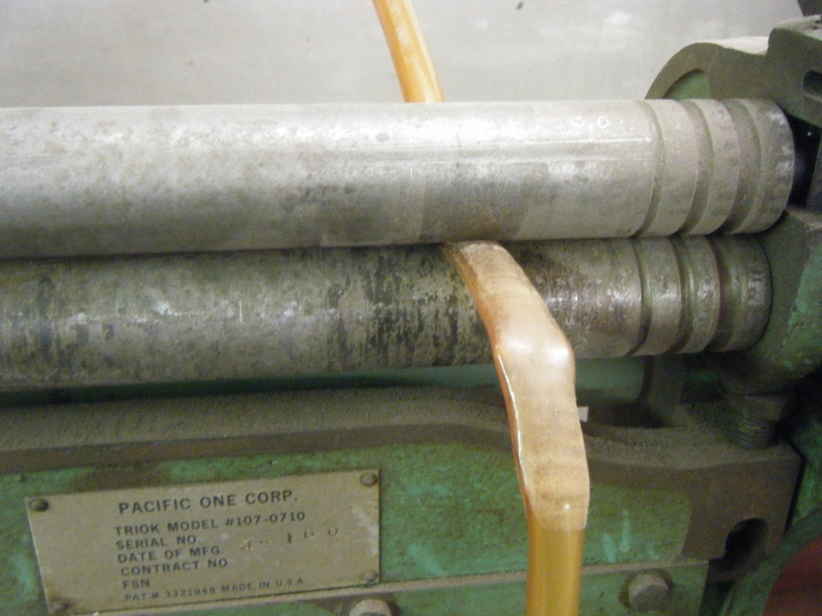

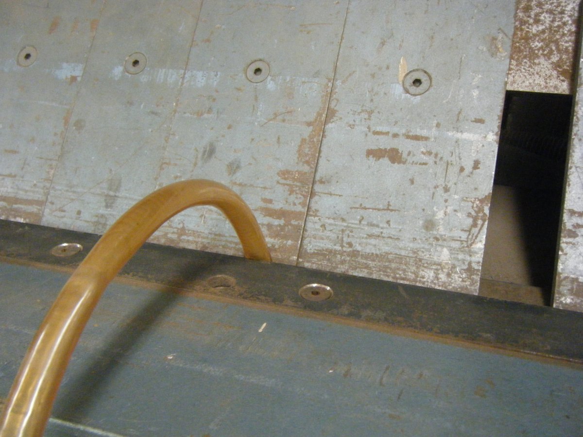

  6. as i was looking around the shop for some other way to "test" the hose i decided to run it through the slip roll. three or four passes through distorted and stretched the hose really flat but it looked fine. i then spotted the sheet metal break and adjusted it "tight". even after bending it over 90 degrees it looked fine. DSCF0011.JPG DSCF0012.JPG

  7. would it still hold pressure? i hooked the gage up and plugged it in.
    compressor has kicked the pressure up to 125 psi................. DSCF0013.JPG
