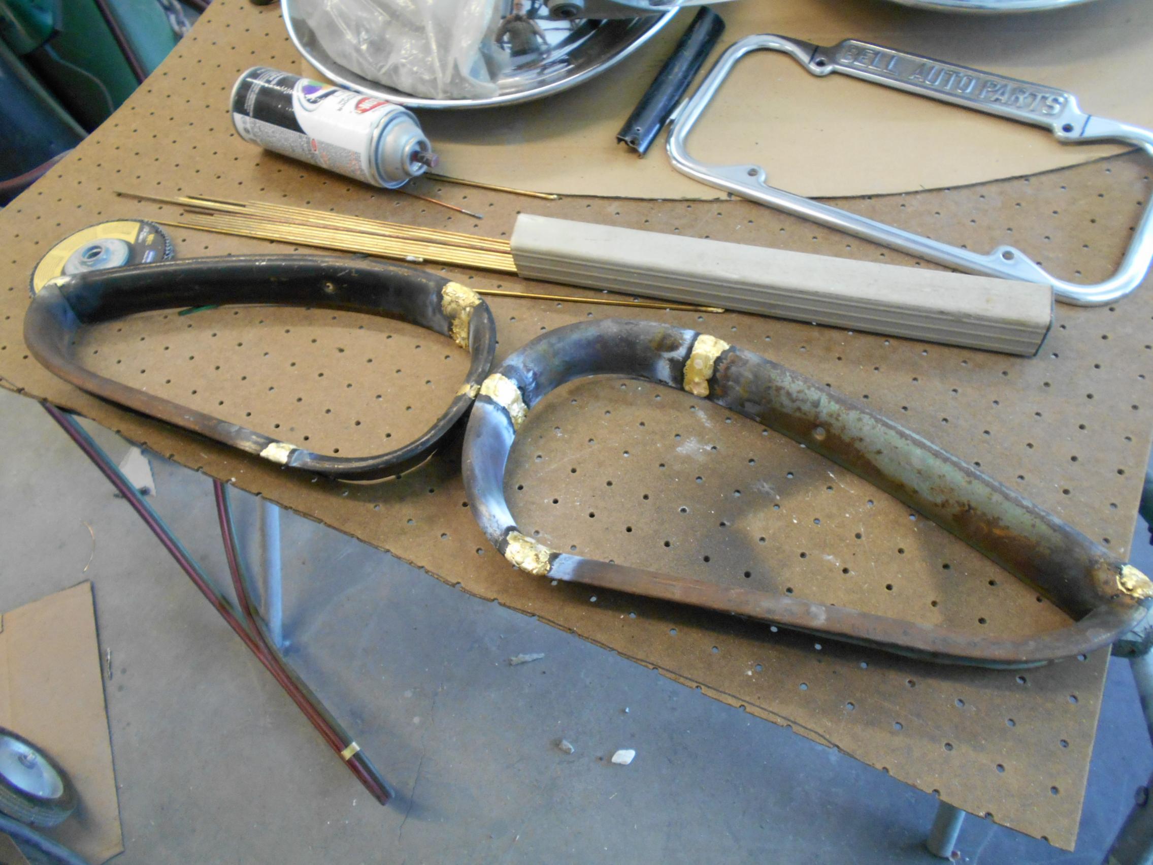

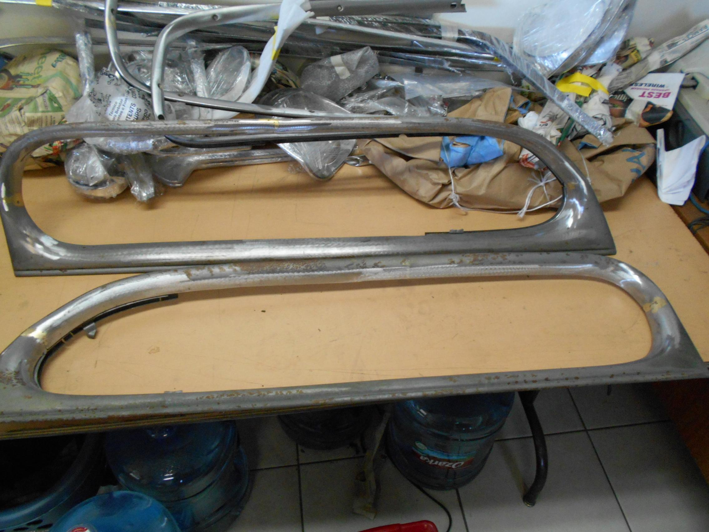

    Here's the 1/4 garnish with the doors. I swung by the platers to get the 1/4's. I think I have to drill one more mounting hole in them. I was glad to see them pretty far along.
    I was told that Monday is probably going to be the day to finish these up. They are going to need some "magic" (muggyweld) solder in some places. Oh boy.

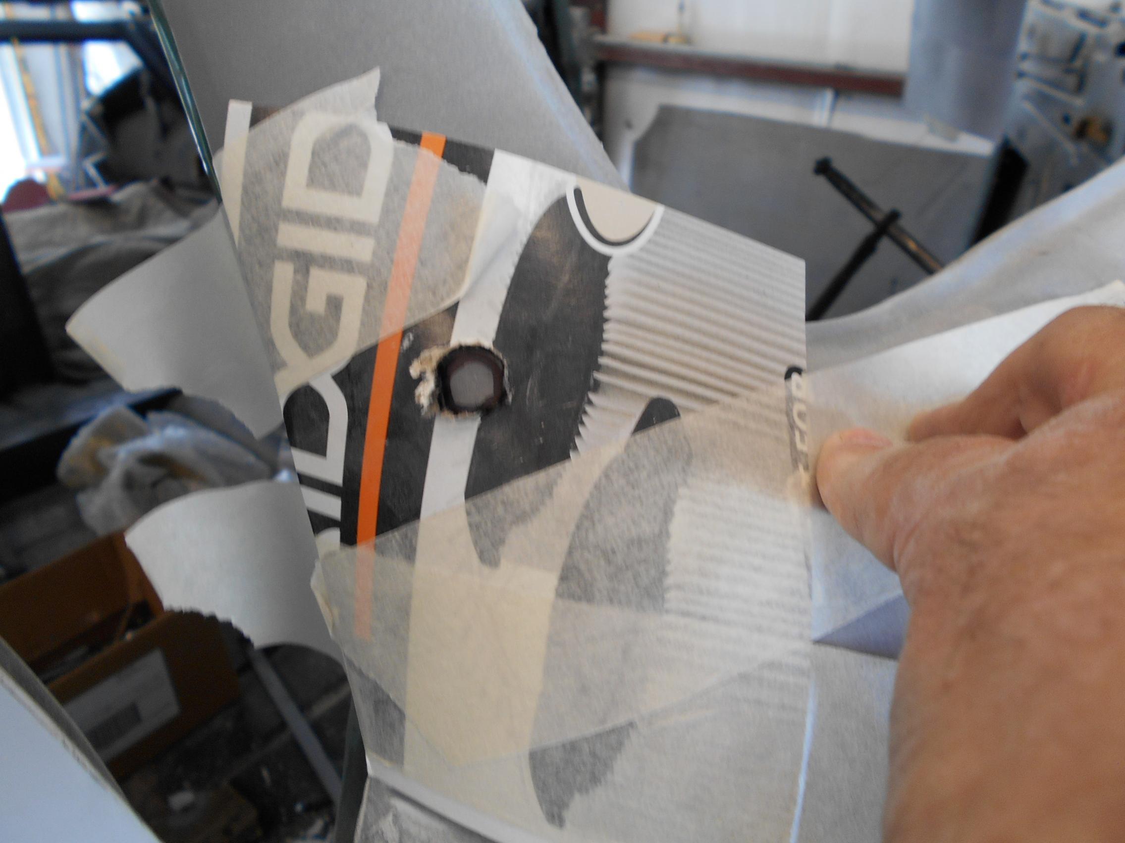

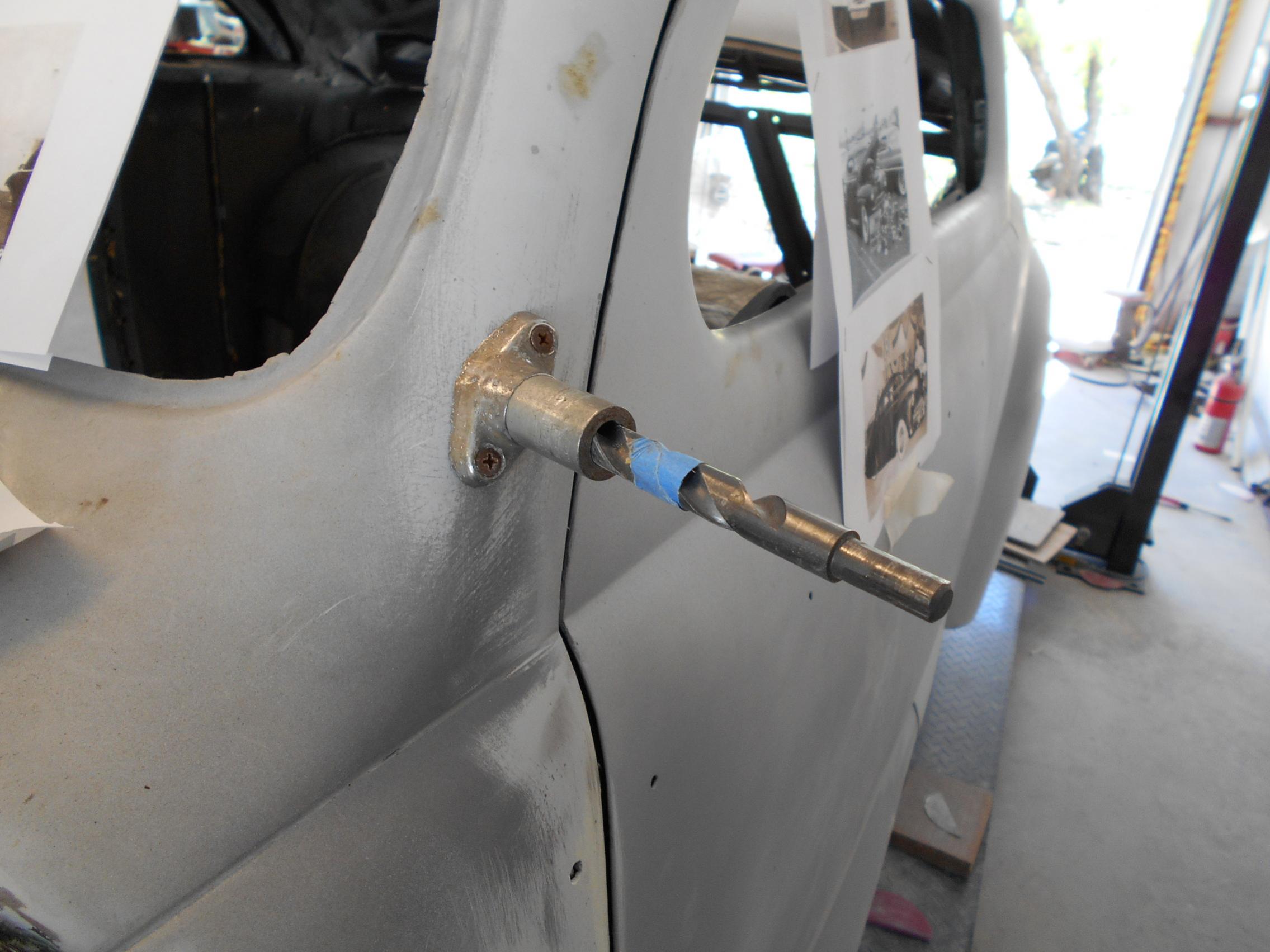

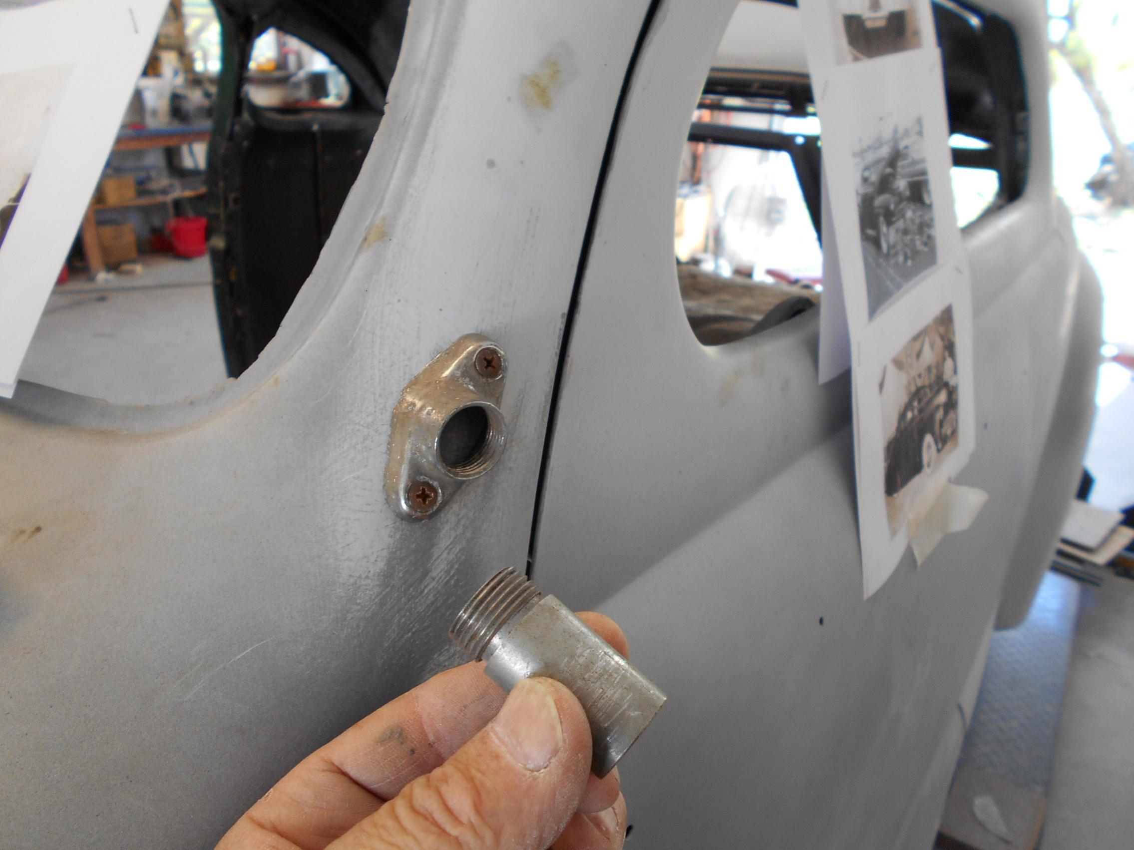

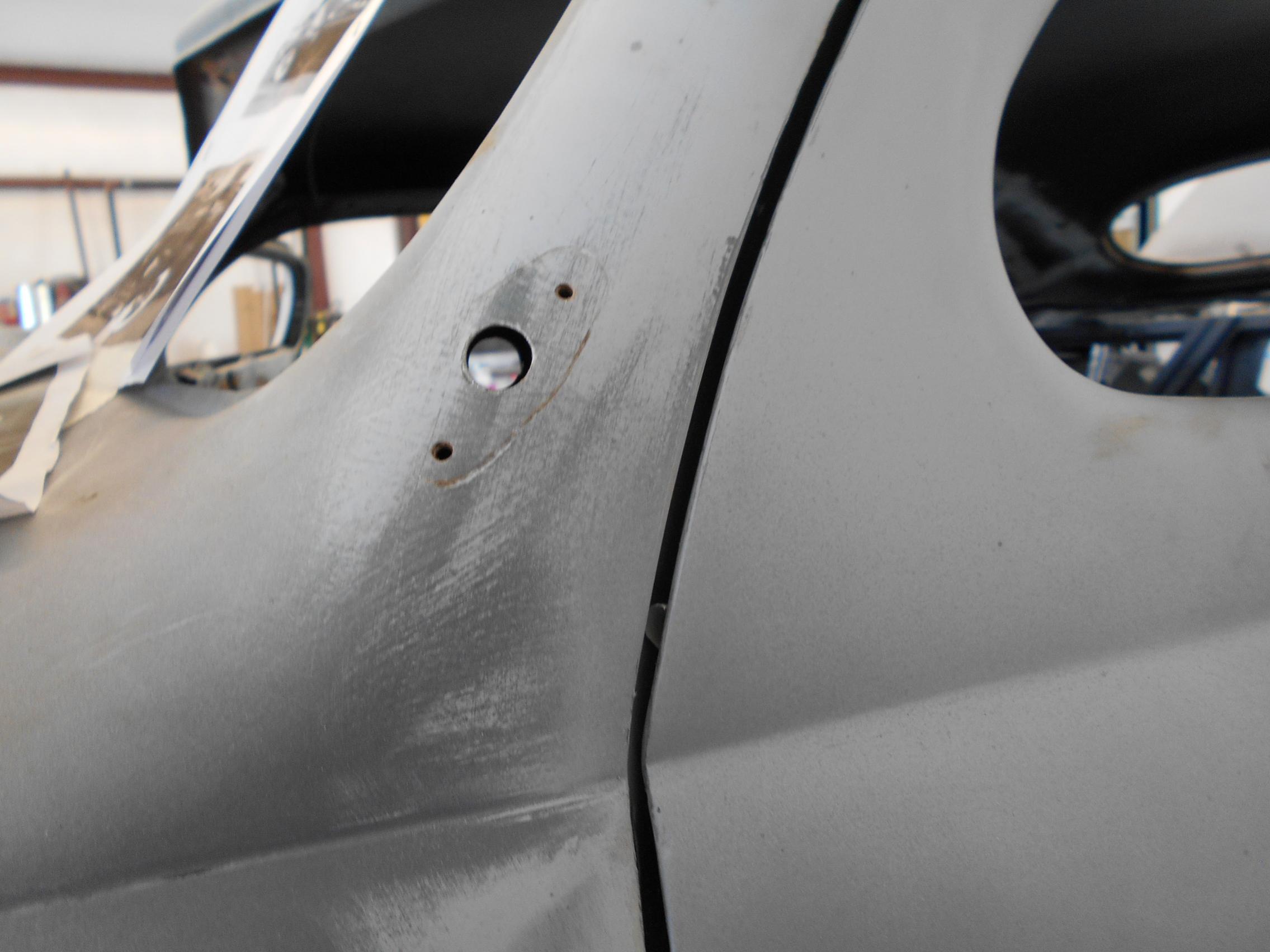

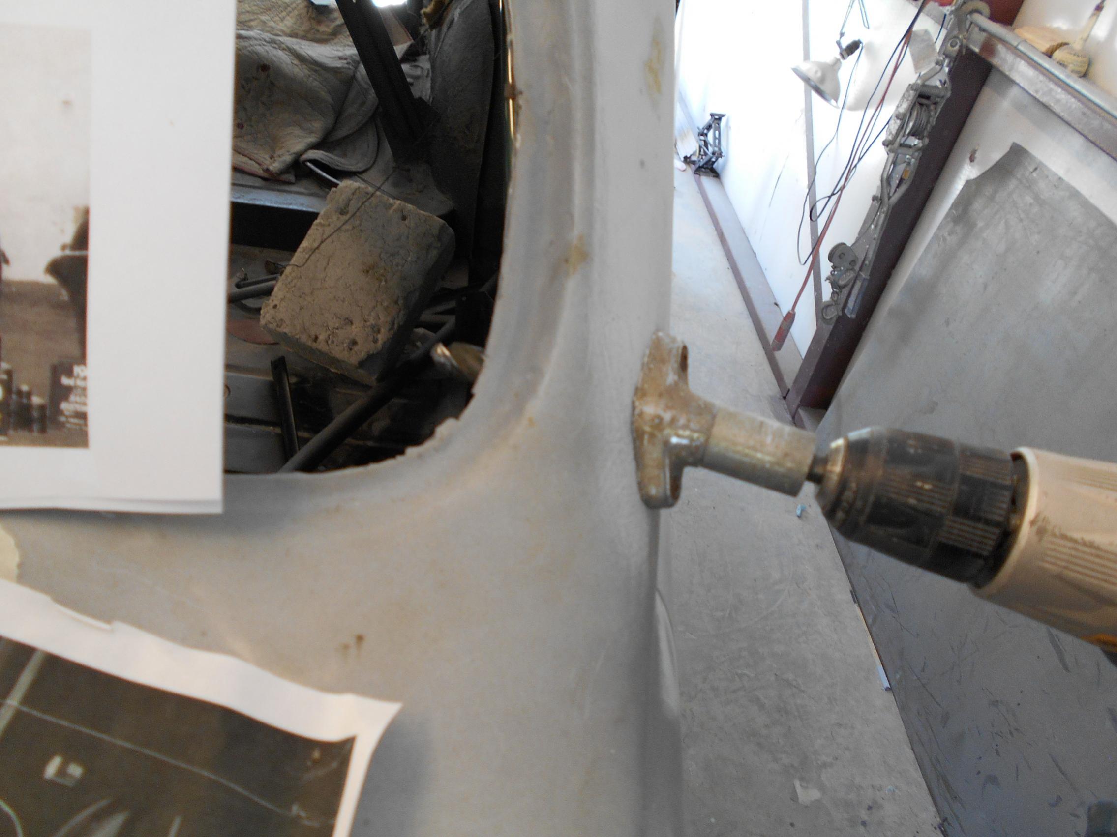

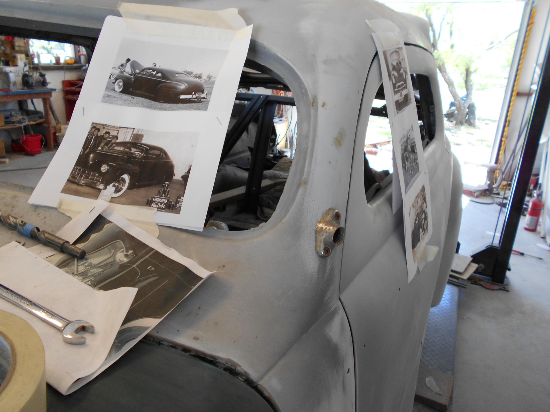

    It's time to get the appletons installed. I need to look at all the angles to get it right. The first step is to position and install the bracket after it's shaped to fit the A pillar.

    I have the factory pattern for where the Appleton goes Jer. And Im sure Jesse would have used a pattern if he bought a brand new spotlight light. Let me know if you need it!

    VERY important detail. The correct spotlight angle. Good luck! I'm sure you will get it right.

  23. jivin jer
    Joined: Sep 14, 2008
    Posts: 2,904
    jivin jer
    Occasionally I will skip over something and have to go back and pick it up. I appreciate your patience. So, while I appreciate your offer Kev, I can't take advantage of it.
    Here's the drilling in sequence.
  24. jivin jer
    Posts: 2,904
    jivin jer

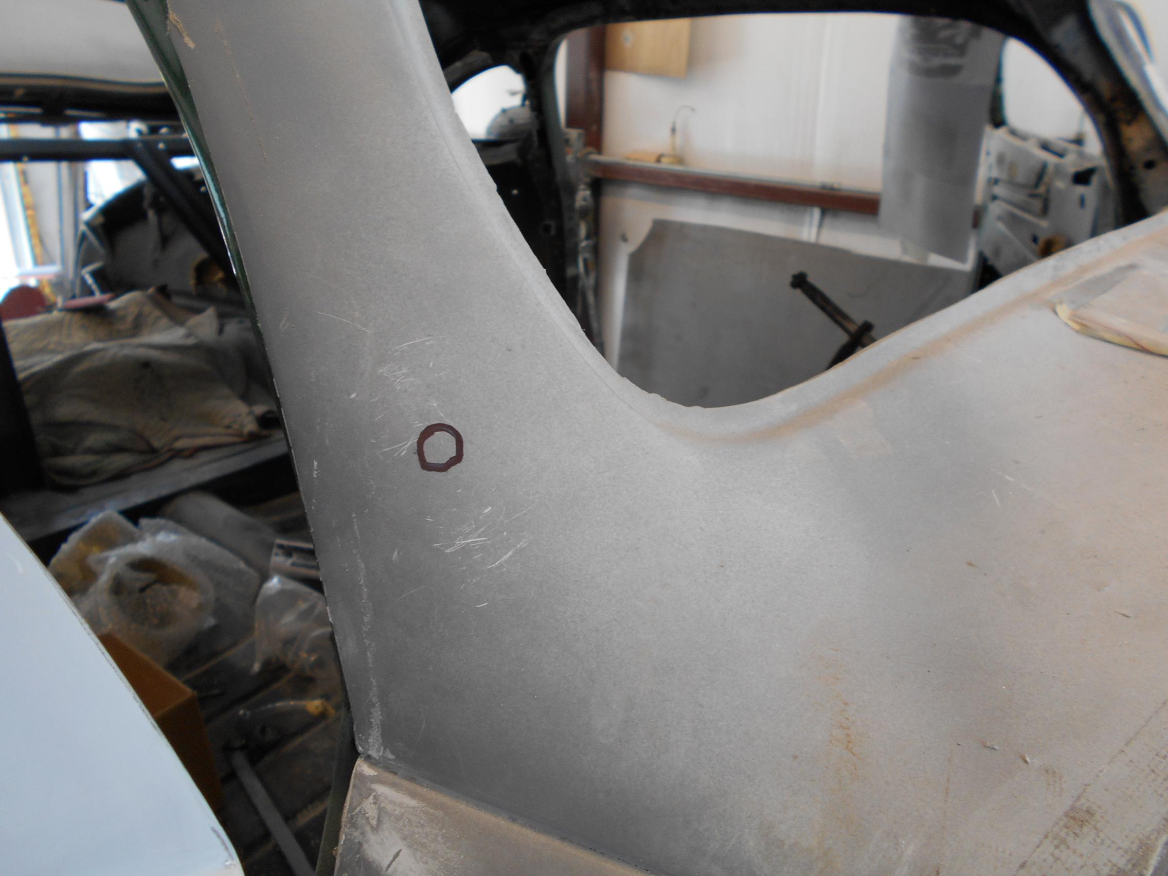

    Making a template to transfer location to R side A pillar.

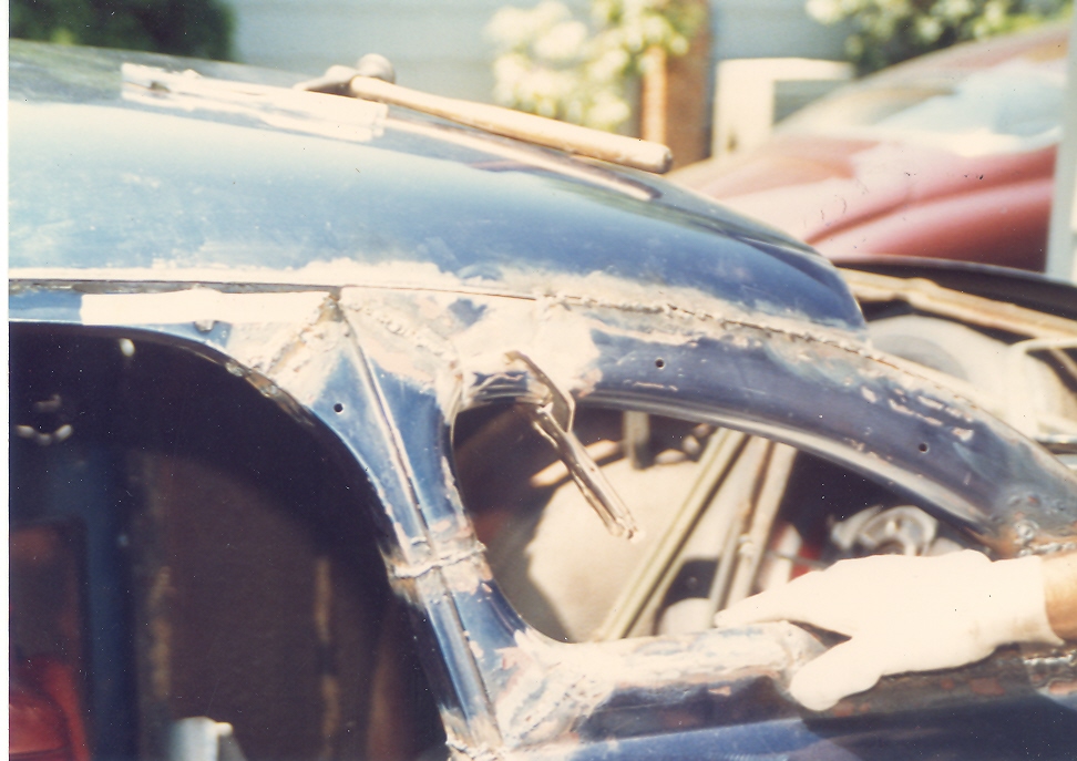

    One thing I love is old 40's style sleds, can't wait to see it done and it gives me inspiration to do 1 more in spite of being over the hill.
    Very nice craftsmenship. Wonderfull car, what can I say?
    BARRESSE':cool:
  30. barry mazza
    Joined: May 18, 2006
    Posts: 130
    barry mazza
    Photos did not make it!
