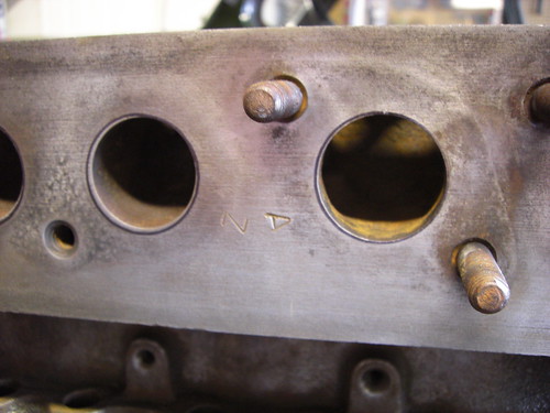

    Today, I took a stab at porting and here's what I did..
    Took the intake and exhaust manifold gaskets to mock up for port matching..
  28. =StreamlineDeco=
    Joined: Oct 21, 2006
    Posts: 177
    =StreamlineDeco=
    I wanted to taper-out to the inside line I marked. That way it would be a straight through chamber, passed the gasket and lining up with the intake and exhaust manifold, too.
    From the top, through the deck view, you can see where I started cleaning..
    kidcampbell71 likes this.
  29. =StreamlineDeco=
    Posts: 177
    =StreamlineDeco=
    Coming together. I'm trying to get it close to the edge and even all the way around.
    Close..
    Notice in the picture below, on the left-hand side, the Exhaust chamber. There is a rough cast spot that had to be smoothed out. These were almost in every chamber and I wanted to clean them up..
