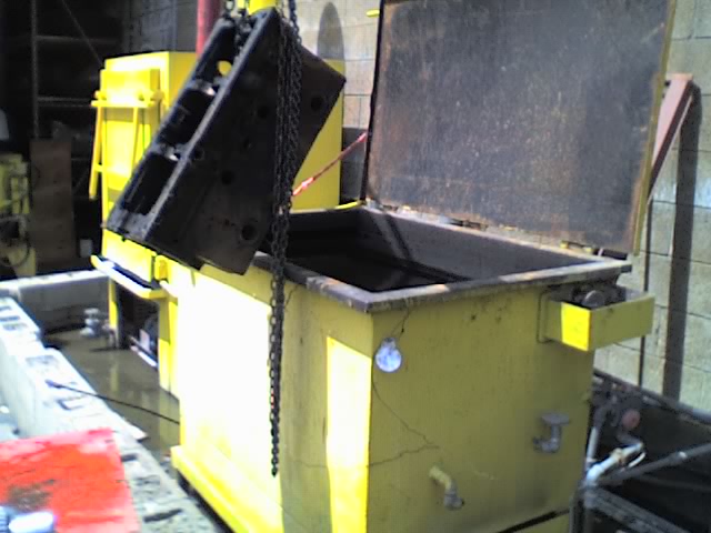

    The motor when I brought it in the shop..
    Taking everything off and prepping for hot tank...
    Time for a bath

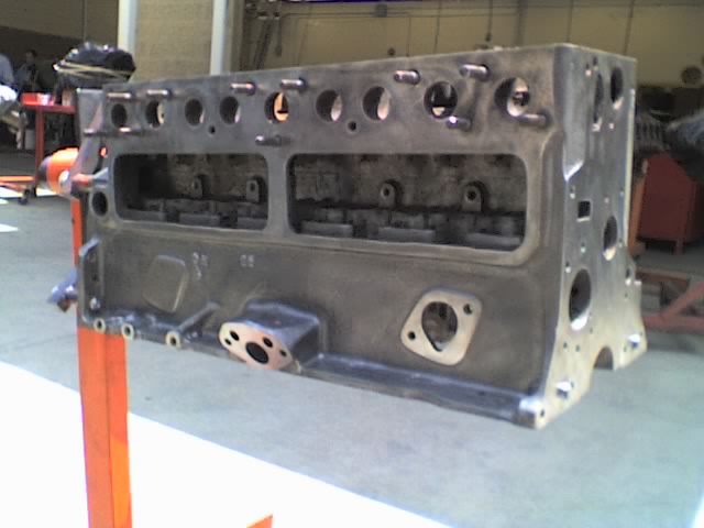

    After a little cleaning with a wire wheel this thing doesn't look too bad.
    I love the way it looks so mechanical. Maybe I can make the cracked block into an art piece. A coffee table stand perhaps :p

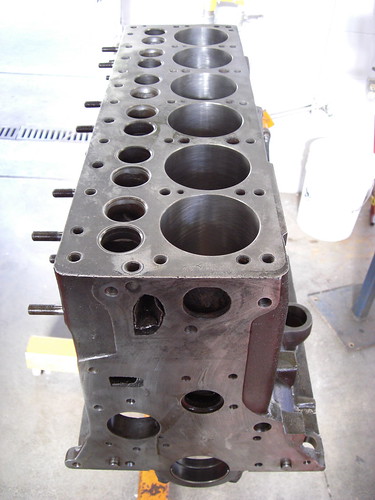

    Another thing that came to mind when I got ahold of this motor was the rebuilding itself. If it's not cracked, great. But, what if the motor's been too abused that I can't get a decent rebuild? I could sleeve it. That means $100 smackers to sleeve a-cylinder. Hmm...
    After cleaning I took all my measurements and compared them to the ones taken from an old repair manual on these little flatheads. Noticed there was some wear and figured i'd try and see if I could just bore it over to .020".

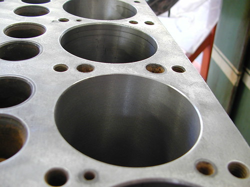

    Well, it didn't. And it ended up cleaning a little over .040". That meant that I had to go to the next nearest size they make: .060" over. Ok, no biggie. I found out that these engines came thick! They make .080" over pistons. And, at one time they made .100" pistons! That's insane. So I definitely have another rebuild in this block, that's for sure.
    Here's a shot of the first cylinder cleaned up..
    All done and got my chamfer on the edge to make piston installation easier. Those seats for the valves look terrible! I'll have to replace them. Oh, and the water distribution tube was a pain in the ass to get out! Had to soak the block upright, for a week, coming by to spray it with chemicals to break it free.

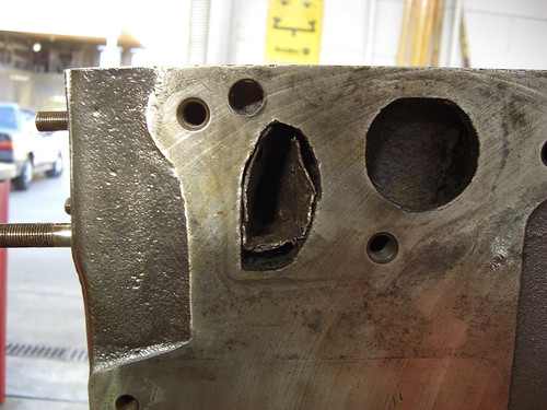

    Water Distribution=Rust

    Can you get a new water distribution tube? That's good. You may be able to gring the valve seats to clean up, it helps if you get slightly larger valves to movr the seat out to cleaner metal. Maybe DeSoto? How are the guides?

    RichFox, I did! I got mine through Andy Bernbaum. They've raised their prices since earlier this year, though. Not insanely but for there being few mopar suppliers out there I wont complain. Look out for more pictures on my seats install ;)

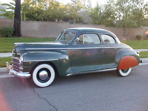

    Thanks Pal, you're right! When these little flatty's are tuned right they just go! Mine starts every time, bearly one rotation on the crank and it fires up.
    Here's my Plymouth currently. Little rusty and haven't finished the skirts but it'll do for the meantime..
