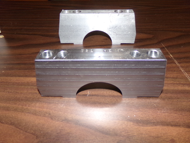

    Joined: Sep 27, 2006

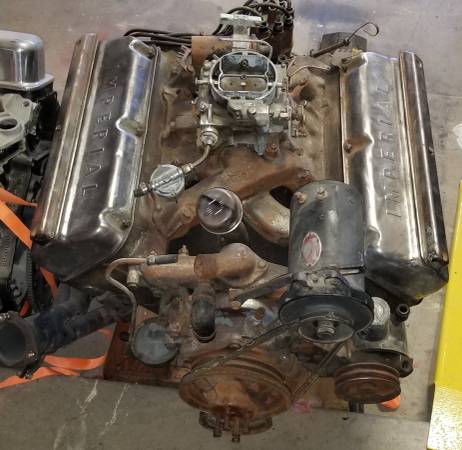

    This guy had this one in the swap meet in Bowling Green a couple of weeks ago.
    I don't know if it is something you are interested in. IMG_3706.JPG IMG_3705.JPG

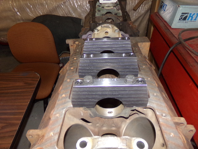

  22. It had aluminum caps on the middle three mains, was a spare race block, so I was told. I made steel caps out of 1018 and it was line bored by NVR racing. 100_0099.JPG 100_0098.JPG 100_0095.JPG

  23. It looks like there is another block in one of the pics. Is it another hemi. I would like to stay with a bloxk i can use the hot heads steel caps on.

  25. Yes, also 392 Hemi with Milodon 4 bolt caps. Sorta want that one for myself.
