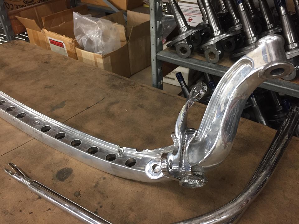

    Saw this little item Monday when hauling a friends new chassis. That thing took a hit! I put one of these under my '32 after seeing yours.
    SPark
  20. Cool. That's why they wanted it back so bad. To use as a testimonial. Pete and jakes are good people.
