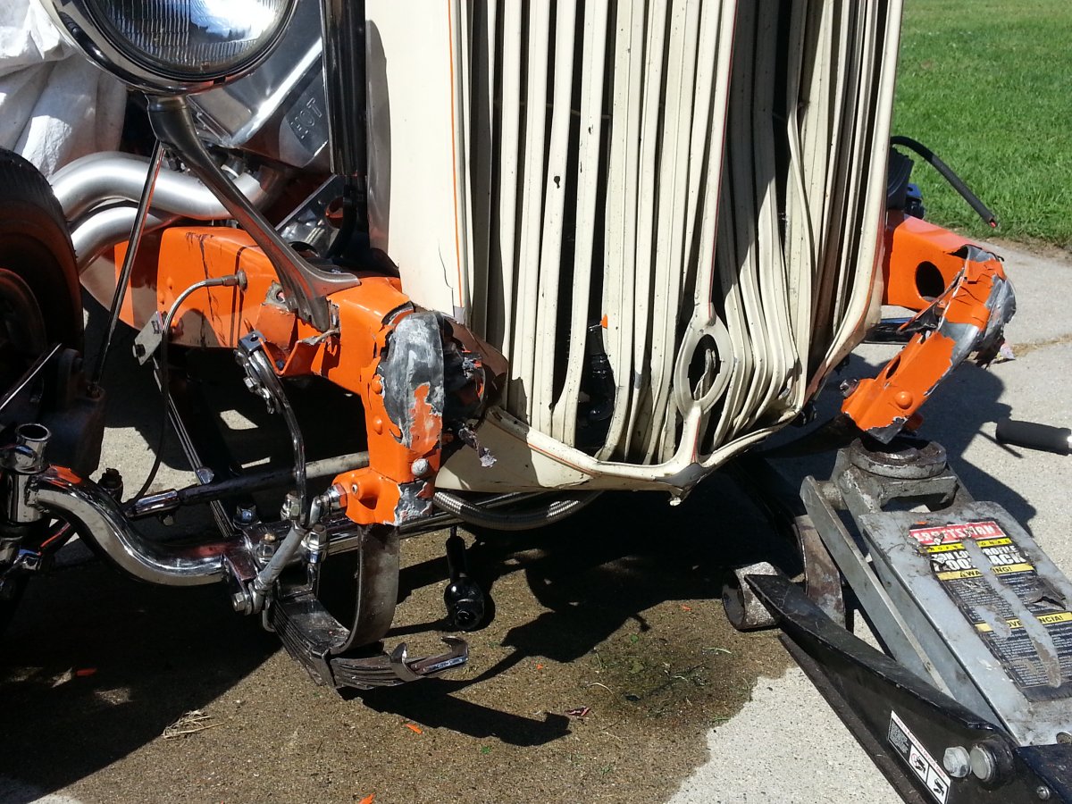

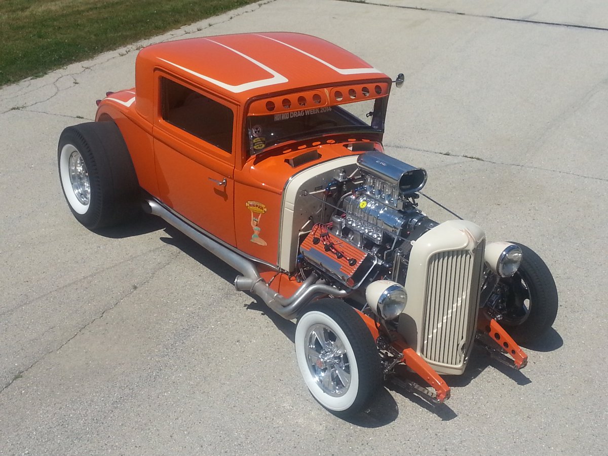

  1. 20150803_134202.jpg 20150803_134202.jpg On august 18th my 1931 coupe was severely damage in a accident. The best that we can determine is a brake line broke on the left front wheel. The car slid into a concrete barrier. The impact was enough to rip the king pin boss from the axle. The right side king pin sheared into three pieces knocking that wheel off also. The engine moved forward several inches in the chassis. The body bolts on most of the car were sheared off. The good news is i survived although banged up good with a severe concussion. Follow along as we rebuild the car. this pic was taken just days before the crash 20150803_134202.jpg

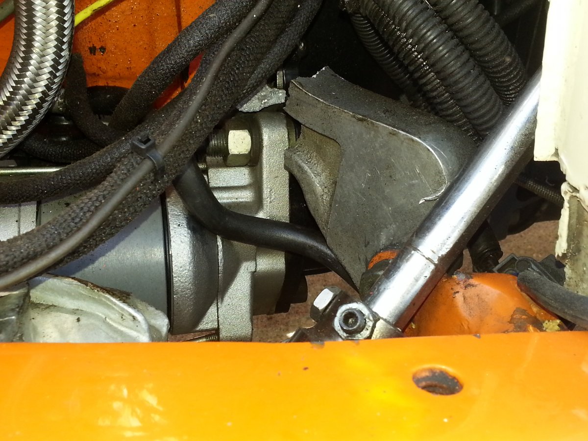

  2. Sorry for the extra pics im new to posting pics. Here are a few crash pics so you can see what i have to start with. 20150813_160640.jpg

    Not to be morbid, but, can you post pics as you assess the damage, frame, suspension etc.

  7. As you can see the frame is junk. The midplate is broken into three pieces and the motor mounts are bent beyond repair. The rebuild will include travel limiters. They prevent movement of the drive train. If i would have hit the wall backwards the engine would have been in my lap. Safety will be a huge concern with the rebuild.

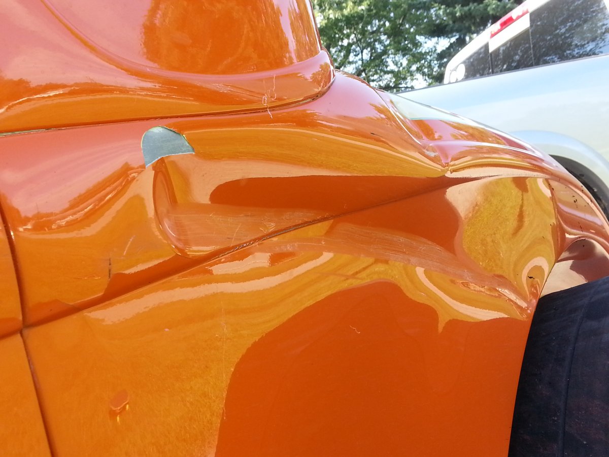

  13. 20150813_161132.jpg When the drivers side wheel came off it hit behind the door. It should buff out. Lol

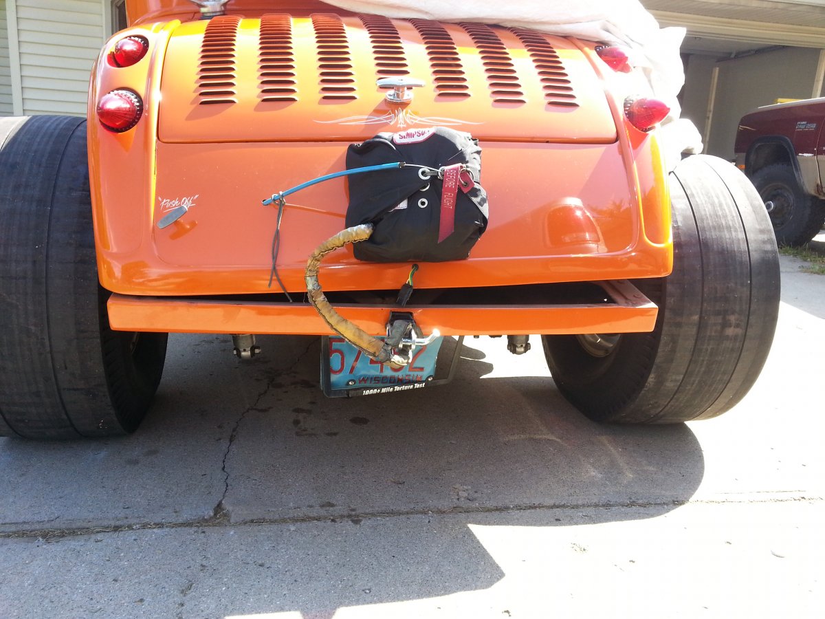

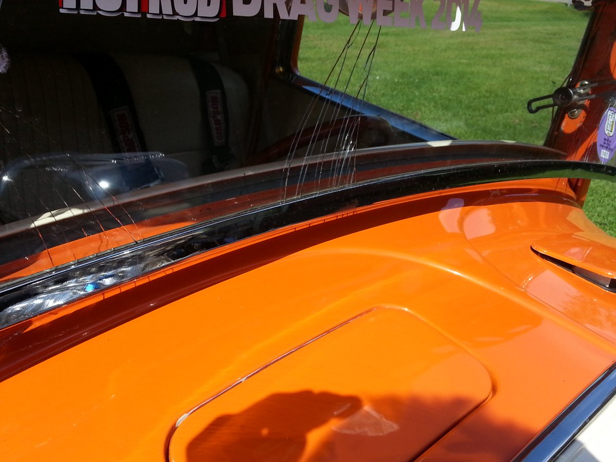

  15. 20150813_160942.jpg Both the front and rear window broke. It pisses me off the it took out my drag week stickers. Luckily i was able to get a replacement for it last week during this years drag week. I took my chevelle on it. plan b

    That must have been a hell of a hit to break the midplate like that, looks like the engine damn near came out of the car. You are lucky to have come out as you did. I'm guessing the makeover is going to involve cage uppers forward of the firewall and 4 corner mounts on the new mid-plate?

  18. 20150813_160745.jpg The frame has a twist to it. The body survived quit well. The drive train suffered a bent lower blower pulley. The grille and oil cooler are junk. The plan is to go with a double round tube frame. Like a lohge funny car. I want it to certify to 7.5 because thats were we are headed. A straight axle is going up front. It will have a torsion bar front suspension like a dirt car. We are going with spindle mount wheels. I was able to purchase the american five spoke magnesium wheels off the 69 hawiian mini charger. I also bought some bear claws for the rear. You can see now where this is going.
