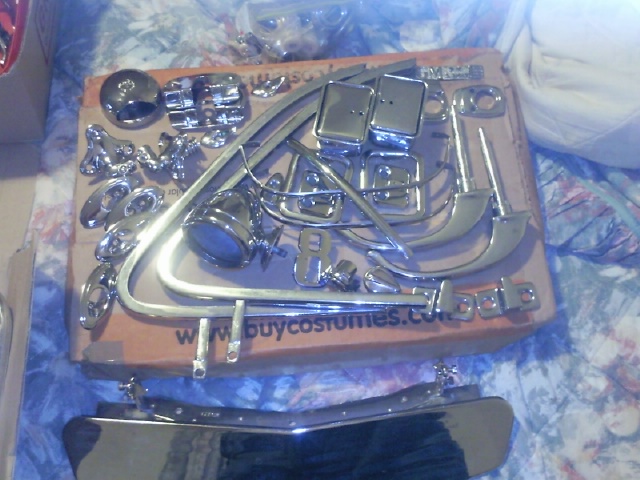

  12. mgtstumpy
    Joined: Jul 20, 2006
    Posts: 9,214
    mgtstumpy
    Frames are S/S. Rivets are available. As Squirrel stated, buy the rubbers etc and then tackle things. The doors will need to be disassembled. There are some HAMBers (Owens Salvage) that could assist with locating parts. I presume it is for your Fleetline in your avatar?
    If so, here's the Shop Manual. Just go to the relevant section and it will explain the process step by step.
    You may need to silver solder a bracket if it rattled loose and then polish.
    I've yet to reassemble mine since they were rechromed.
