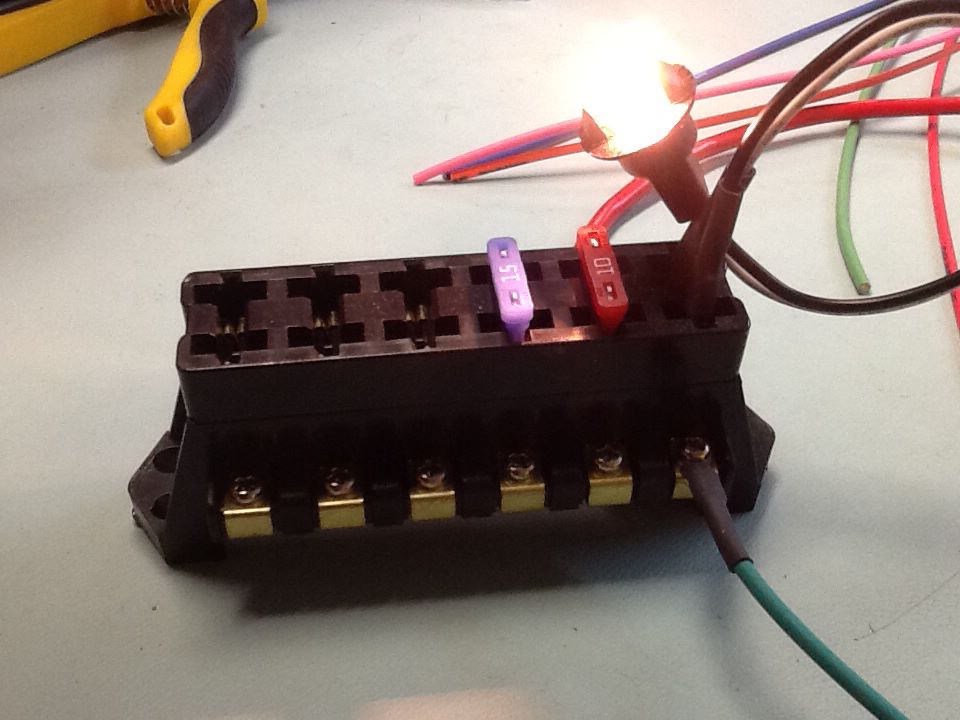

    Got a couple minutes between harness builds. Here's some easy tips for finding shorts to ground (that keep popping expensive fuses). Instead of using a fuse, use a simple 2 wire light bulb with some spade terminals, to plug into the fuse slot in place of the fuse. With one side hot, and the other side shorted to ground, instead of blowing a fuse you'll just light the bulb.
    Whatever the fuse is for (lights, turn signals, gauges, etc) you know the area your short is in. You can start disconnecting wires, pulling bulbs out of sockets, etc until the bulb goes out. When it does you know you found your short.
    I've got a bulb with about 12ft leads on it that I made to do this (and check for parasitic draws) that I can move around the car with me and watch the bulb. Hope this helps someone out.
