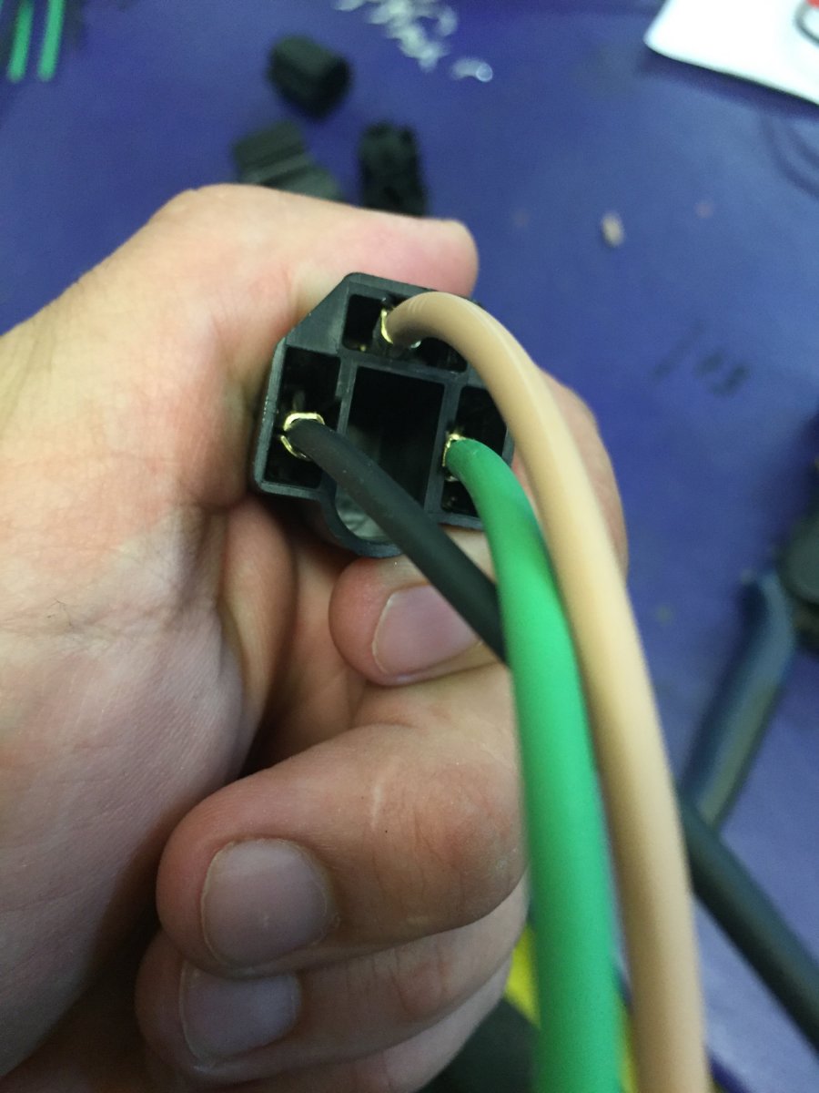

    The headlight ground would be the first place I'd look. Just had a Shoebox Ford doing that, and it was a loose ground wire. Unless the bulbs are higher wattage, the fuse should be fine. Other than that, check the headlight bulb wiring and make sure that from the back of the bulb, where the wires go in, the ground is on the left, low beam at top, and high beam on the right (so that they're not wired differently from one another)
    If you're using higher wattage headlights, you can relay it. You'd want to power the relays (one for high, and one for low usually) off of the battery, with an inline fuse (circuit breaker is better) and trigger the relays off of your dimmer switch.
    If they're stock bulbs though, I'm betting it's a ground or crosswired at the bulbs. Let me know what you find.
