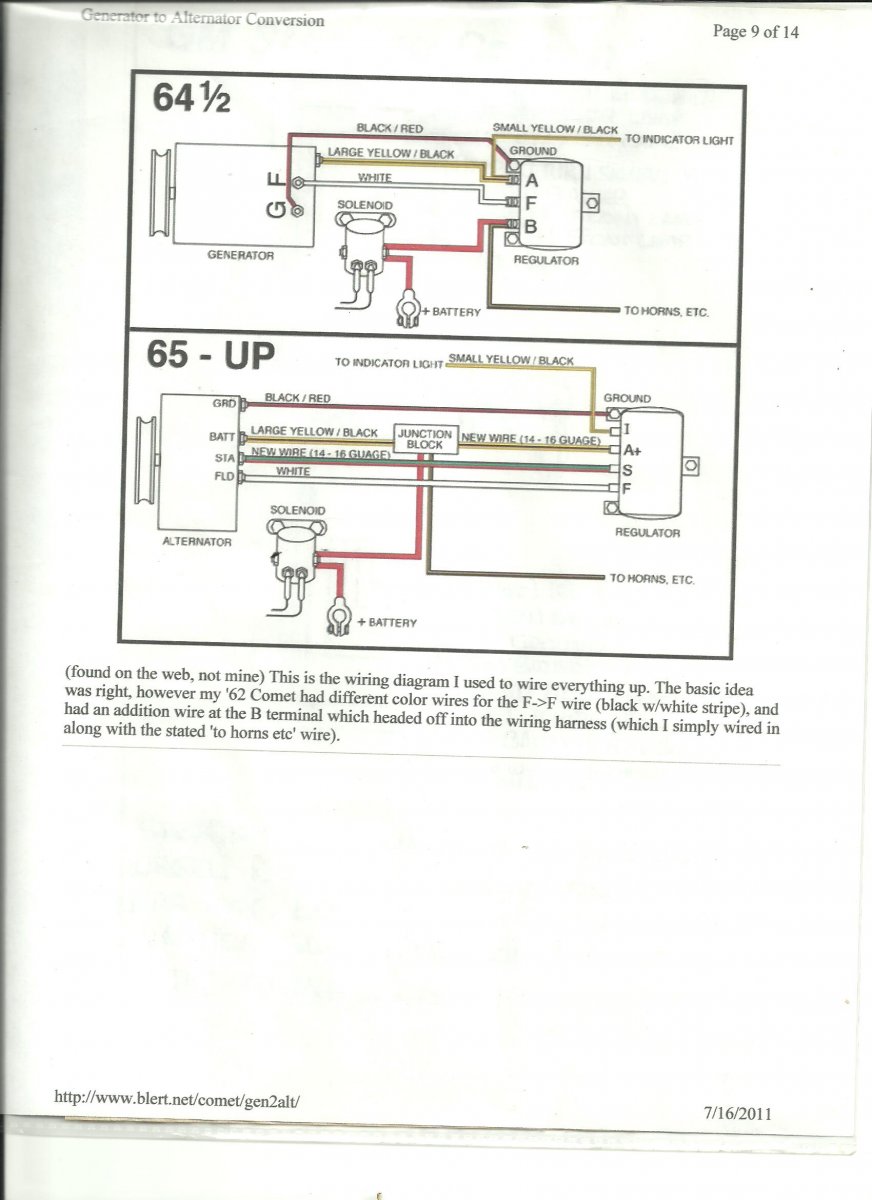

    This should work for it, just the bottom alternator diagram. This one is also in the instruction manual, showing an indicator light. The indicator bulb goes inline in the white exciter wire and then runs out to the I post of the regulator. It's also easier to junction the power wire at the battery post of the alternator, so you can run a wire from the regulator to the alternator, then with a ring terminal bring the charge wire from the alternator battery post over to the battery side of the solenoid. Don't worry about the "horn" wiring note. We've got it covered in the kit.
    So you'll just make up a couple short pieces of wire to run from the regulator to the alternator. S to stator, F to field, A to battery on the alternator and Battery power on the solenoid, and ground both alternator and regulator. Or check out that little regulator that bolts on the alternator I posted earlier and do away with the regulator wiring.

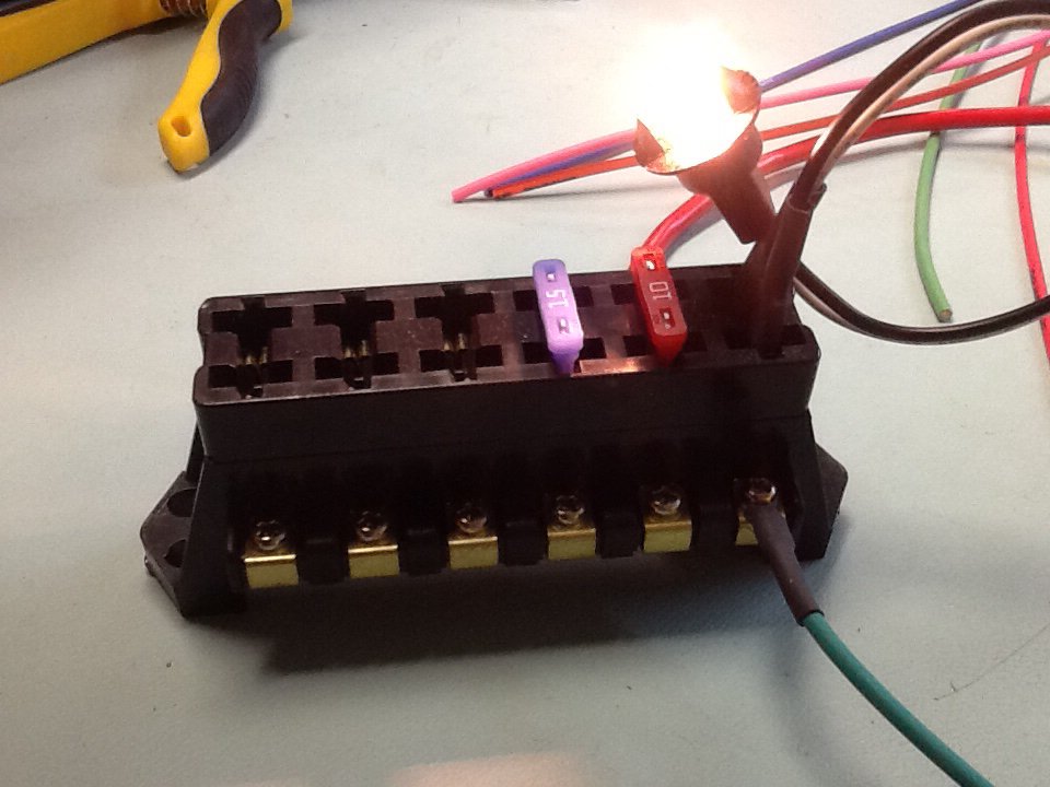

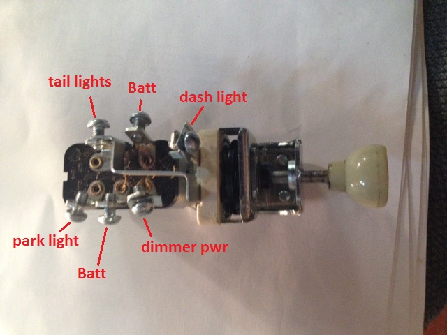

    Had a few headlight switch, blown fuse questions lately and thought I'd post a little on that. Both actually on Shoebox Fords, so let's start with a diagram
    So let's say you pull on your switch and you pop a fuse. The first thing I would check is "are you blowing the fuse on the first click of the switch or second?" This would point to either a running/dash light issue, or a headlight issue. To save fuses, you could always put a test light or other 2 wire bulb in place of the blown fuse and just start pulling bulbs, then disconnecting wires until the test light went out. When it goes out, you know you've found your short to ground.
    Bulb in place of fuse, showing hot on one side and grounded on the other side (bulb lights up)
    When you find the short and disconnect it, the bulb will go out. Saves a lot of money on fuses, and you can just throw that bulb in your toolbox for next time. Keep in mind that bulbs can fool you, because you can get a reading to ground through the bulb filament, and it not actually be a problem. So if you pull all the bulbs and still have a short, go back and check the sockets. I have seen new sockets with little pieces of metal down inside them, creating a short, so sometimes it pays to check your sockets, new or not.

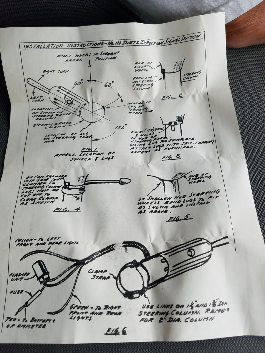

  14. Hope you can help me. Just picked up this NOS 1957 Dietz 12v turn signal switch. Directions are at bottom left.
    I have your 9+3 rear mount panel.
    How would I hook it up and still have brake lights? Now I have both brake lights fed together from the brake switch. Also, do I Just do away with the flasher and inline fuse?

  16. This type switch isn't set up for brake lights. The only way to make this work will be with a 'trailer convertor' installed for the rear lights.

    Crazy Steve is right, If you want to use dual filament bulbs in the rear, like 1157's you'll need to put a trailer light converter box inline in the rear turn/brake wires (the rear turn wires act as brake and turn) and something has to sort that out. Usually the turn signal switch, converter box in this case
    Something like this:
    You have a couple options on your flasher. The flasher that came with it is probably a 3 pin flasher, with terminals X (power in) L (load out to turn signals) and P (output for pilot or indicator light). If you want to use the indicators in the body of the switch, the 3 terminal flasher would work best, since it has the extra P terminal for that. You would just need to decide if you want to wire it as a keyed hot or constant. I'd probably go with keyed hot, since it looks like that switch doesn't have a hazard button. Then just use one of the extra keyed hots in the fuse panel to power the flasher X terminal or red wire that says to ammeter.
    If you do decide to use the 2 pin flasher in the harness, this is how it would work. If you're running dash indicator lights, just don't use the P wire coming off of the switch. The indicators in the switch wouldn't come on at all.
    If you want to use the indicators in the switch, you would tie the P and L wires together and connect them both to our purple turn flasher wire (keyed hot). The only drawback to doing that is the indicator light in the body of the switch may glow faintly when the key is on, then blink like normal when you use the turn signals. You would't use the brown hazard wire in the kit at all, just pull the flasher, or insulate the end of the wire.
    Then the switch part is wired, and just wire in the converter box inline in the 2 rear turn wires (yellow and green on the harness) and take the brake light wire into the box. So you'll have left rear, right rear, and brake lights coming into the box, and only left and right rear leaving the box going back to the rear lights. Some boxes will include tail lights, but you don't need that. The tail light wire can just run straight back to the tail lights, bypassing the converter box. All we're sorting is brake/turn.
    When you get back to the rear bulb wiring, all you need to know is which wire coming off of your bulb is tail, and which is turn. If you need to, bench test the bulb with a battery to find out.
    Your dim light will always be the running light (tail or park) and your bright light will always be the turn signal. If you're using LED's remember that they're polarity sensitive, meaning the ground has to be ground and the hot has to be hot. I've also seen some aftermarket assemblies that on one side: red might be turn, and black tail lights, on the other side it was black is turn and red is tail lights. So it pays to bench test before you make connections.
    I know this has been a long response, but I figured I'd cover some options in case other guys were doing it too.
