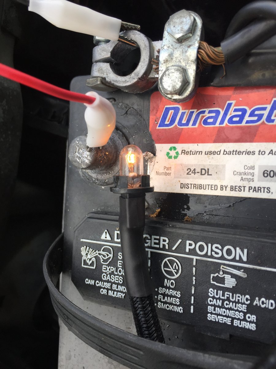

    Here’s a picture before and after finding my draw. The test light just goes inline in one of the cables, with the other cable still connected. Here’s the test light showing a draw. This was with all switches off, doors closed, nothing was turned on. If you turn something on, the bulb will get even brighter
    The light is just inline in the negative cable, between the post and the cable. The positive is still connected to the battery like normal.

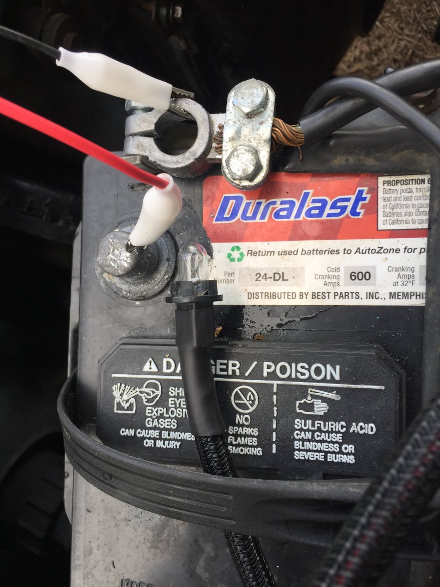

    Here is the test light after I found the draw and pulled the fuse for that circuit. Interior lights in my case.
    So I’ve narrowed down my parasitic draw. Somewhere in the interior light circuit. Now to dig deeper, but for now I can just leave the fuse out instead of disconnecting the battery if it’s going to be sitting for a couple days

    If I understand this correctly doing this you just pull fuses until the light goes out? At which point you know the short is in that circuit and you can start checking items in that circuit? Sounds simple enough for a non electrical guy.

    What Gordon C said, lol. So once the circuit is identified you either start tracing the actual wiring or anything that might share a circuit. By the way the pictures were very helpful. Reading what you said while seeing it made all the difference.

    That’s it. If you pull them all and it doesn’t go out, it would be something directly on the battery, like a bad diode or something in the alternator, or some relay wiring that may have been added in later. Had that happen a few times too. So in that case after checking the fuses, I would start disconnecting the alternator wiring or pulling relays. Just keep in mind it’s all still hot so don’t let anything touch ground (alternator case, engine block, frame rails...) Doing it like this lets you rule out a lot of wiring

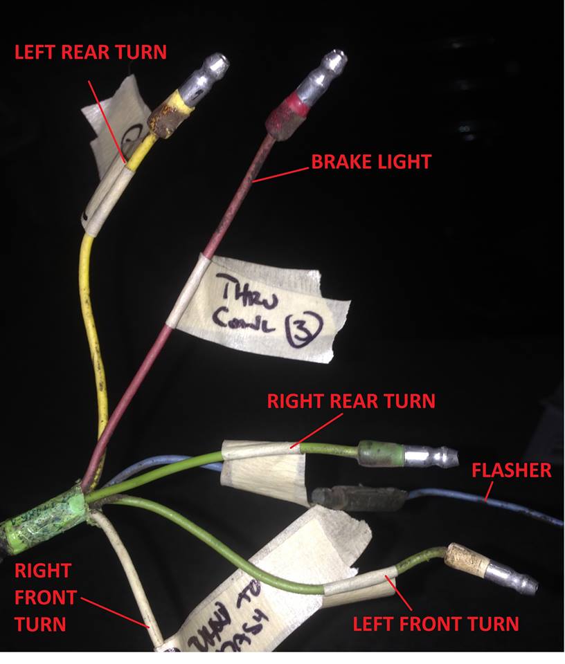

  7. I have a turn signal switch out of a 1960 F-350. Six wires. I ran a continuity test using a multimeter. No two wires have continuity to begin with. With the left turn signal switched on, I have continuity between the red and one of the two green wires. With the right turn signal switched on, I have continuity between the red and yellow wires. That makes me think that red is hot, one green is left, and yellow is right.
    I have another green, a blue and a white wire whose function is unidentified. With the blue and other green connected and one multimeter lead on red (power), the other on either the left (other green) or right (yellow), I have continuity. Same thing happens with the blue and white wires - when I connect hot with a either left (other green) or right (yellow).
    I'm guessing that the other green, the white and the blue all go to a flasher, which controls only the turn signals.
    It seems logical to me that the F-350 turn signal switch controls only the turn signal lights - no brake lights, as that would be controlled through the brake light switch that is tapped into the brake line - and that only one wire from the turn signal switch is tapped into the front and back turn signal lights for each respective side (one green for left, yellow for right).
    So which of the three flasher wires goes to which flasher terminal?
  8. ^^^^
    That F-350 signal switch would have the brake lights incorporated in the circuit. The six wires would be left rear, right rear, left front, right front, flasher in, and brake lights in.
    If there are not three wires in continuity when the switch is in the off position, it would indicate the switch is defective.
  9. Yep, what Rich said. A six wire switch includes the brake lights, a turn-only switch only has five wires. Bad switch....

    The 60 switch would have a brake wire on the turn signal switch like the other guys are saying.Try this out. This is from a 1956 and seems to match your colors. Continuity can be tricky sometimes, especially with an older switch that may have sat unused for a long time. Sometimes after working the switch back and forth, things can change. The only one that goes to the flasher is the blue wire (which Ford stuck with that color for a while) and it would go to the L (load) terminal of a flasher. That other green wire is hard to see, tracer is usually gone, but it's actually green/white and also notice the factory terminal is white, and a green terminal on the other green wire. So the right rear turn is solid green and the left front is a green/white. Hope this helps out.

  16. Thanks to all three of you for guiding me toward understanding this turn signal and what I should be detecting. I'll clean up the switch with some electrical spray cleaner and see if it restores the continuity and makes this salvageable. It's only sat idle since the early seventies. Some TLC might just bring it around.

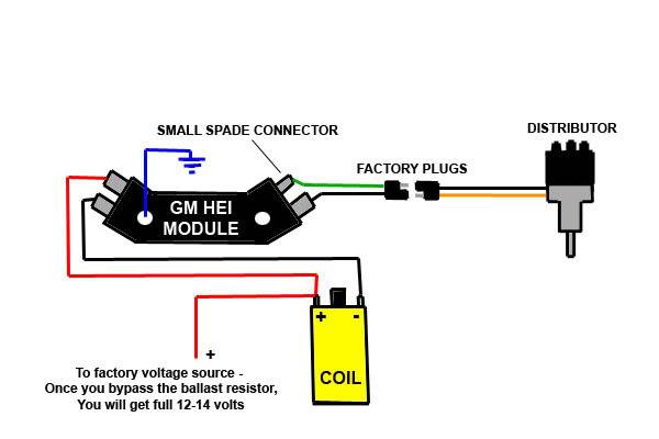

    So while working on a project, a Mopar 318 engine, I wanted to clean up the ignition wiring. I didn't want to use the old ignition box (for cost of parts, size, looks, etc) nothing wrong with it, I'm just trying to clean up the old wiring. So I went from idea to idea, GM module mounted somewhere, and the old electronic distributor, and decided to just go with a ready to run distributor for price and simplicity. While posting some tech about it, someone asked me if it could be used on a Ford. Never thought of it, but why not? Do away with the old Duraspark box and use the same smaller module. Also found some guys using the later model Ford TFI module and the stock aluminum heat sink mounted somewhere. You can still pick up a small ready to run distributor, but the GM module would work with the stock setup, especially if you had a 302 HO or something that needed the bronze distributor gear. So here's some of the wiring ideas that came out of it.
    This came from a HAMB thread a couple years ago, from a Mr. Rusty O'Toole
    I still wonder if you could gut the distributor housing and just drop in a pertronix setup? Someone with more knowledge on this chime in! I'm just messing around with ideas here.

    Great, thanks! The Pertronix setup normally just goes to positive and negative on the coil, with our pink coil wire also to the positive. Keep in mind whether or not you need a resistor depends on your coil. The Ididit column should match up to the wire colors in the kit (purple, green, white, yellow...). About what year on the Ford alternator, older setup with external regulator? I'll post a diagram for it.

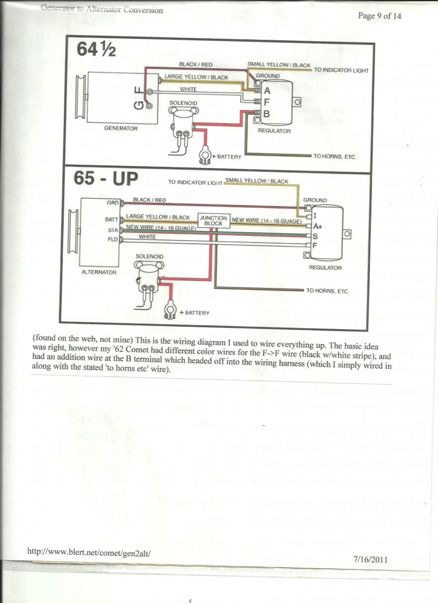

    Oh, yeah... Here's the Ford Alternator wiring diagram. Along with a Ford generator diagram generator 3 post regulator diagram 001.jpg

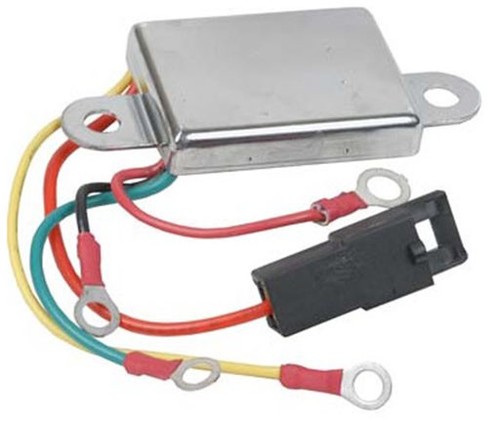

    I've also seen a small box now that you can mount on the back of the old Ford alternator, and you run the ground, field, and stator wiring to it. Basically moving the regulator right to the back of the alternator. Not really a one wire, but close, and still keeping the stock amperage
