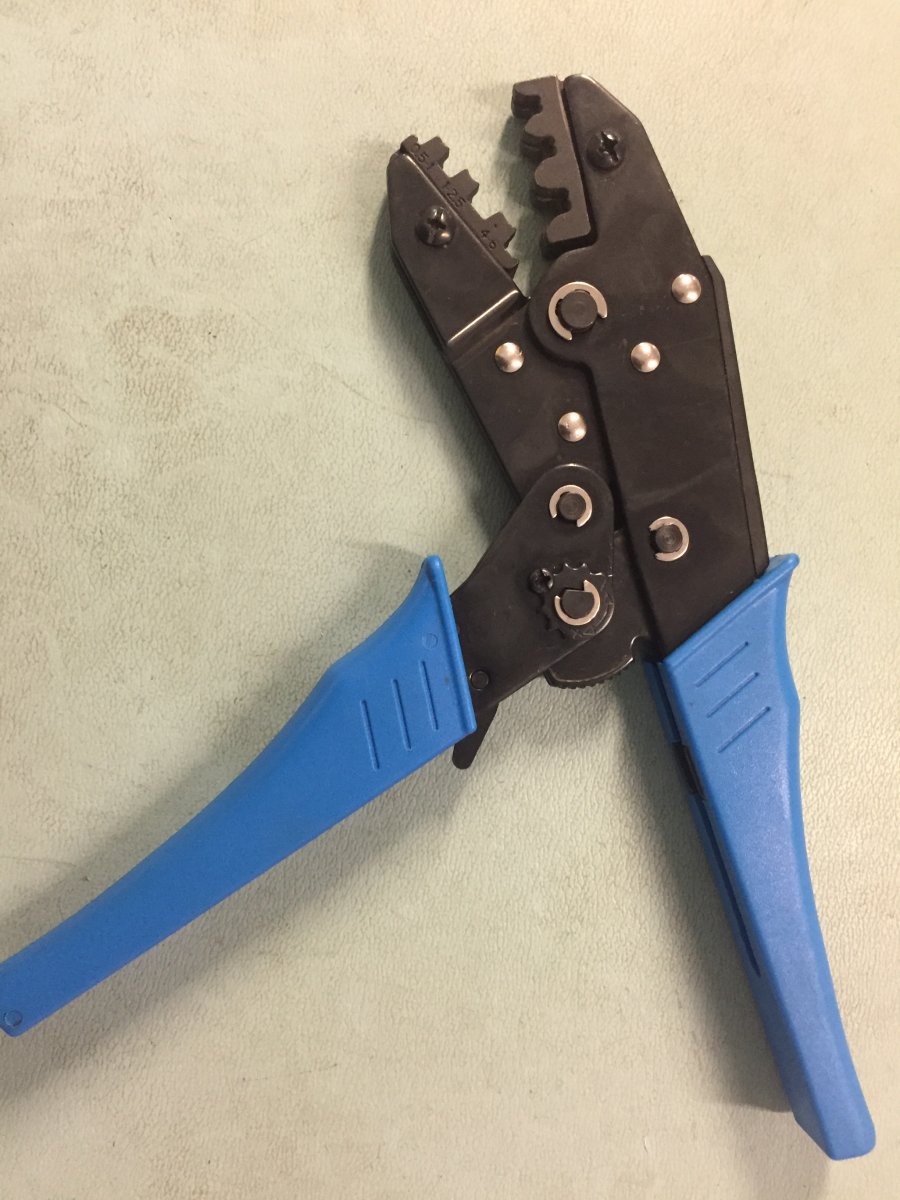

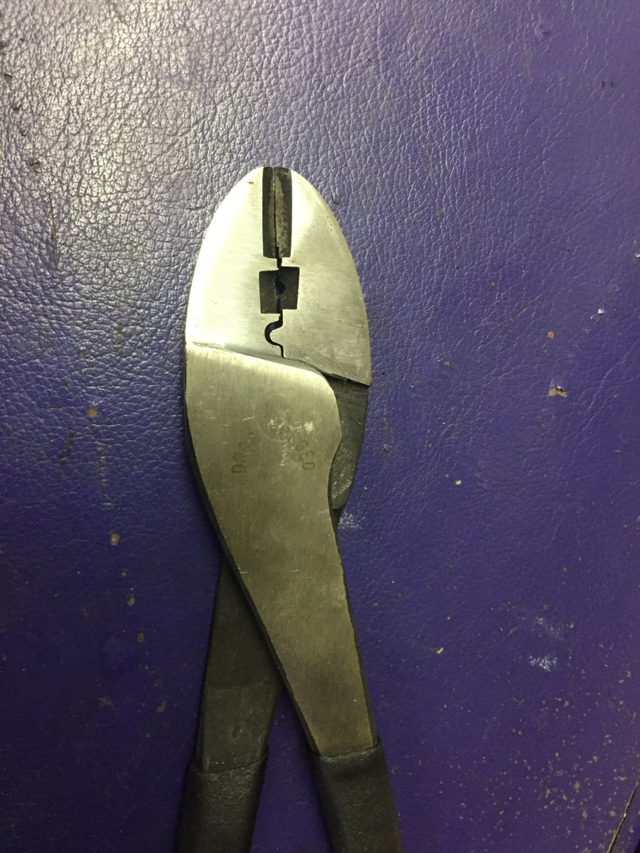

    Could you post up a picture or two of the crimper and crimper die(s) you use to make the two part crimp on those terminals? My preference also is to both solder and crimp when feasible. (Although occasionally I have been guilty of crimping, but not soldering.)

    Here’s just a basic set of crimpers for uninsulated terminals, like for a brazed parallel splice terminal. I use those, then heat shrink on a lot of connections
    Then on terminals requiring a crimp around the insulation and the copper, you can use something like this. This is just a cheaper set, around $15-20 on eBay. You don’t have to break the bank on some tools, especially if you’re not doing this all the time
    They are adjustable and ratchet to make sure you get a good crimp.They also have removable dies if you ever need to change them. I know there are other ways of doing it and more expensive tools out there, but these work for most terminals that you’ll use on an average wiring job. I’m sure we’ll get some advice from the other guys on here that do a lot of wiring. This is just a suggestion
