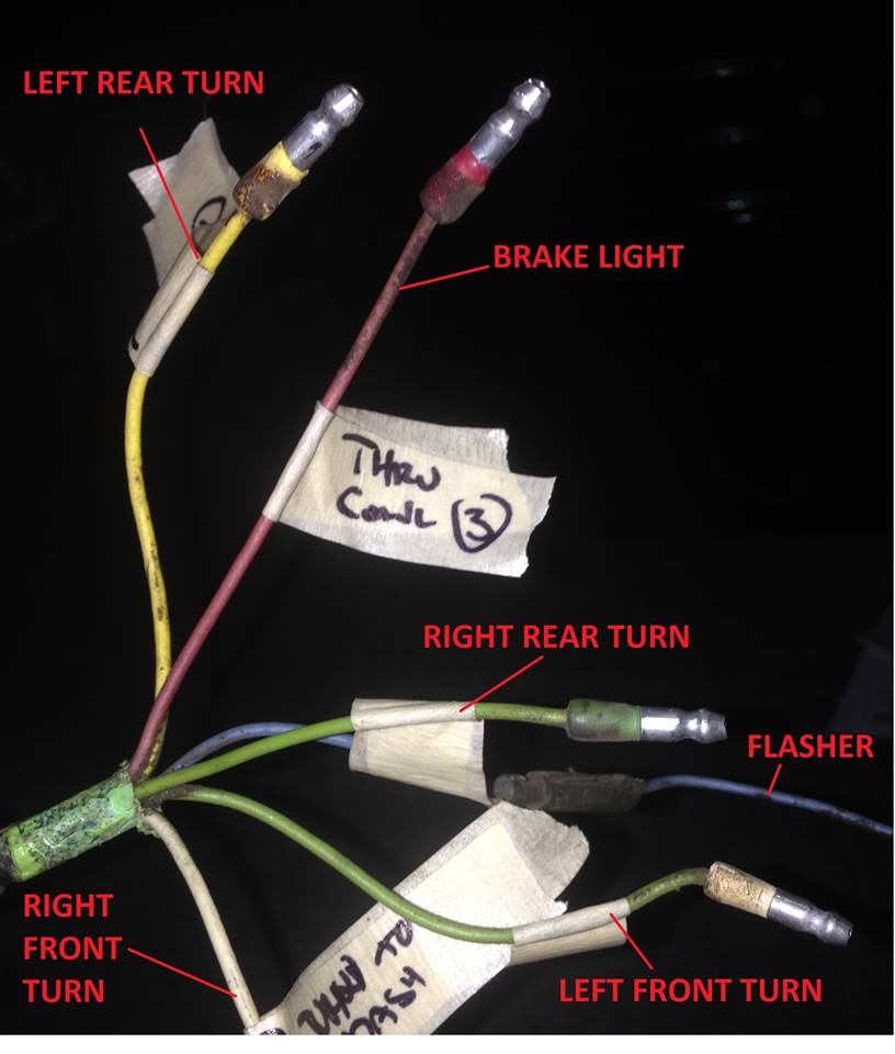

    While we're on Ford Column wiring, here's some for you guys. I believe this was on a 56 Ford. I think we worked it out with a meter because some tracers were gone. I told you I was a Ford guy at heart 56 ford turn signals.jpg
