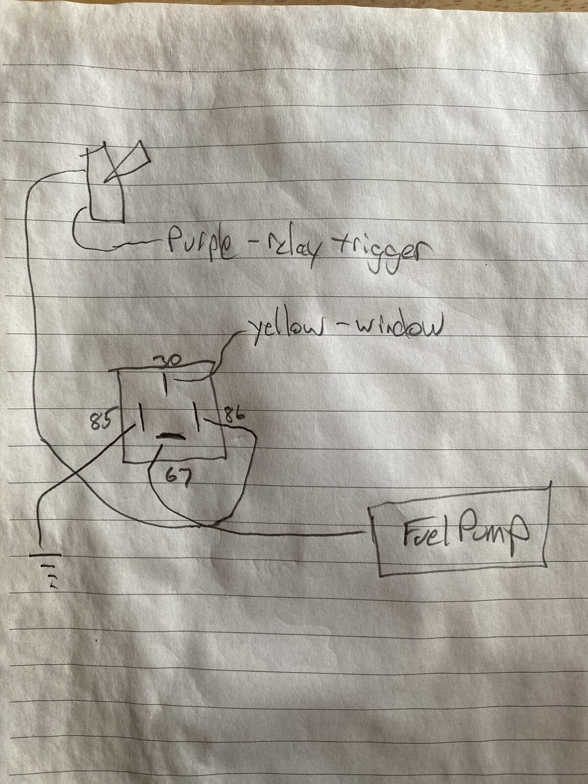

  9. I have a fuel pump question. My electric fuel pump is turning off when the car is cranking therefore not starting. I’m using the purple relay switch wire to an on/off toggle switch then the yellow window power wire to the relay. I’m going to try and show a pic here. Is there a different wire I should be using in either place of the purple or orange?
  10. Why is the toggle switch powered by the ignition switch?

    Sounds like you have a 14 circuit, probably from Southern Rods...but if I'm wrong let me know which harness you have. In the 14 circuit harness the purple relay trigger comes off the accessory bus bar and most ignition switches drop off power to the accessory circuit when cranking. The wire is more meant for a fan relay and wouldn't matter if it went dead. If you want to use the purple relay trigger through the toggle switch as an override you could cut it and feed the toggle directly off the ignition switch run terminal. It wouldn't need to even be fused since it's just a trigger wire and only pulling about a 1/4 amp or so.
    You could also use the power window wire to feed 30 and 86 on the relay, keep 87 as power out to the pump...and use the toggle switch to switch the ground to 85 (ground in and ground out of the toggle switch) even still using the purple relay trigger as just a piece of wire to reach from the switch to the relay, just ground the other side of the switch instead of a hot.
    Let me know if you need any help with it.

    I'm guessing it's a 14 circuit kit and really the accessory side of the ignition switch feeds the row of fuses that has the relay trigger on it, and the switch is dropping off power when cranking. I was thinking it might be a 21 circuit kit, but the 21 has a fuel pump wire in it (hot in run and start).

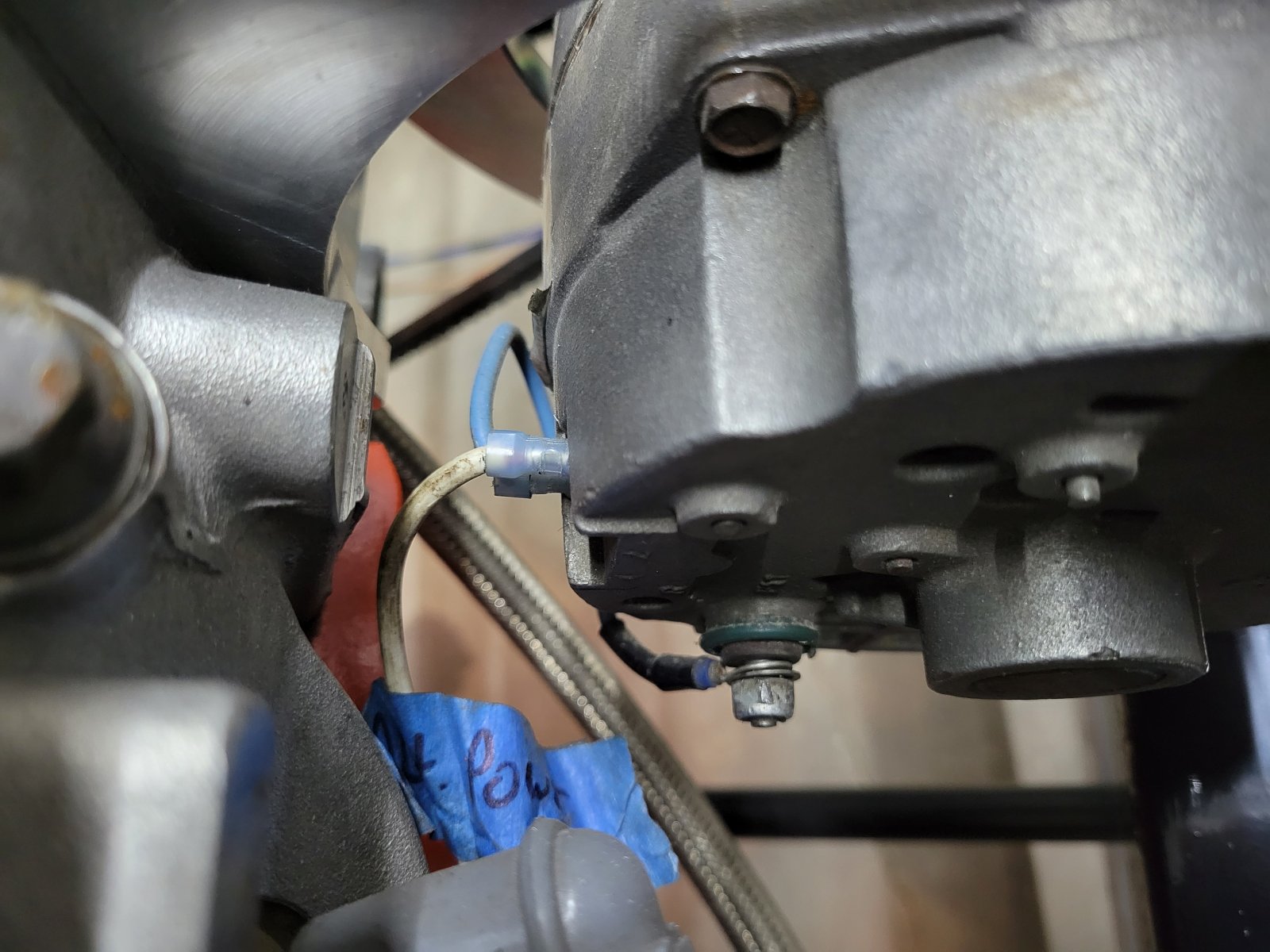

  13. I've got a 9+3 fuse panel GM based wiring, I tore the car apart a few years back, labeled most of the wires but I'm at a loss on the alternator.
    I've got a late style alternator used the jumper from the one spade back to charging post, white exciter wire plugged into the other spade.
    Does anything else go to the charging post ?
    I have a wire coming off of my starter bundle with a large eyelet that fits the power stud on starter that wire has a smaller eyelet on the other end of it that looks like it might fit that charging post.
    Algoma56 likes this.
  14. Algoma56, RICH B and pprather like this.
  15. You probably used the starter as a junction point. The 10si alternator you have is the way to go, just use a charge light (have them on every car that didn't have a warning light).

  16. I got a hold of them and they confirmed to wire from starter to alternator, funny I had brought all the wiring inside the car while I made a new firewall, that wire was labeled battery on the alternator end.
    I never had an idiot light on this car, it all worked, most of my labeling has soaked into the tape and is not legible any longer, so it's kind of like starting over lol
