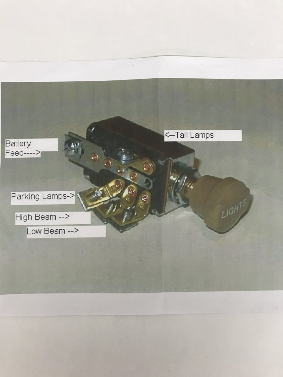

    Here is a pic I found on the internet of the switch like mine. The contacts on the right that have the bar connecting them feed the instrument panel toggle and originally powered the brake light switch (now powered by your fuse block). The two on the left are park and headlights.

  12. Maybe your switch is different; but here is how the ones like that I have used were wired. The fuse protected both the headlights and brake lights; but in your case you do not need it since your brake lights are powered out of the harness. That side terminal is not a ground.

    I think Rich B is right, that brake light terminal would be a constant hot, since it comes off that brass strip that runs off the battery terminal. The others can easily be moved around if needed. Honestly what I normally do it take a meter and check continuity between the terminals and the battery post and write down something like 1st click, this and this is hot.....2nd click of the switch, this becomes hot so it's dimmer power... I bench test most of my stuff and don't worry so much with diagrams when I can. Looks like they're stamped A (brake) H (dimmer) P (park) D (dash). I just can't tell well enough in the pictures. It's not crucial though, worst case your park light terminal goes dead when you pull the headlights on. Dash and tail lights will be hot in both clicks of the switch, dimmer will come on in the 2nd click. Definitely take the ground wire off though, and I think you've got it
    You've got it, let me know if I can help out with anything else.

    Thanks guys. Yes I did not attach that one lug to ground and when I tested it, it worked perfectly. I did move the park light to the right side of the switch so they would not go out when the headlights came on. Thanks again!

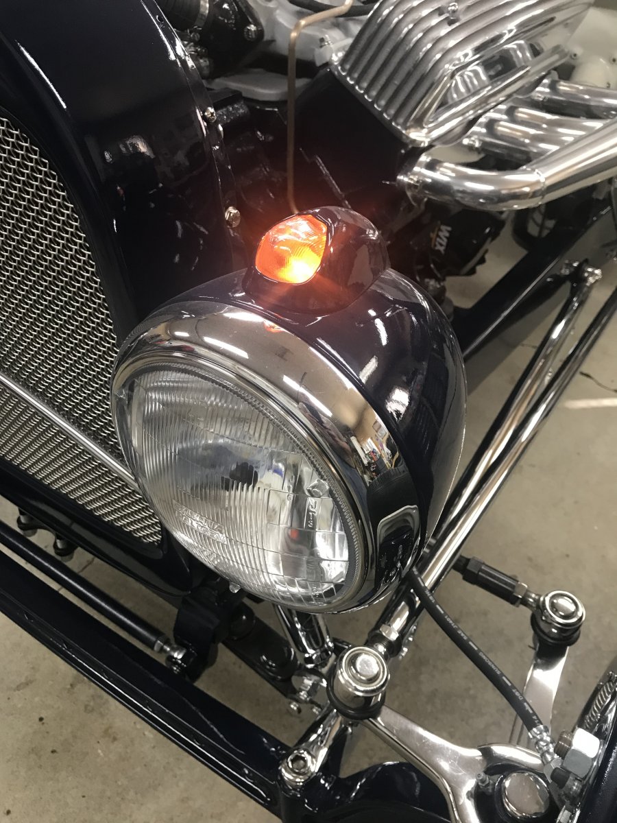

    I’m glad the conversation has mentioned park lights recently.
    I probably asked this question before but for some reason I can’t find or remember the answer :oops: :D
    I installed my custom built 9&3 kit, Jeremy was really helpful, everything works perfectly.
    Here’s a picture of my headlight switch.
    I’d like to have the park lights stay on with my headlights also as they go out now when the headlights are on, I’m not sure how to make that happen.
    My guide headlights have dual filament bulbs so they are signals too.
    My first thought was to move the park circuit wire to the tail light post on the switch.
    867B01CF-E5A1-4EF7-B5ED-31B79E0D6BBF.jpeg E47FD13E-9D0D-42B7-9989-AA2972151C6F.jpeg

    That will work, much easier than replacing the headlight switch with a newer design.
    Way back when, the parking lights were turned off when the headlights were turned on. Possibly because the old-time generator output was rated in mouse-farts and draining the battery was always a concern.
