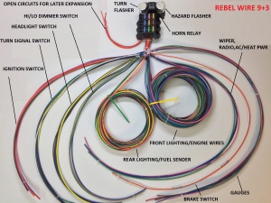

    Are the 9+3 kits done any differently now than they used to be ? And have the instructions been upgraded at all in recent years ?
    I ask because I don't recall the wires being bundled so neatly and segregated as shown in the picture.
    As far as directions go with most wiring kits I always seem to have difficulty figuring out the basics like what wire goes to what switch, things like that.
    Or where do the wires go from the fuse panel.
    I know it's laid out in the diagrams, but for some reason I get tied up.
    Maybe I just overthink it and it's simpler than I want to think :D :confused:

  20. I just looked at the one you sold me and it looks like it is bundled the same as the picture some of those individual bundles are wrapped up together but look to be individually bundled inside the group bundles.o_O I think I just confused myself.:D
    Blue One and REBEL43 like this.

    The only thing we changed as far as the kit is now it has the 3 short pigtails coming out of the extra circuits on the fuse panel, instead of having to terminate a wire and plug it into the back of the panel, more user friendly. The bundling is the same, I just got better at making and editing pictures, lol. I did add a lot to the diagrams and instructions about a year ago. I always go back and forth on what to put in, we've got a ton of diagrams, shelves full, that I reference doing tech support, but there's just no way to cover all of it in the instructions. It's definitly easy to overthink it. I break it down into systems when I'm wiring something: lights, signals, charging system, gauges, ignition system... A lot of the different systems have nothing to do with each other, and are only related by grounds mostly. Also, only the power wires need to go to the fuse panel. So on something like a headlight switch, only the headlight switch power wire comes from the fuse panel, the rest (park, dash, tail, and dimmer switch) all just run power out from the switch to different places. Once you get it down, the older setups are simple really. If you ever get hung up on something or If I can help out, just let me know. I do tech all the time, even on stock wiring and other aftermarket setups. I'm still learning all the time though

    You're right, if you cut the heavy colored wire ties, it will be just like in the picture. I confuse myself all the time

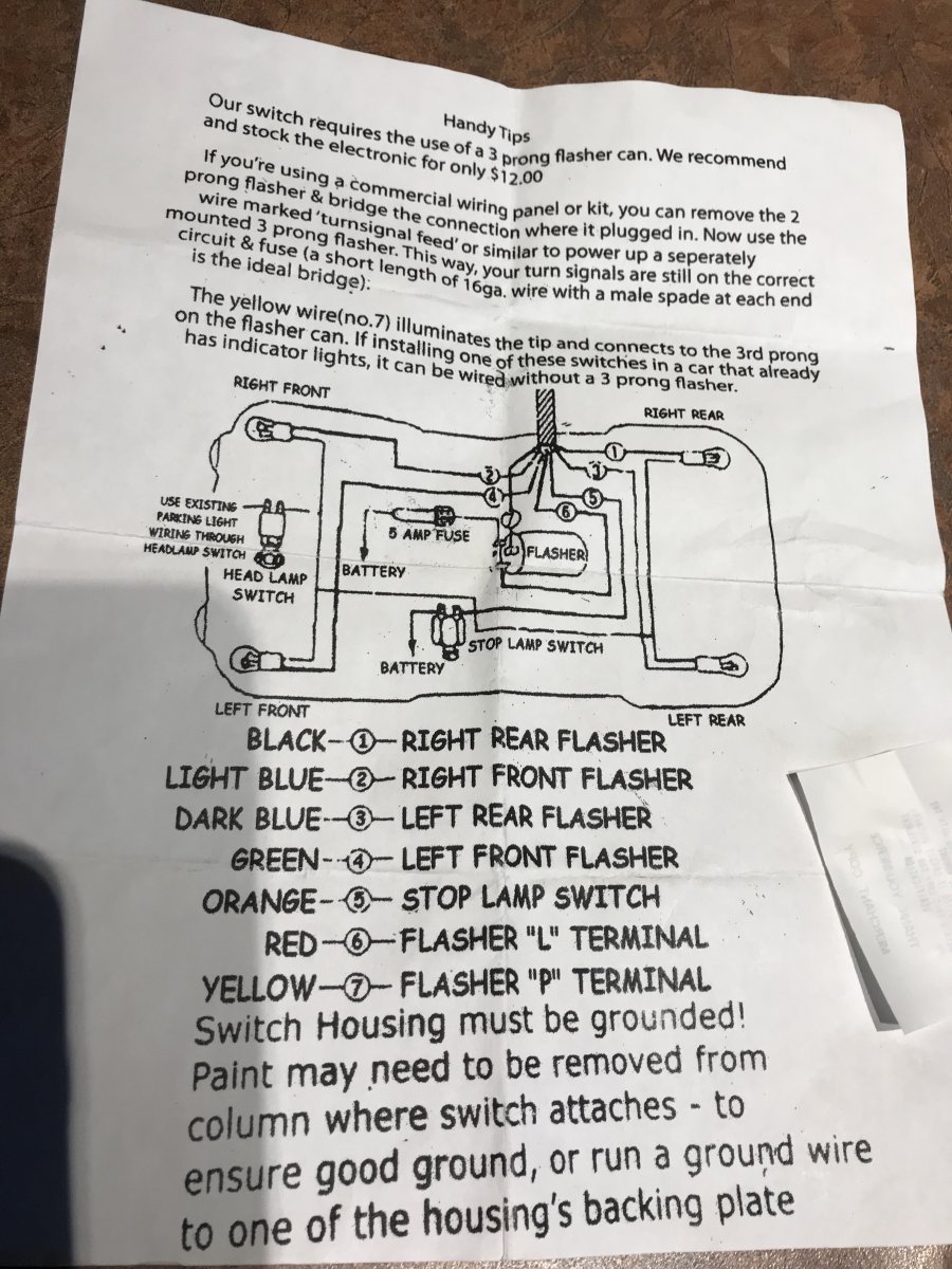

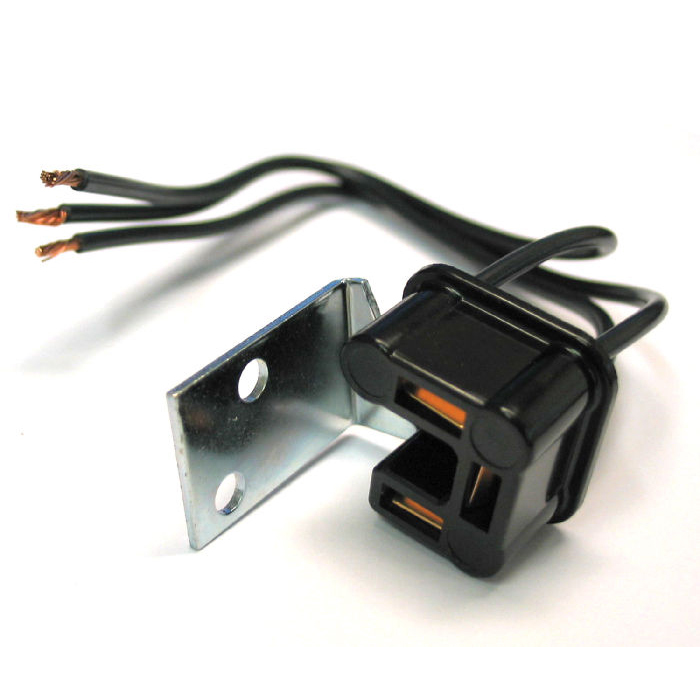

    Do you offer something like this ? or is it possible to have one of your kits take a 3 prong flasher for the 7 wire aftermarket type turn signal with the lighted stalk like the Limeworks one ?
    That way you wouldn't have to jumper the flasher plug in and run a remote flasher mount.

    If we know ahead of time, we can just swap the flasher to a 3 pin instead of the (2) 2 pin 552 flashers. If you already had one, you could also rewire the block for a 3 pin, with the right terminals. But it's not a problem for us to change it when building one. I think I have a picture of one we changed out. I'll look and post it

    On the instructions for my signal switch it uses a yellow wire that connects to the P post on the 3 prong electronic flasher.
    That powers the indicator light on the end of the stalk.
    Power for it also has to come off the L post of the flasher a red wire #6 on the diagram.
    It can get confusing figuring all this stuff out.

    No problem, I can clear it up for you. All of these add on turn signal switches are made to work off of one 3 pin flasher, even the switches with a hazard knob on them. So that means that if you have one with hazards on it, everything will either be a keyed hot, or a constant hot (turn signals and hazards both). So on a 3 pin flasher you have X (power into the flasher) L (load, power out to signals) and P (Pilot, to work the indicator light in the switch). L is basically the power into your turn signal switch when you use the switch and give it a path to the bulbs (or when it pulls a Load on the flasher).
    You can actually use a 2 pin flasher, it just acts a little different. So a 2 pin flasher only has X, power and L, load...no P pilot. The Load wire into the turn signal switch works the same as usual, the X power wire into the flasher is the same, and if you're running dash turn indicators for turn signals you just don't use the P wire on the switch.
    If you are wanting to use the indicators in the switch, and only have the 2 pin flasher you can combine your L and P wires on the switch and put them both to the L terminal or wire on the flasher. What this will do is the indicators on the switch will glow when the flasher is powered up or key is on, and will blink like normal when turning the switch left or right. That's because the bulb inside the switch is grounded all the time and so it pulls enough load to glow and when you add the load of the other bulbs (when turning) it will blink. Sorry, I got on a roll there, had to stop myself....to much information, lol. But that top part is how those flashers work.
    I can try to take some pictures of flasher wiring and rewiring it to a 3 pin if that would help.
