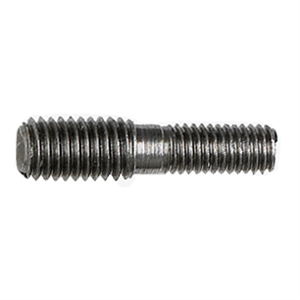

    instead of having to get a heli-coil kit go to the auto parts store and get an oversized stud to regular size and tap the hole bigger and insert the stud, S8x10x38.jpg

    I've repaired many aluminum intake manifolds using a TimeSert repair kit. Search online for a supplier in your area. I consider it a more permanent repair than a Helicoil as the TimeSert is a steel insert that is threaded into the stripped hole.

    Once you've done this , then both of the OTHER fixes can be done at ANYTIME if ever----my vote is this
