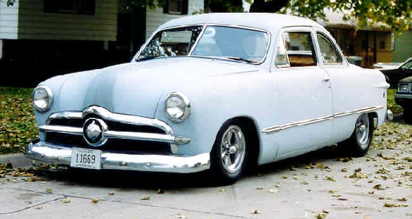

  20. I used a maverick 8" [3:00-1 open differential] in my 49 ford coupe with a 300 HP 355/350 turbo with a shift improver kit. Car was about 3100 LBS and had fairly skinny tires. Never had a problem. Rockybox.jpg
