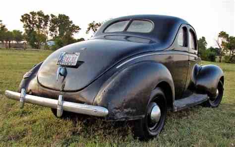

I have a split rear window from a '37 Ford if you are interested. Sent from my SM-T350 using The H.A.M.B. mobile app

I'll post pictures as the disaster unfolds. We will see what it looks like with a 37 Ford rear window. At this point, I really can't hurt the car, good luck has been holding in the current back window that is separating so bad you can hardly see through it. The new, soon to come, split rear window should really add to the confusion some people already have concerning what make the car originally was. Its has been called just about every make of automobile that was ever built, and more then a few people have looked at me pretty questionable when I tell them it a 48 Plymouth business coupe. The new rear window should really add some doubt for some folks. Gene
