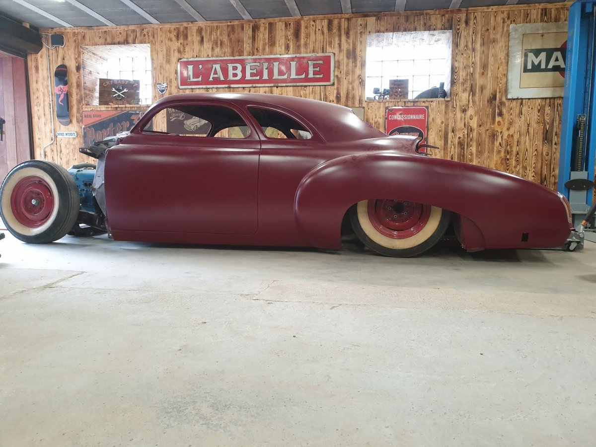

  1. Hi guys,
    I have a dilemma to choose a good combination of tires for my 49 Chevy.
    What I want :
    Bias ply (at worst Bias Look Radial) on 15" wheels with wide white walls, now I have 6.70/15 ones.
    For the front I think it's the good size for my project but at rear, it's a little too tall (it rubs in wheel arch, raised arch wheels).
    I checked a lot on Coker Tires but not sure what could be the best choice.
    I also would like to keep the same sidewall style and width, at least visually.
    I saw the BF Goodrich - 2 5/8 Inch Whitewall - 600-15, it seems to have the ideal proportions but it's not the most beautiful and the 670-15 (for the front) doesn't have the same sidewall style.
    I also saw the Firestone - 2 3/4 Inch Whitewall - 640-15 but I think it will remains a little too tall and also not the same sidewall that the 670-15.
    Do you think smaller (600-15 or 640-15) will be ugly if I put same 4 tires ?
    Do you have return (and maybe pics) of kustom with smaller rear tires ?
    The fender skirt will hide almost all the tire.
    Thanks for your returns.

  3. Yes, I'm on air bags but I would like to gain 1" more, I made a lot of job for that :D
    And to be honest, the wheel arches are raised but the tire also touches the rear since I moved the rearend with the new fender skirt design
    5.90 are really tinny yes, I'm afraid that will be too narrow to cruise safely ;)

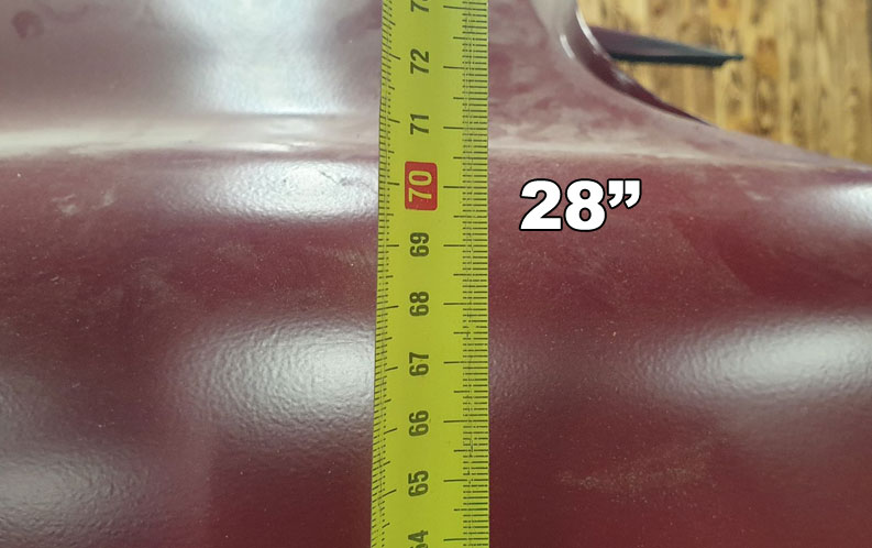

    For front, sure it's what I want... but for rear the top of the fender is at 28" from the ground and the car need to go down about 1"1/2 so I have about 26" maximum for my tire and the 670-15 is 28.58"

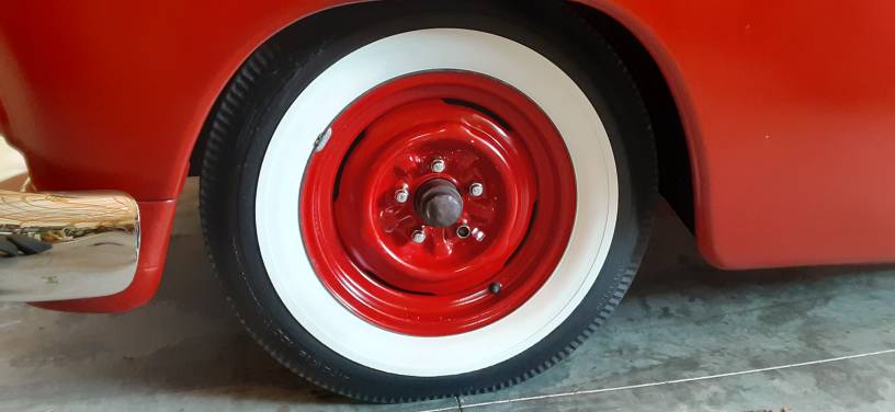

    I don’t know how Coker is measuring tires but my 6.70’s on my outlaw clone are 27.25
    990694A4-D7EE-4D5F-8023-7BFFF695E3DC.jpeg A99259F1-09E5-46E6-AB8F-93902B3412CF.jpeg

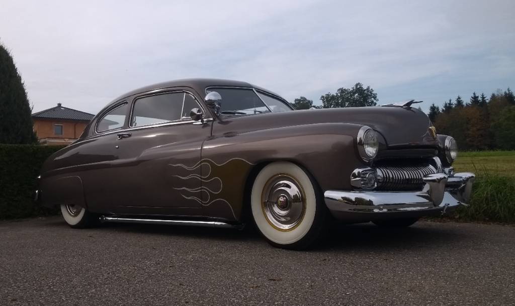

  12. I have 6.70 15 BF Goodrich Silvertown on my Merc and they look good. They also measure about 27.2 (69 cm). IMG_20201024_195428439.jpeg 2020-10-24-20-02-03.jpeg
