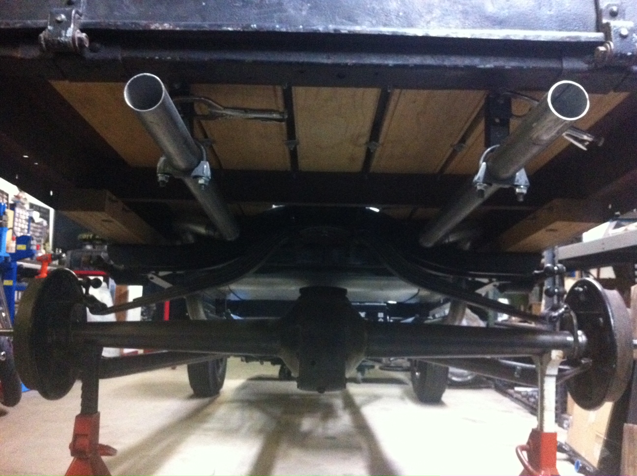

    Just for a visual, here's my tub with 650-16 tires and 3 1/2" Drop Axle up front, and 700-17s and the stock A spring out back...
    ...and the same but with the Model T spring minus the second-to-largest leaf in back...
    ...It is a small but noticeable drop.

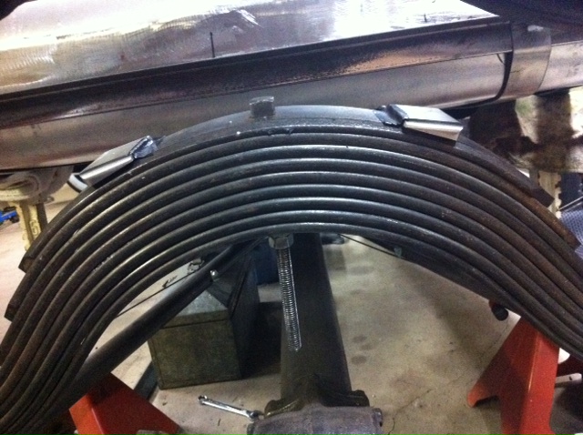

  4. I used a T spring under my A bone. It did require some work. Firstly I had the main leaf shortened a tiny bit and the eyes re-rolled as the spring was bit wide for my diff and the shackles sat at a steep angle. After the shortening the shackles sit at a nice 45 degree angle. This may or may not matter in your case as my spring perches had been welded on.
    Next we machined up a set of spacers on the lathe to accommodate the difference in spring width when using the stock A shackles. I also had a set of brass spring bushings pressed in at the spring shop which we reamed to fit the A shackles.
    Then we milled up a small pair of spacers/spring pads that where rosette welded into the rear crossmember under the U bolts to correct the difference in spring and crossmember arcs and afford a nice solid place for the spring to rest inside the crossmember and bolt up nice and snug as it should.
    Lastly I used a set of stock Model T 2" spring retaining pads on the U bolts as they had a provision to hold the spring centred and the correct angle to fit nicely on the spring and worked perfectly with the Model A U bolts
