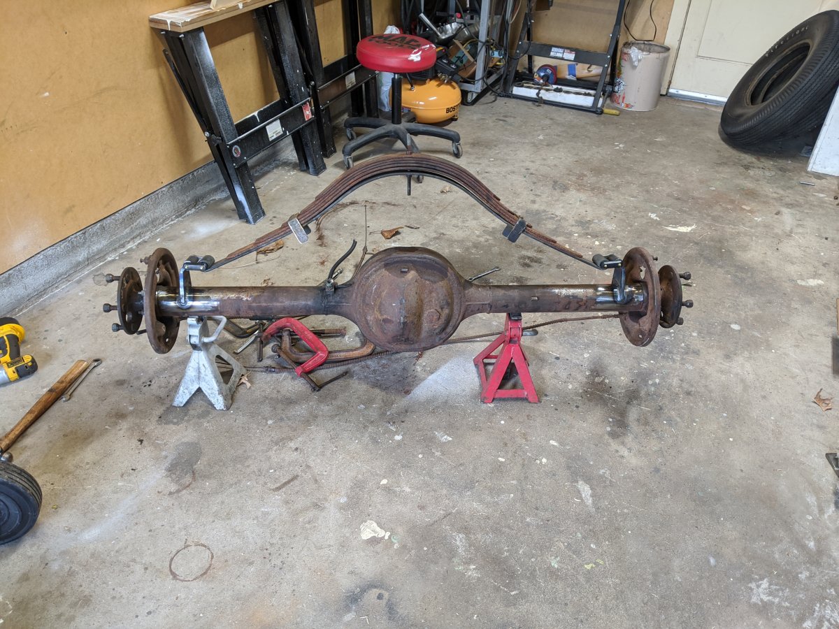

  5. Mine are at 49.5 which is stock. Yours should be at 45.5 given that your spring is 4" narrower. IMG_1428.JPG

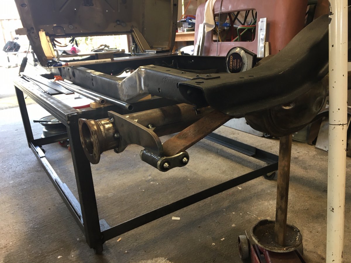

    IMG_20200208_174519.jpg think it's gonna be perfect.

    Building a 29 roadster. Here is chassis. 10 inch kickup in rear 4 in front
