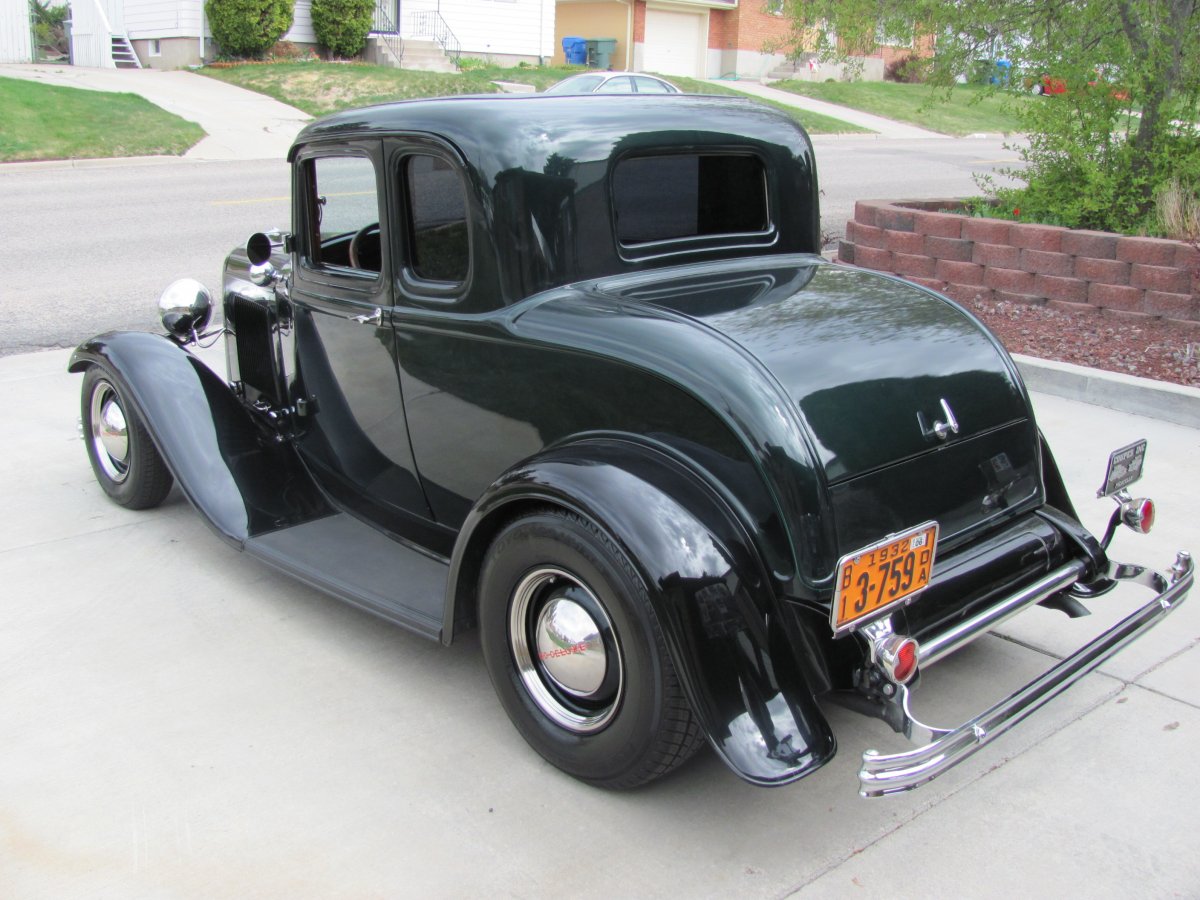

    I have them on the 5 winder and they not only ride great but hauled home 1/2 frozen/wrapped beef and two full CHANGE 2014 028.JPG figured AMERICANS...

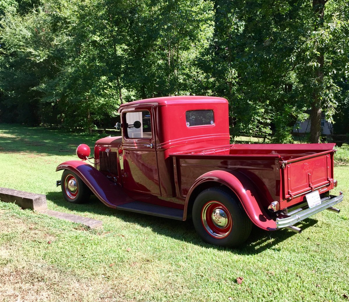

  14. I used Posies leaf springs on my full fender 34 pick-up. Did not have to trim the running
    board like some other brands. I have had them for years with no issues. 2713CE51-6EF9-47A1-802C-96C60F240D3F_1_201_a.jpeg
