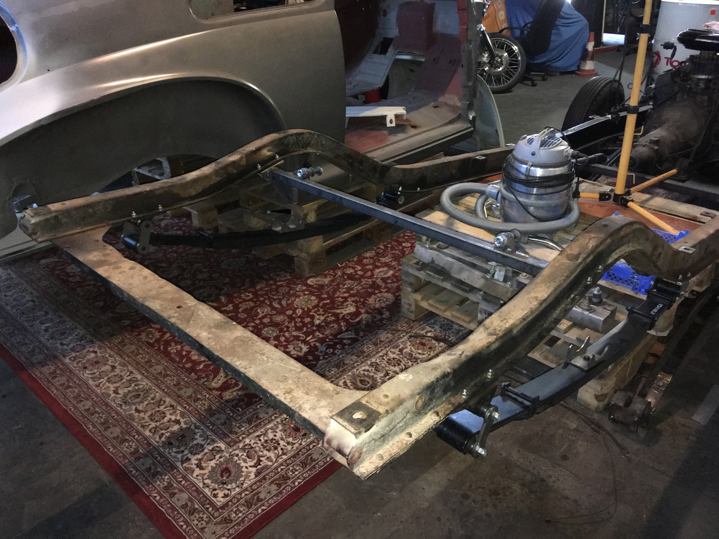

  6. Hi from Berlin Germany!
    I also used the Chassis Engineering kit on my car... in progress restoring since 2014. :)
    Fits nice... but can´t say anything to its driving behaviour.
    Greetings
