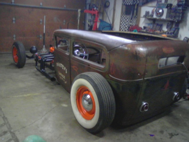

    I'm running a 31 spline axle, 9" ford , out of a 1978 ford truck in my 28 model A sedan . I don't think I could have asked for a better fit . I got about a 1 1/2" space on either side of the body . And she lays low !! About 58" or 59" backing plate to backing plate .With L-78 x15 mounted on mid 50's caddy wheels .
