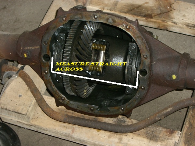

    If its a 10 bolt it could be 2 different sizes, measure the housing, and there should be some casting/ stamped numbers, Probably on the pass. side axle tube

    Measure the housing in what manner?

    There
      162.7 KB

    oops... i read it to fast... my bad...

    And what will this information tell me?
    I also have a 10 bolt rear end that i need to get a ring gear and pinion for but haven't a clue what it is out of. It measures 60.5" from face of drum to face of drum and has 11" drums with 2" shoes.

    A picture of the cover and/or casting numbers would help.

    Pictures (several clear views of the whole thing) are much more helpful.
