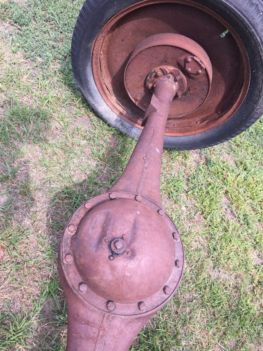

    In a estate bunch of stuff (mowers, etc. ) for sale locally. 4 bolt wheels, any guesses?

    band brakes, probably pre 1930?

    I accidentally delered pics of the front. The R&P bolt into the front face like a 9 inch.

    probably a bigger car, the Chevy used a 10 bolt flange, instead of 12 bolt. But 4 lug? if you post a picture of the outside face of the wheel, that would help a lot! then you can see the part of it that shows up in most pictures on the internet.

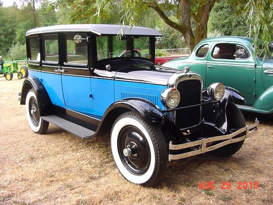

    28 Nash.
    hard to say what the chassis looks like...but compare the wheels....

  7. I was thinking Nash, too with the four lugs.

    Looking at that picture you posted Squirrel, I'd say it's a match. The lug bolts, The raised center flange and the screw-on center cap all look right.

    The shape of the wheel looks different to me. But at least it's a start.
