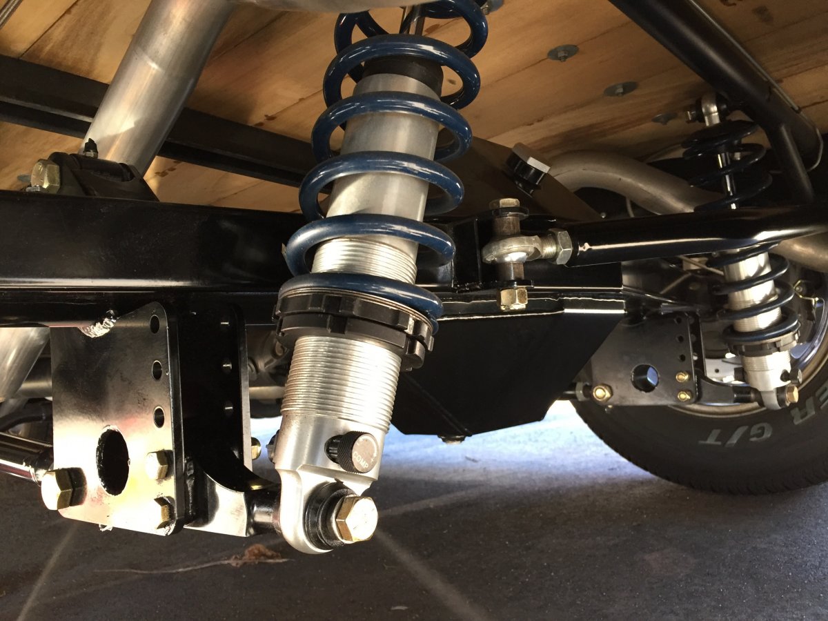

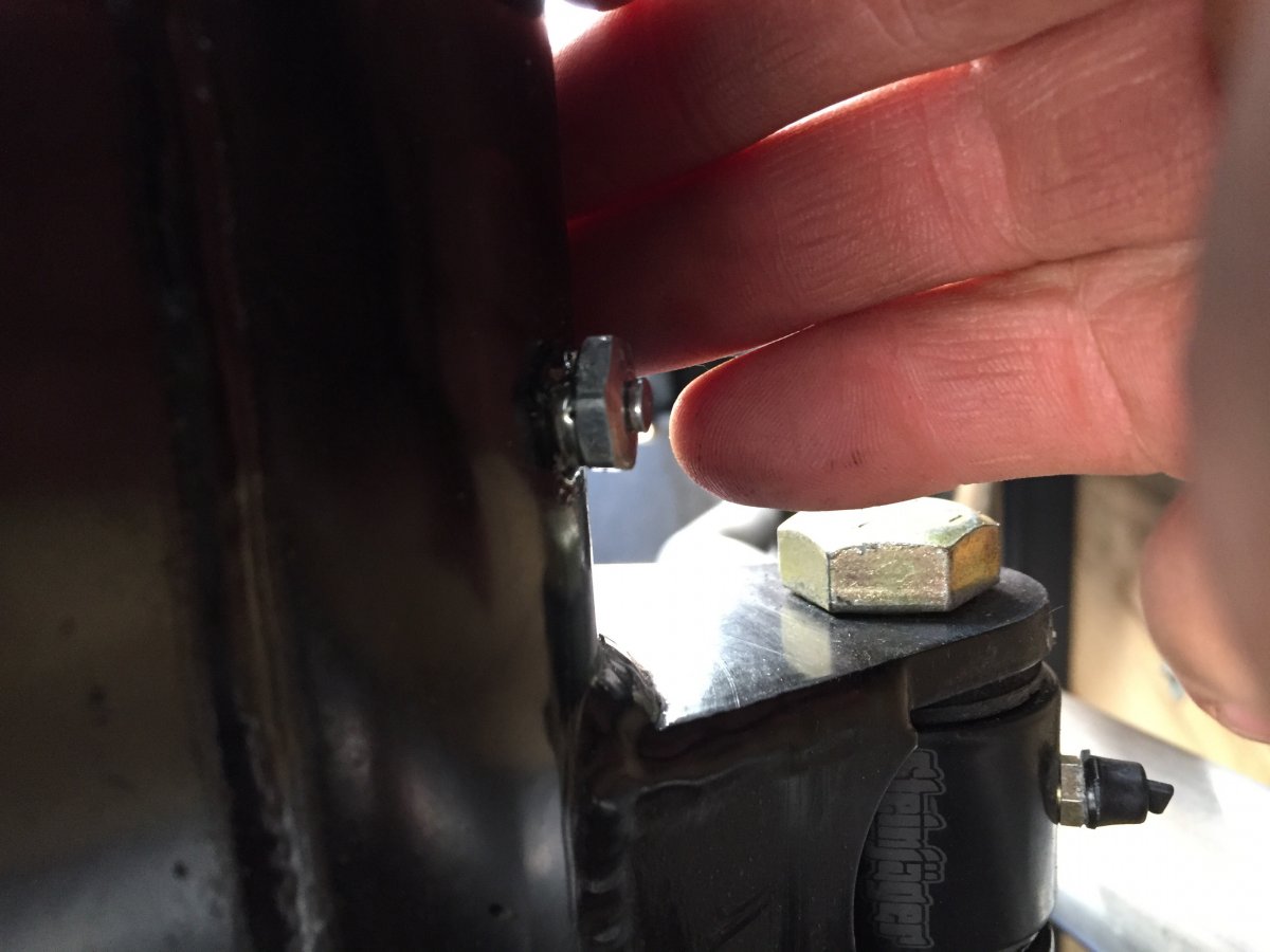

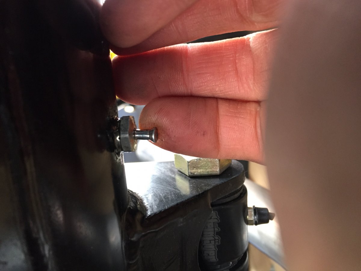

    First pic, I'm holding it up. The spring definitely has tension in it. It's not stuck open like that. I just did that for the picture.

    It appears that you are threaded into a boss, if it were mine I would attach a hose and get it well above the axle with a filter.
    Here's an example using a metal small diameter fuel filter to keep the dirt out. IMG_0655.JPG
  4. I agree with what Sheep Dip posted. Nice long hose with a filter up high. No pressure can build up.

  6. Two things come to mind. One is to make sure that the rear end is not over filled. Over filling will cause a multitude of problems leaking from pressure buildup is one of them as well as blown axle seals. It is also a parasite and will rob you of usable torque.
    Another thing that comes to mind is that your breather valve doesn't come open until you build pressure so it is not really a breather and once you build enough pressure for it to come open it is going to spew. You ay try a more common breather, they let the pressure off way before it become a problem.
