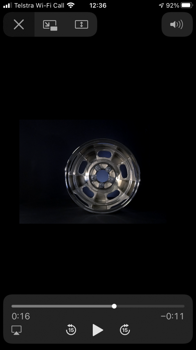

    I have 15x10” with Chevy bolt pattern and want to add ford bolt pattern
    Has anyone added a second bolt pattern to the real rodder wheels my concern is they are not flat on the face hub...

    1" billet adapters would be easy if you have room.

    No room for adapter

  6. Re-drill the axle in the correct pattern, leave the wheel alone.

  8. A good machine shop can slot those wheels 1/8” inboard for the Ford/Mopar pattern. I believe Real Rodder offers wheels that way. It has been done for years for shank nut style wheels. Done correctly the wheel can not move when secured in either pattern.

    ^^^Done a few this way and work just fine...no issues and cannot move as stated above.
  10. I also have had the wheel hole made into a dual pattern by oblonging the hole 1/8 inch in or
    out depending on what pattern you start with. Never had a problem . Also did some magnesium Halibrands. You can not see the oval hole with the washer & shank lug nuts. Looks better than a wheel center full of extra holes.

    This is the right solution, please don’t listen to the guys telling you to slot the lug holes like a uni lug style pattern.
    That’s nothing but trouble waiting for a place to happen and will ruin the wheels.
