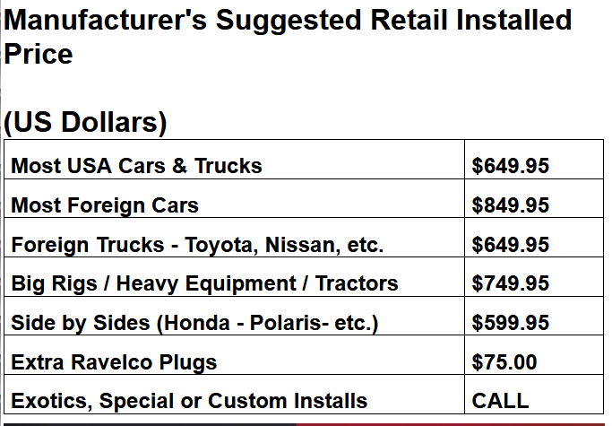

    $462.07?!? For THIS?!? And that is 2010 money!
    I got curious to see what a 2020 system costs.
    I'm not one to go around bashing products, but... :eek: Damn, son! I am in the WRONG business.
    I dunno, man. Damned near $600 seems a bit steep for a few feet of wire and a plug.
    Granted, a system installed into a newer, computer controlled car would require more wiring and shop time, I'm sure, but Jeezu Flip! There's maybe $50 worth of materials here. I guess you pay for all the electrical tape. :D
