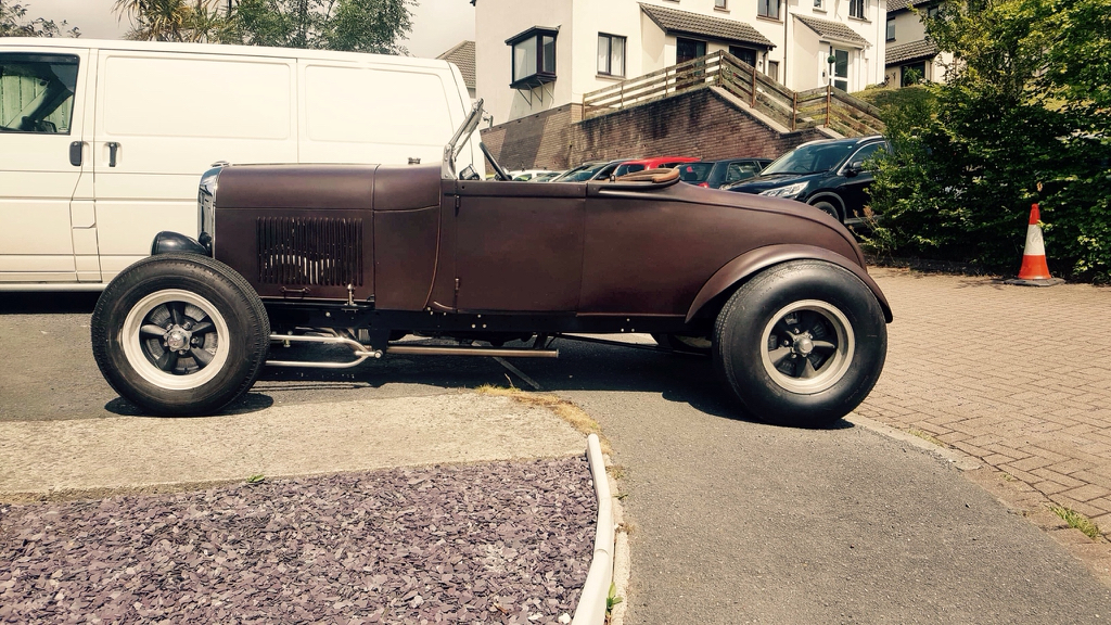

  28. I bought a can of catalyzed Wimbledon White to do my firewall and a few other spots on my Ford. I have tons of experience painting model cars, same concept only 25X bigger... Sort of expensive but it was only 1 can. I did the interior floor pan using rattle can primer, followed with Auto Zone Duplicolor white lacquer that came in a quart can, used my jamb gun for that.
  29. Hackerbilt
    Joined: Aug 13, 2001
    Posts: 6,250
    Hackerbilt
    Thanks!
    I made a lot of changes to the car while I had it and everything was done on a tight budget.
    Rattle cans can't compete with quality catalyzed paint but there's no reason you can't get a decent look if you put the effort in.
    The T was a driver and was driven on several inter-provincial trips, so the cheap paint took some of the sting out of the rock chips! LoL
    I really miss the T but our weather lately meant I wasn't getting to many of the out of town shows, so it had to go. I traded it for a muscle car, thinking I could accept it...but I'm just not feeling that after having the roadster. I think something else will be in the garage in the near future...
    Heres a side view. I was in the process of rounding up steel wheels etc when I traded the car. Ended up giving them to a friend for his 50's Buick project.
