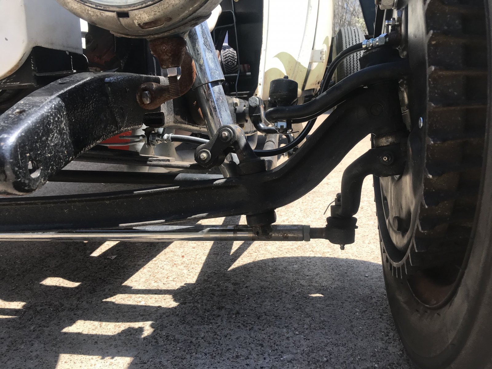

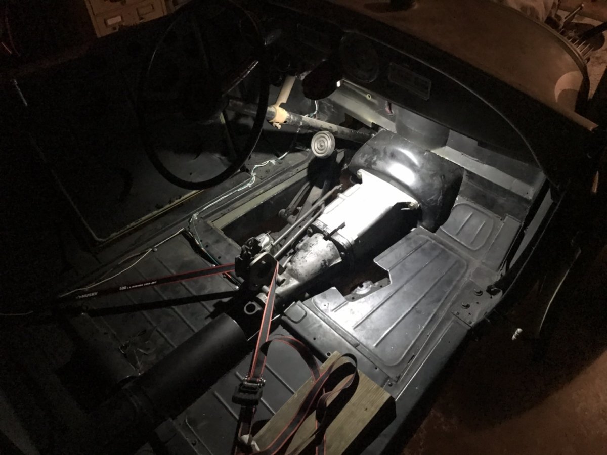

    Weekend update: I borrowed a “Power Bleeder” from a buddy and re-bled the brakes and clutch, tightened up the steering some and took it for some more test driving. It drives way better than it did before. The clutch engages/disengages perfect now that I bled the slave cylinder better but the brakes still need some attention. I went through and adjusted all the star wheels so I’m not sure if it’s the ‘60’s Chevy truck master cylinder as we had a similar issue on a T-bucket at work using the same MC. I may have to pull it and swap out the cylinders.

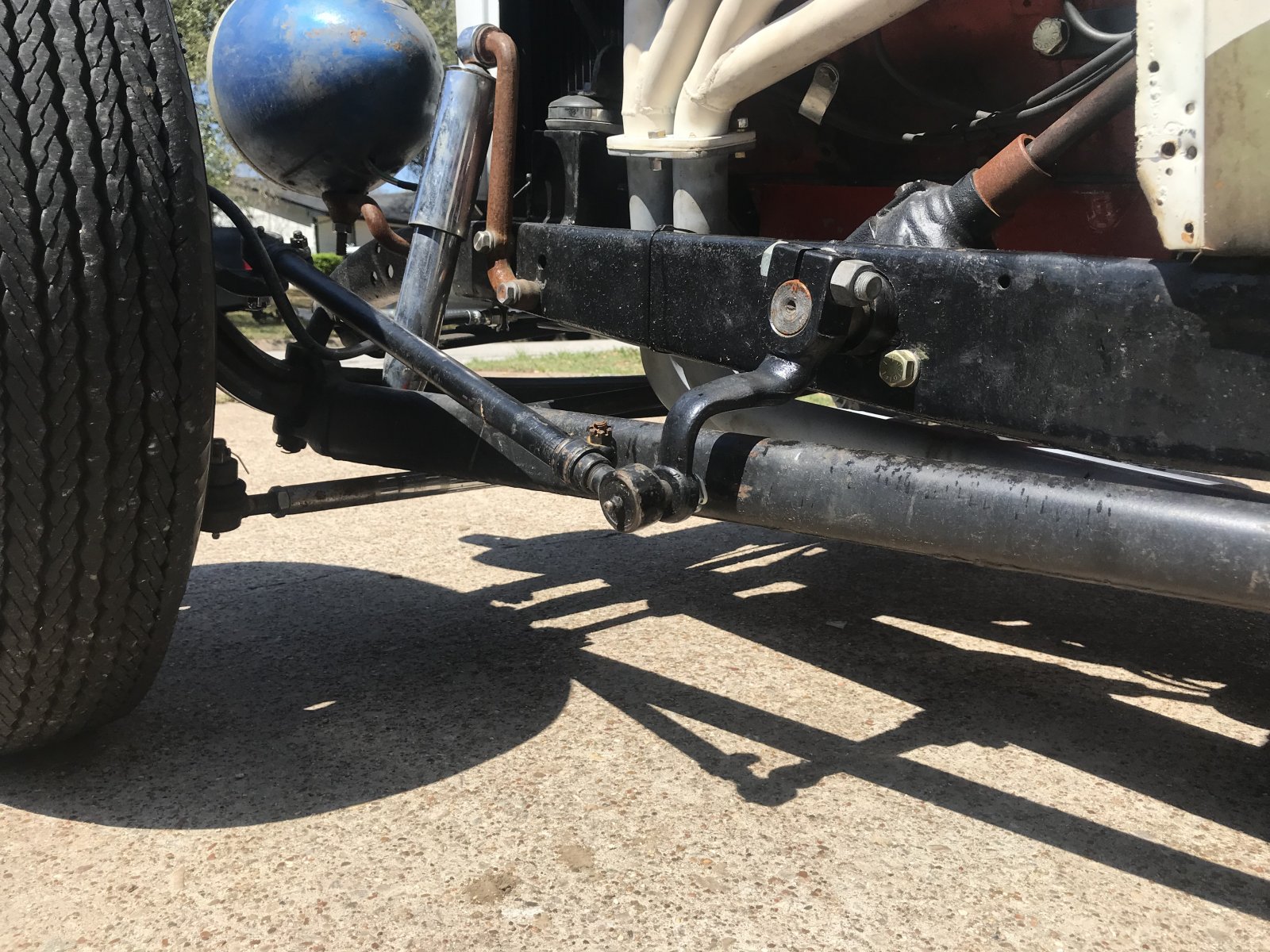

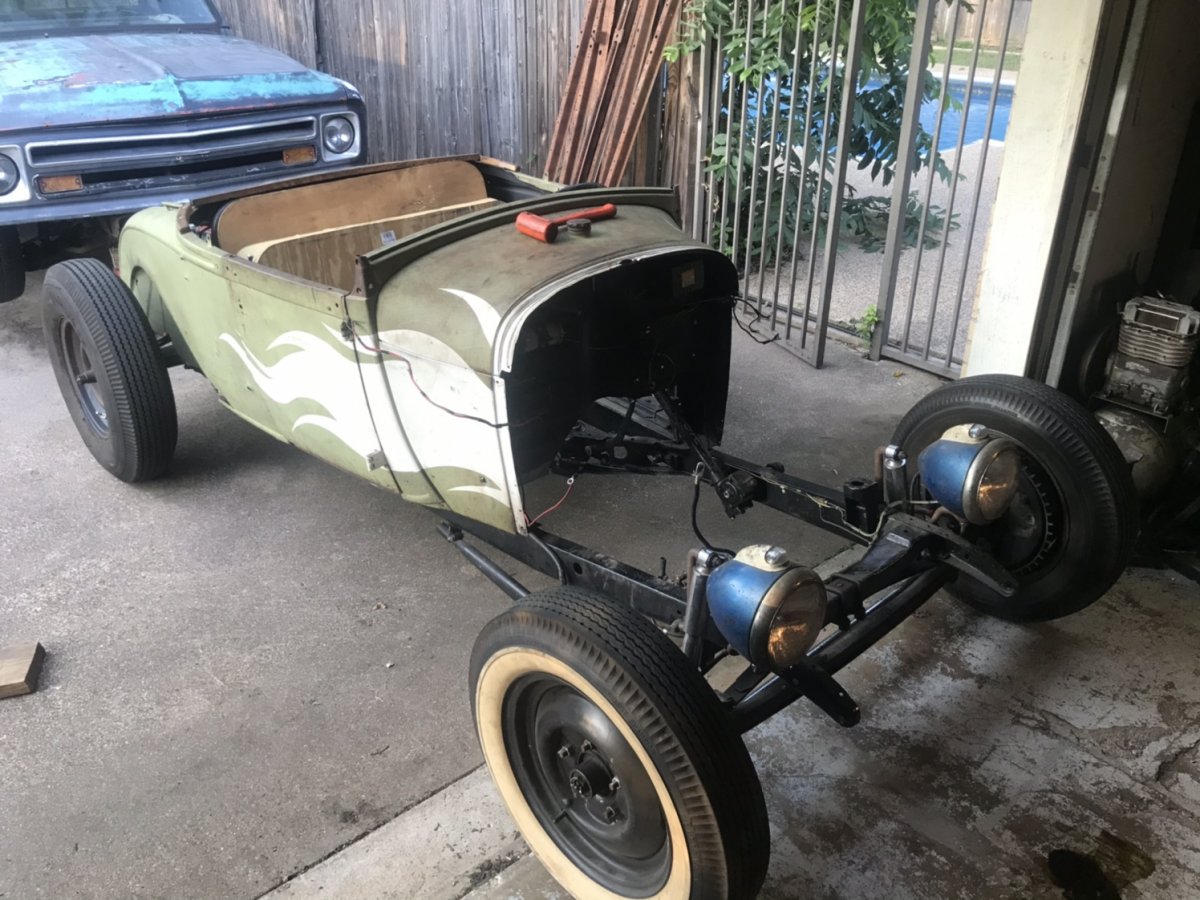

    And .. unsurprisingly I’m still battling the dreaded death wobble. I have a few threads pulled up right now and I’m reading through all of them to try to figure out what it could be. I figure it couldn’t hurt to throw up a few pictures and maybe some of the more experienced eyes on here can make some guesstimates. I plan on attacking this issue next weekend with my digital angle finder and checking all of the suspension points. And don’t worry - I’ll be sure to put a lock washer on the bolt retaining the pitman arm.
    From what I’ve read so far, it may be that I need to raise the bolt on the bottom of the pitman arm some so it’s closer to the arc of the suspension articulation. I also should have 7* of caster in the axle at the kingpin but I’ll double check that anyways.

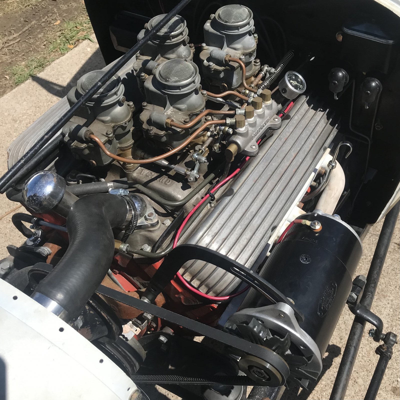

    Another issue I’d really like to address is my Holley 94s love to leak gas down the intake/cylinder into the oil pan. I’m not sure how to address that other than being told to change them out to 97s. That’s not financially feasible for me right now prior to the Round-Up. I’m thinking it may be the power valves? Would just plugging off the power valves resolve this or would it just cause more problems?

    While the angle of the draglink may not be ideal, it might give you the bump steer that gets the death wobble going, but it won’t be the actual cause. And if you shorten that pitman arm any more, your turning radius is only going to get worse. I’d try to figure out how to take a degree or two of caster out of it. And if that doesn’t work, put a steering stabilizer on there and forget about it.
    what is your fuel pressure set to?

    there’s a few threads about carbs leaking down but I’m not sure they are relevant to the specific problem as your not having fuel from the stock gas tank draining threw but having the bowls leak. Might be worth a read either way?

    Did you happen to put the block off plates on your intake? if you don’t put the heat cross over block off plates your intake temps will boil over the carbs after shutting down

    Do you have a fule pressure regulator, 94s need ,1.5 pounds of pressure.

    My wheels hit the wishbones before maxing out on the steering box so I think there’s some room there. Eric Carter had the same issue on his coupe and shortened his and it resolved his bumpsteer issue.
    I’ve been told Holley 94s are prone to this. With my fuel pressure regulator, my gauge is showing about 3 PSI.

    I do. And it’s set to about 3 if I recall right.

  17. I added a steering stabilizer and it made a world of difference.
    i have the same issue with my 94s, following along to see what suggestions others may have for them

    Hard to see whiteout a side shot but:
    The steering link should form an imaginary line the intersects the wishbone mount on the frame. I would say your steering arm is bent down a touch too much.
    Jeep's with 0 or toe out are prone to death wobble. Set the toe at about 1/16" to 1/8". Find an old guy who knows how to do alignment with a string line. It works great!

    Try and get that fuel pressure down another lb or so. Leave the PVs in.
    I use 2 pressure regulators, the Holley and a mr gasket. Combined they will get down there.
    Agree with eric another degree in caster wont hurt.
    Is your toe-in about 1/8" ?
