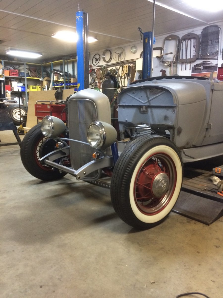

  1. Well its been about a year since I posted photos of the tub. I thought I'd provide an update.
    Gave her a face.

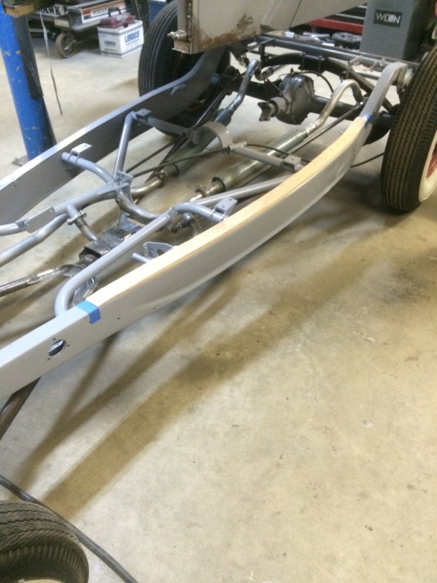

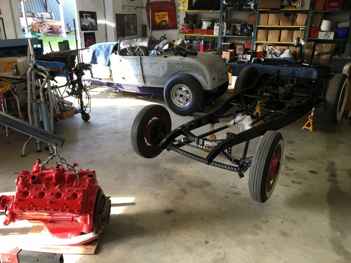

  4. Fitting body to chassis - made body shims out of white ash per Matt's suggestion. Shims are thick because of the up-swept rail stampings. Not Jordan Graham thick... but thick-er than normal nonetheless.
  5. Chassis.JPG Fitting body to chassis - made body shims out of white ash per Matt's suggestion.

  11. Chassis at work to get half of the safety inspection completed. Apparently the second half couldn't be completed without the body on. Structural integrity without the body? Guess it makes sense. July 19 001.JPG

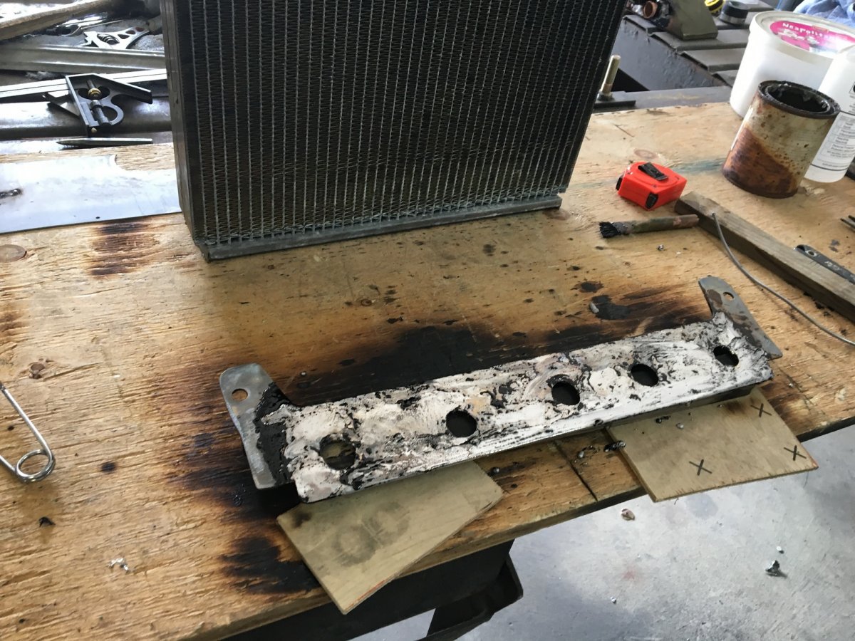

  12. Some prep work for the radiator. Earlier I posted a couple of photos of the bottom tank I made up. These pics show the 1/8" bottom plate that was pre-soldered prior before attaching to the tank. I welded some brackets to the bottom plate to hold the horn and a junction block. I don't have a photo but I made a filler panel that fastens to the bottom of the rad to cover the underpinnings so they are not visible through the grill.

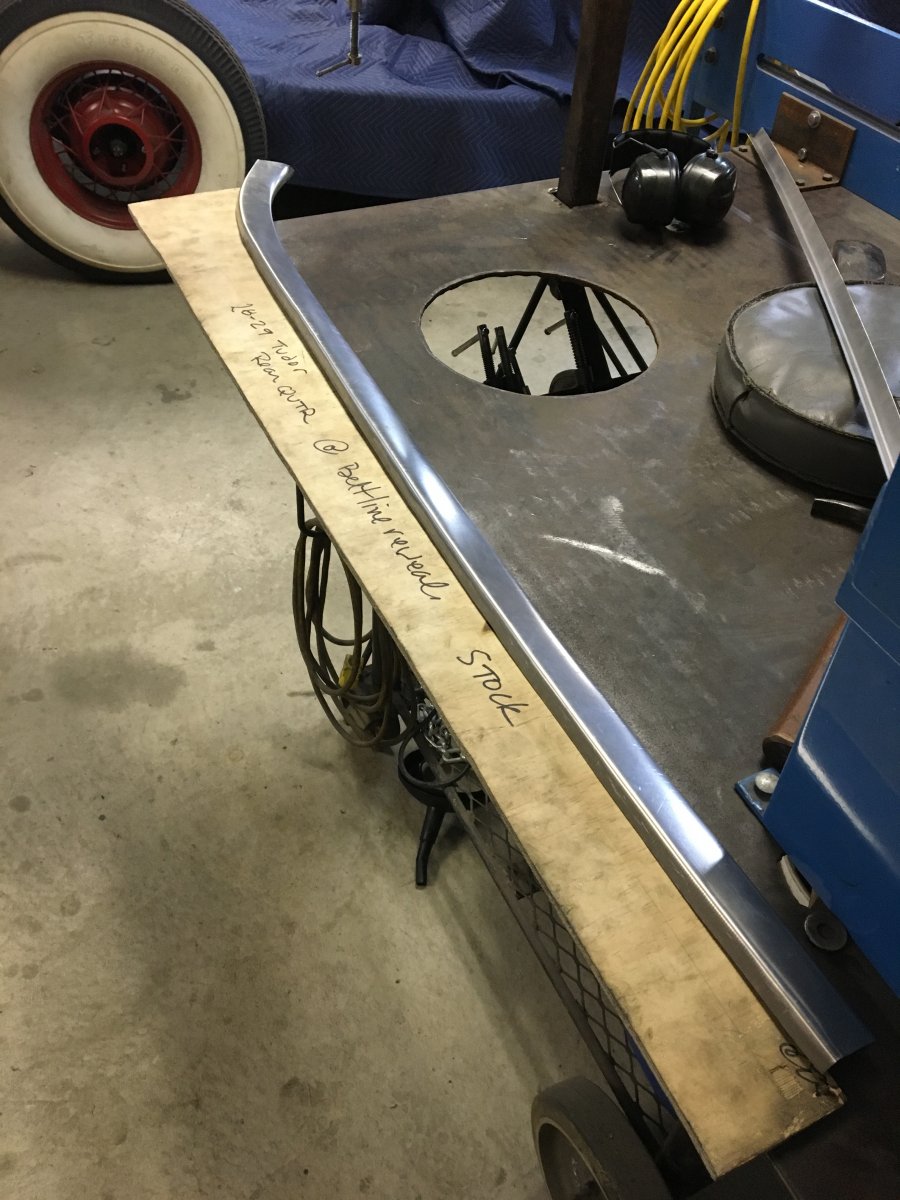

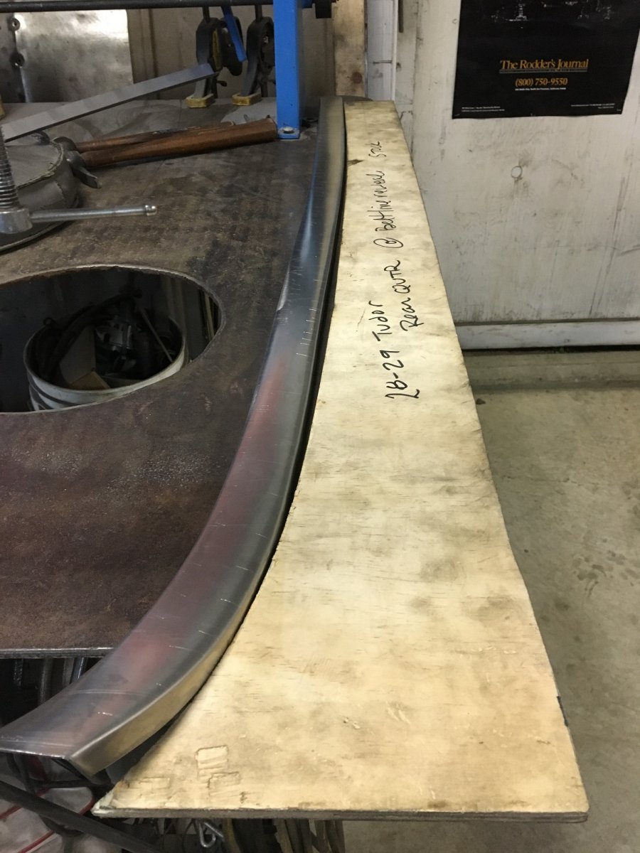

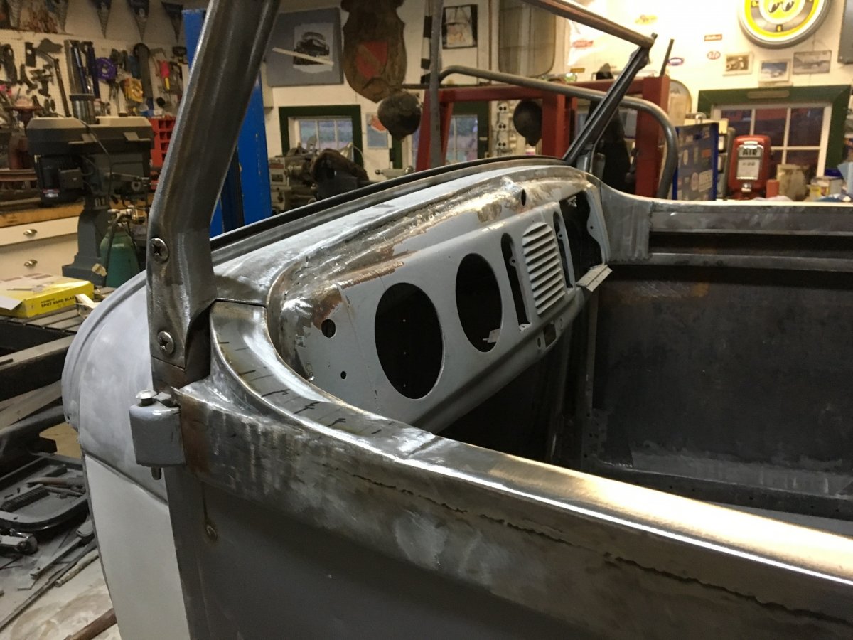

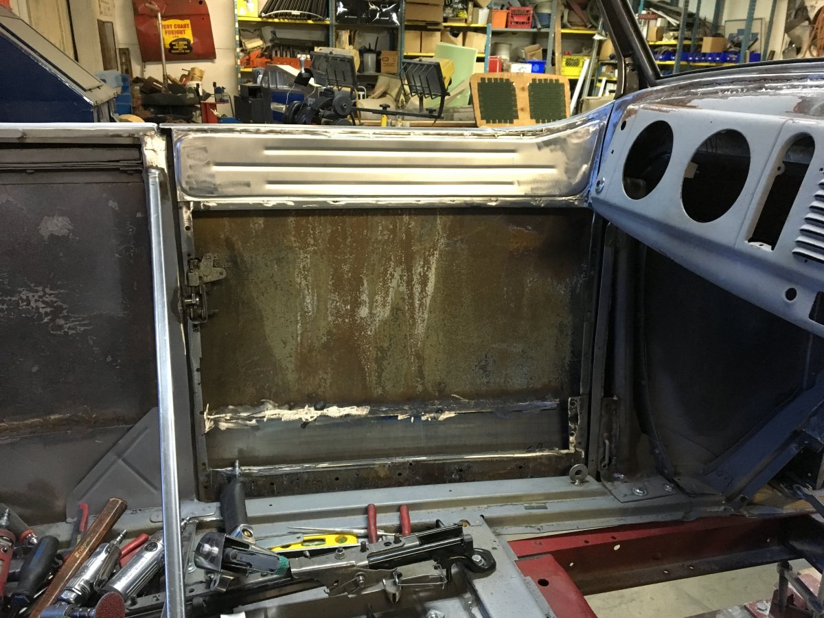

  13. As you know, this tub started out as a sedan, and needed some TLC to get it to stand up straight. the original deal I made did not include metal work but I just felt it needed some help. I used a tipping die and a roller skate wheel in my bead roller to make caps for the quarters and doors - and kept going into the dash. It was a bit rough but I was flying through this thing to get it done for Victoria in July.

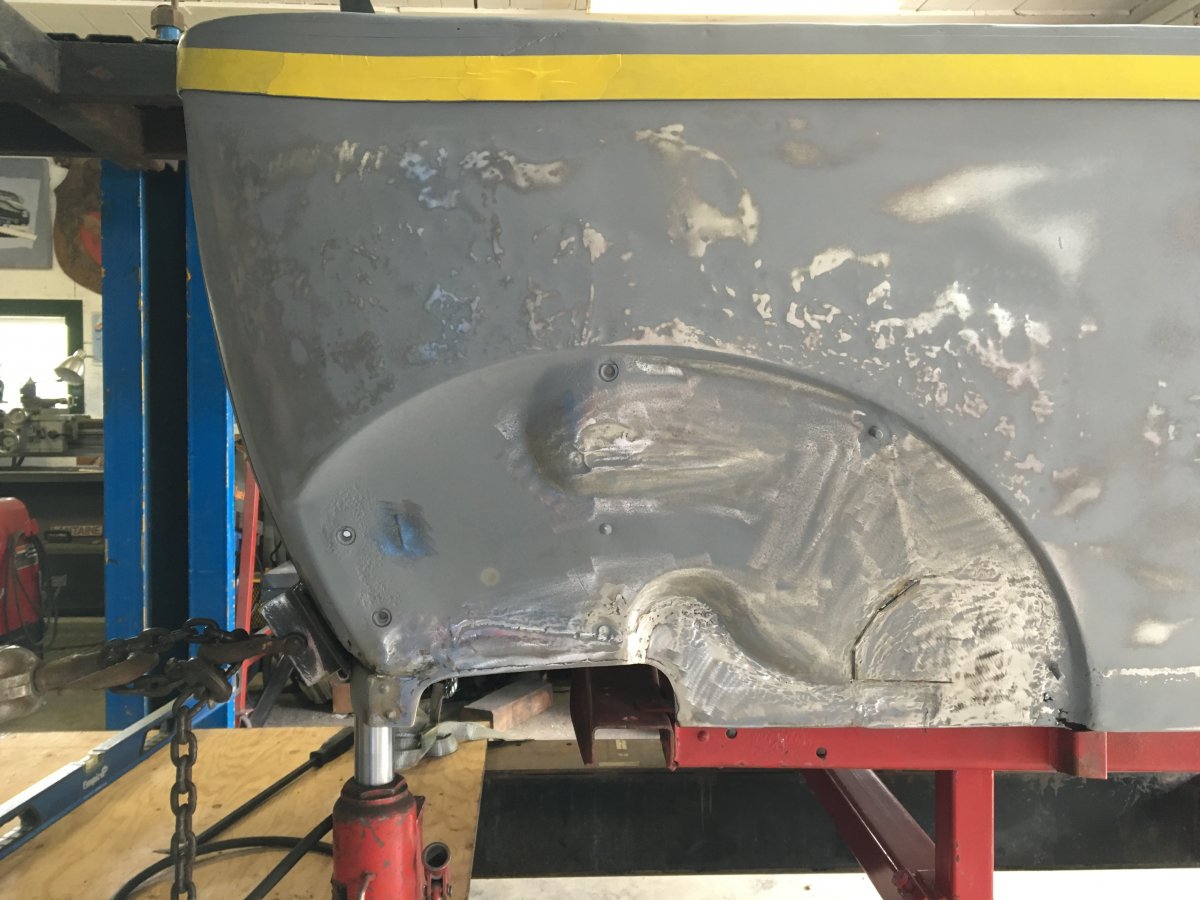

  14. Stole a bodyman from work for a few Saturdays to smooth out the rear of this thing after I completed the metal work. Not long after mind you - I always stayed at least 4 inches ahead of him
    Dannerr and kidcampbell71 like this.

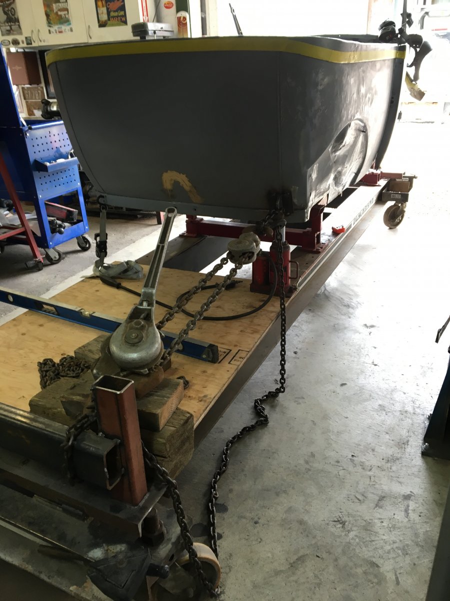

  15. Car was hit pretty hard on the RH rear corner. The damage was obvious but it wasn't until much later that I found it was pushed in about 3/8"... which I couldn't live with. I actually discovered it making the rear bumper mounts.

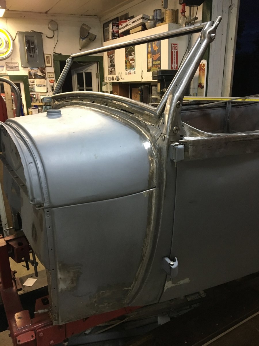

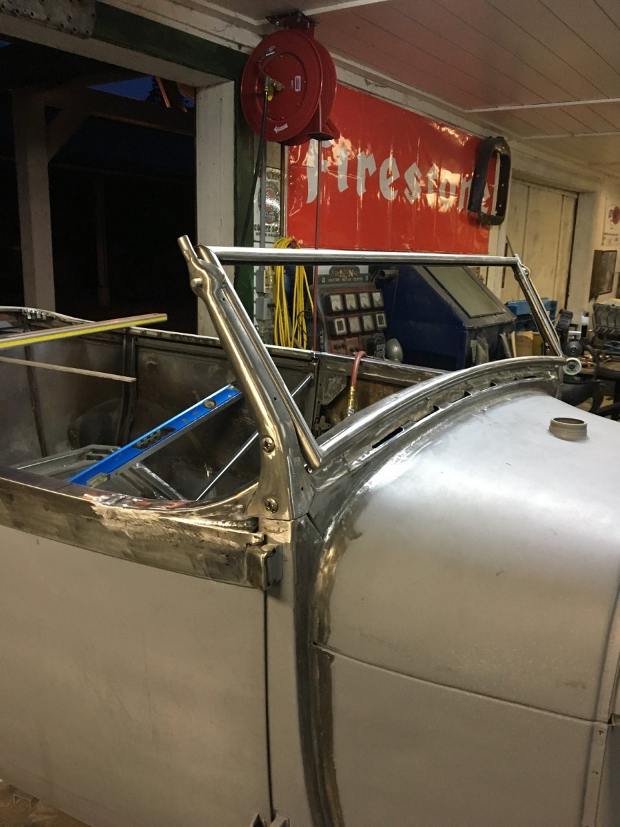

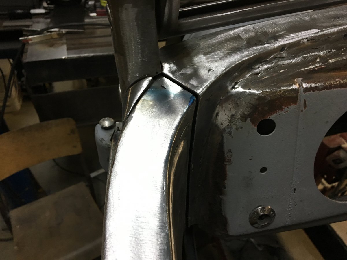

  17. Windshield posts are stock roadster with about a 4 inch chop and leaned way back. tough time grafting them in but worked ok. I'm very slow with some stuff. The windshield frame was round tube that had channel grafted in (1/2 X 1" ripped up the middle). I bought a Harbour Freight tubing roller specifically to make roadster windshield frames. Worked way better than I expected. I used it to true the parts of the frame that were supposed to be straight. Simple tool that worked great.

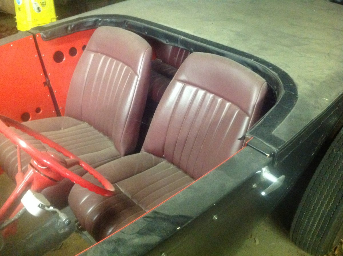

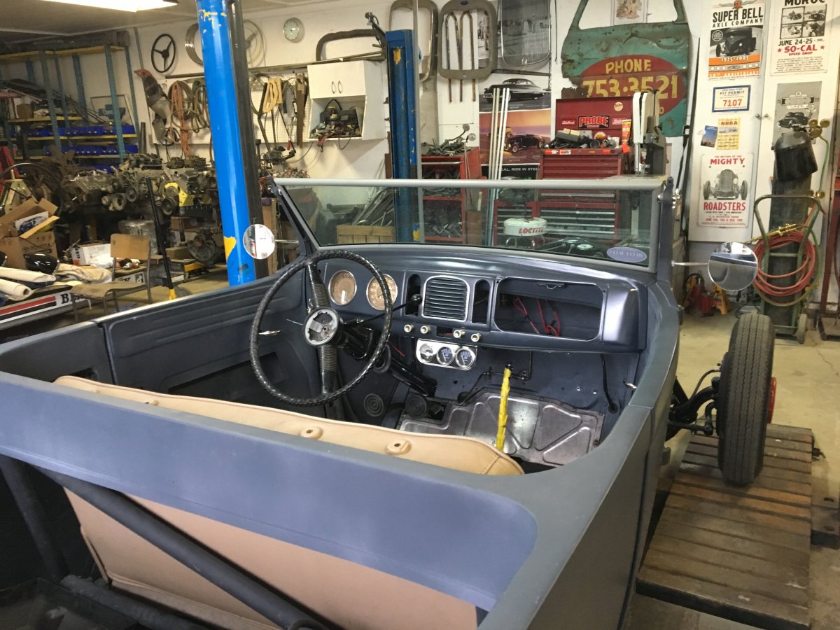

  18. I wanted to make a bulkhead behind the front seat out of tubing but wanted something to snap a tonneau to. Kind of looks like a kitchen sink but wth hey?
  19. Top 5" of doors were supposed to mimic the dash but kind of took on a life of their own. there was a gap that needed to be filled right behind the windshield posts that took some thought.

  20. Here's a photo of an in-the-process quarter panel cap. I could have done these in three pieces but I thought it would lose the "pillowed" look of a stamped piece. The roller skate wheel causes a lot of distortion to the piece as it is being formed. it bannanas it, which is easily corrected with a shrinker - but it also distorts it in the direction of the outside of the curve (bows it outward). I screwed with patterns (3/8' plywood for plasma cutter to cut out blanks) trying to get it bang on but it is totally futile. I just corrected the lines by shrinking the tops with a series of heat spots using a stud gun - then a shrinker for the flange. pain in the rear.

  21. Mounted mirrors and finishing off the list. Need a glove box door Aug 10 001.JPG

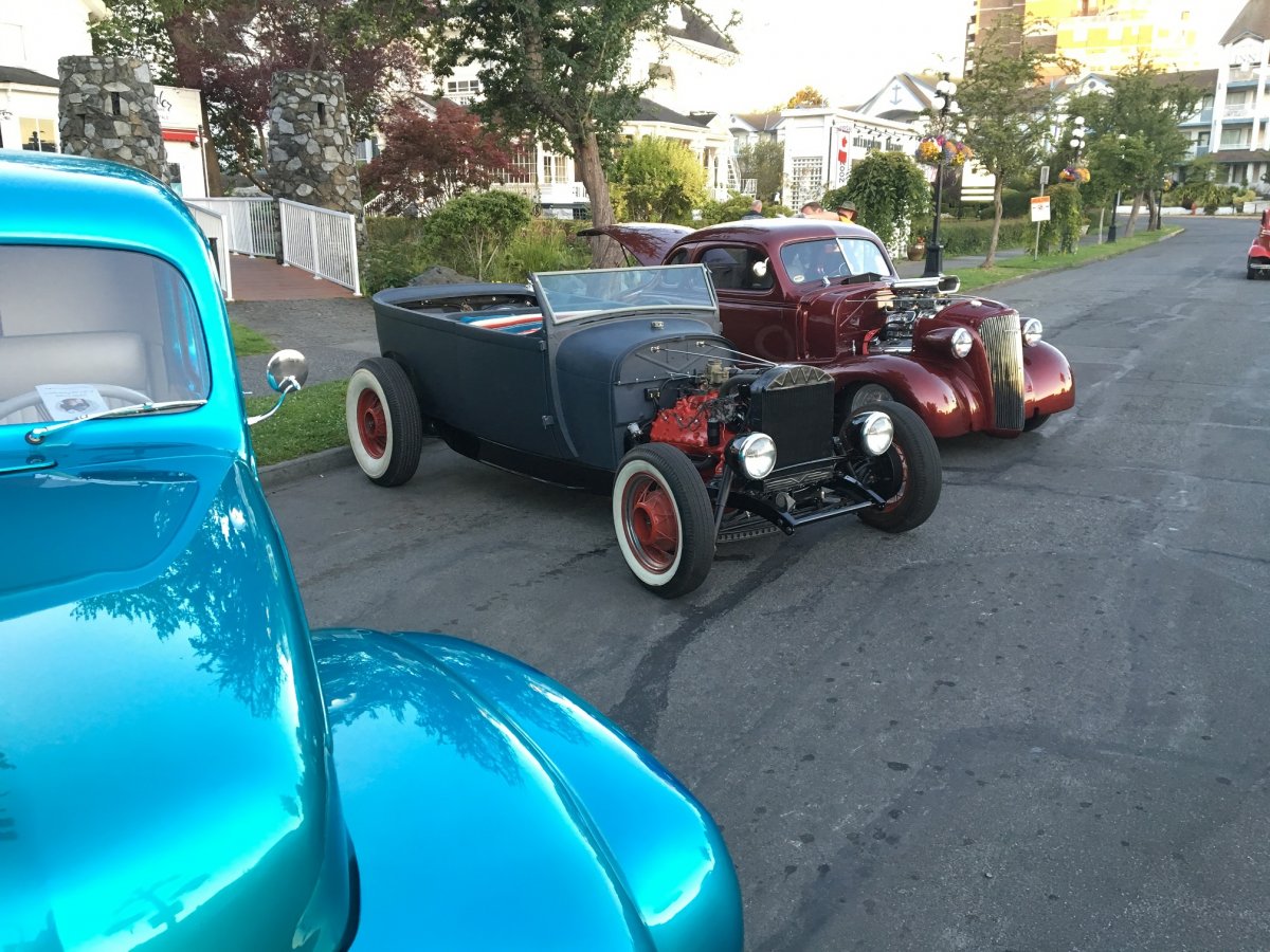

  22. After more 3:00 am nights than I care to (or can) remember, we made it to Deuce Days at Victoria's inner harbour. Thrashed until 10:00 the night before, took it for a quick test drive and loaded it on the trailer. Got into Victoria at 1:15 am. Up at 5:00 (pretty shaky), unloaded it and drove it into the show. This little get-together (1100 registered rods, more than 600 of which were 32 Fords) happens every three years only. Since I missed 2007 by a month with my roadster, and 2010 cause I took the roadster apart to install a Chrysler, and 2013 cause I never got it back together, it was gratifying to field a car at this venue. There was even some other traditional cars there. If I had my sh*t together I would have parked among them.

    I was parked on Belleville about a block west of the Days Inn. It was a good spot to drive a car into the show that didn't even have a VIN! A block from my hotel and truck/trailer.
