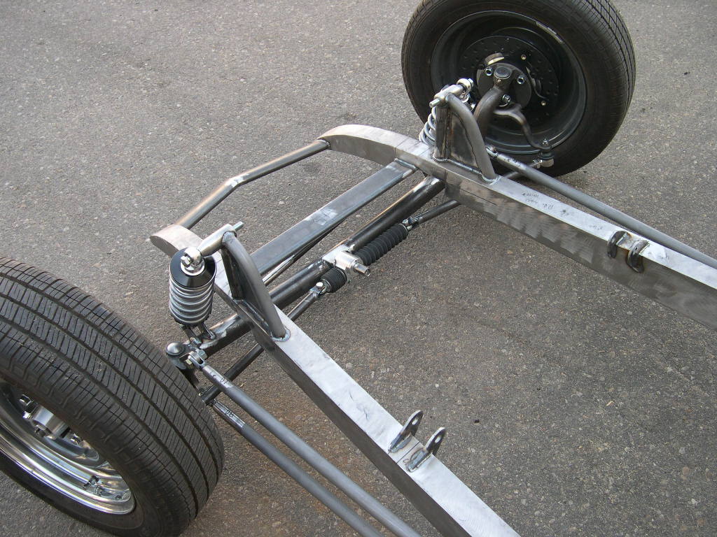

    Here is a fresh made 32 with R&P steering and a straight axel. Ran it uo to 85 so far and all around town and no bump steer. My 33 has a straight axel with the old style vega box and it soon will be changed over to R&P

    can you get some specs/pics? many would be interested in a way to do this if the geometry is solid.

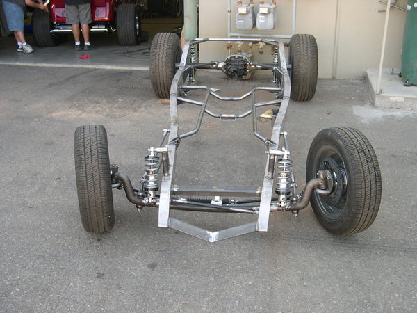

  28. Gary ---- here ya go.
    Has a slip joint as mentioned earlier, and zero bump steer

    hows that dragster/sand rail rack work? They were not designed to turn that big of tire or carry that much weight? All the ones i have had have 5/16 heims on each end, even the Spe racks that are high quality. your frame looks nice and clean. Any pics of engine and steering shaft?

    Cool, and thanx. How much travel in that rack? Gary
