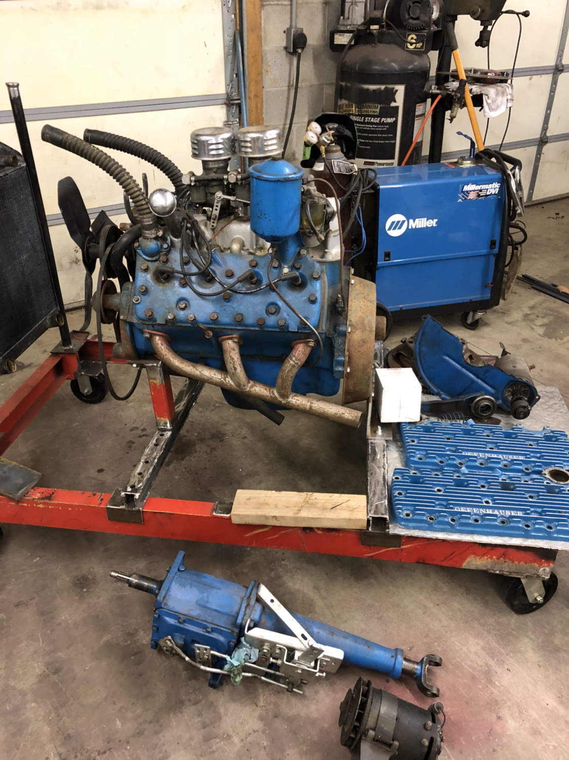

    Thanks for all the comments guys. It really is helping me with my choice. I was able to trade my friend out of a S-10 T5. Ive still not decided completely, but I'm going to take some good measurements to see where the shifter would come out on both. Hurst makes a decent looking shifter unit for the old 3 speed (it is not an overdrive).
    The flatty I have was rebuilt by a guy 6 months ago, put into his shoebox and then taken out after 600 miles or so because it didnt have enough horsepower (swapped a SBC in.) His loss my gain. Its kind of dirty and the heads are off it with the original heads back on. He said the Offy heads didn't have enough clearance and needed thicker gaskets.
    I'll post a "dirty" engine pic tonight when I get out to the garage and then post an "after" pic in a few weeks when I get everything cleaned up, polished and painted. I'm building an engine run stand so I can check it out fully before setting it in the car. Someone mentioned swapping out the stock distributor for an newer MSD. You think that is necessary of a relatively mild engine like this?

    So I finally got a chance to post some dirty engine shots. I’ll be cleaning it up once I test fire it to make sure everything is A ok. You can see the finned heads on the cart awaiting reinstall. I also included a car pic for reference to what it’s going in. Got the dropped axle installed today. I’ll be starting a build thread when I get a little closer to where I want to be. [​IMG]
