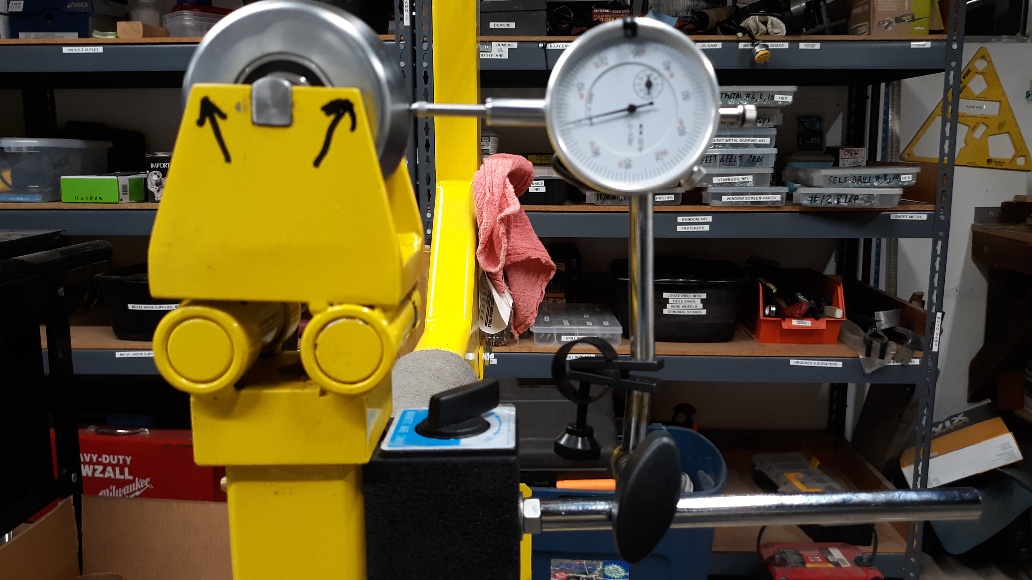

    Very impressive runout numbers
    3" radius Eastwood lower anvil less than 0.0015"
    4" radius Eastwood lower anvil approximately 0.001
    6" radius Eastwood lower anvil approximately 0.001
    8" radius Eastwood lower anvil less than 0.001
    More or less within my measurement error and dramatically better than the JEGS lower anvils that I reported on.
