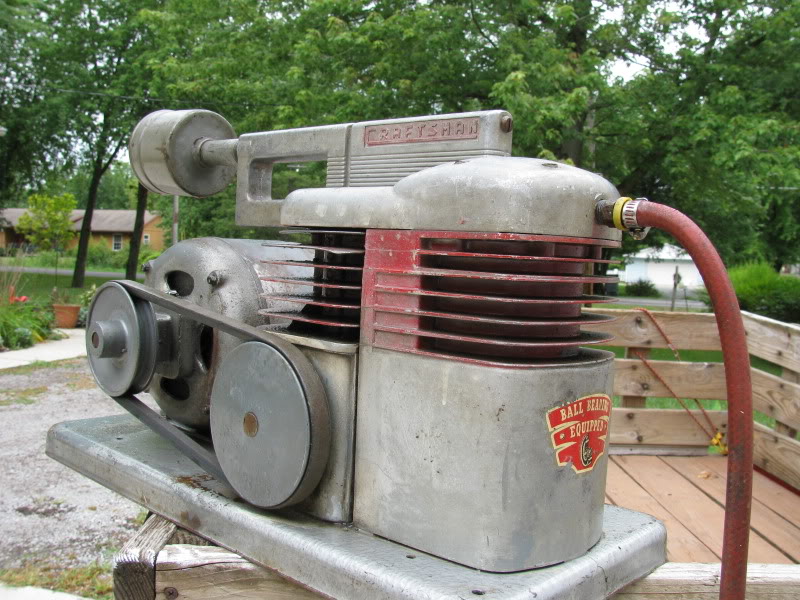

    I painted my Nomad back in the early 80s with a old craftsman compressor (see photo). I used lacquer paint and painted the Nomad the O.G turquoise and white in the drive way with no inline filter and it came out great.

    I have painted a 72 Ford pickup truck with a 2HP Campbell Housfeld compressor similar to the Sears in the last picture.
    I had to keep stopping while it built up pressure, which slowed things down. But it did the job.
    If you have a large tank you can connect for more reserve it will work better. Even a truck tire. Build up pressure, spray a coat, build up pressure for the next coat.
    This was with my old DeVilbiss gun. The new gravity feed guns don't use as much air, you may not even need the spare tank.

    Could you get both B and C and connect them together? You would have enough capacity then.
    A will work but is way overkill. Great for sandblasting though.
