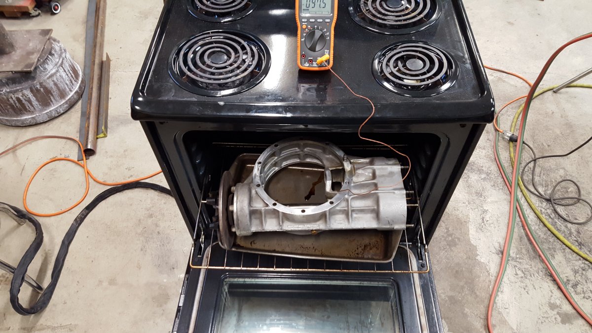

    Thank you for the reply. Attached is a pic of the rear of the housing and you can see the pinion retainer is removed. But I could see that as a definitely a potential problem. I let it soak a 350 for 1/2 an hour with a thermal couple on it reading active temp while in the oven.
    I think I'm going to try to reheat and double check the temp. With my IR point and shoot.
    Then try to tap down on wood like you suggested. Hopefully she moves. Cross your fingers. Lol
    I will let you know about the scrap. o_O

    Thank you for the help. I reheated the center section to 360 at 30 min insuring the area around the pinion bearings wear 350°. A couple of wacks and the pinion assembly was on my fab bench.

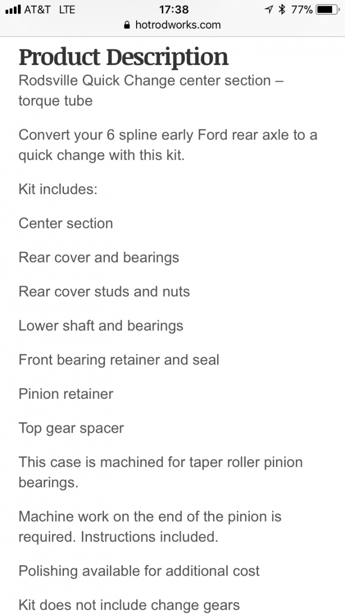

    Sorry to hijack this thread but, i have a rodsville case i am about to build. Its gonna be set up with the ford pinion bearings. My question is, is the pinion support bearing used a stock ford bearing?

    I don't know if Rodsville bored their cases for the double tapered roller bearing. If not, you will have to grind the o.d. of the bearing race about .0015".
    My guess is that it does not. Ford used a fractional sized bearing (2.000" o.d. and 1.000" i.d. if i remember correctly.) All the Quickchange cases I have ever worked on used a metric bearing. This means that you have to turn the nose of the pinion to fit. Since you are already having to cut the splined end for the rear cover bearing, that shouldn't be a big deal.
    Do yourself a favor and use a roller bearing on the nose of the pinion. It's only about 100 times stronger than the ball bearing. I have them in stock if you need a source.
    I don't know if Rodsville bored their cases for the double tapered roller pinion bearing. If not, you will have to grind the o.d. of the bearing race about .0015".

    This is what it says about the rodsville cases

    lodaddyo,
    There is your answer, pinion bore is correct for the Timken bearing. The nose diameter bit still applies.
