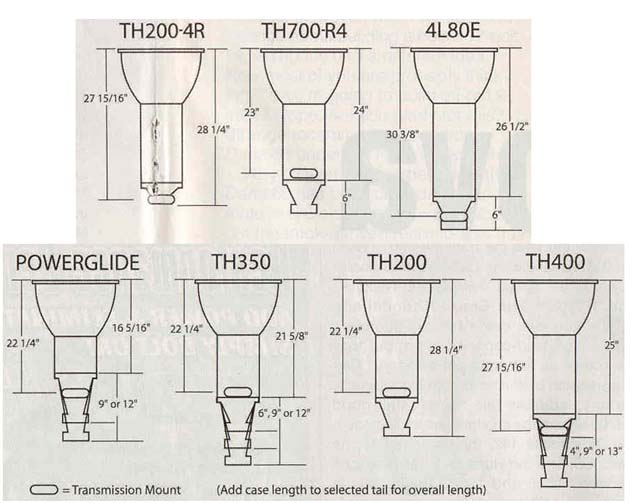

    I recently sold my Cometkazi truck to a friend of my wifes. She thought she would be OK with the 4 speed but now she wants me to swap it out for an automatic. So I have a few questions maybe you guys can help me with. I'm pretty sure it will use the same crossmember mounting location but, looking at store bought TH350's I see 2 options on the tail shaft length a 6'' and a 9" which one would be the same as the Muncie so I wouldnt have to change drive shaft length? It looks like Summit sells a TCI street fighter, they also sell a Performance Automatic brand for about the same price and I see B&M has one but Summit doesn't carry them. Does anyone have any experience with these ready to run 350's or have any recommendations? Its a mild blown 327 probably make 450 or so HP at the flywheel 2400 pound truck with a 342 gear. I figure I will need a flexplate, converter, trans, lokar shifter, dipstick, transcooler and lines and about 3 gallons of fluid. am I missing anything else?I'm kinda bummed she wants to do this but its hers now so its her call, I just think its way cooler with the Muncie, Thanks in advance Mike
  2. I not positive but I kinda remember there are 3 tail shaft length for a TH350. You need the shortest one. And then there is a fine spline and course spline output shafts so you driveline might need a different yoke.

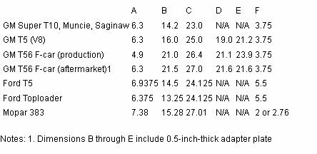

    Now I'm a bit confused. The chart above shows the Muncie total length to be 29.3" and the TH350 to be 27 5/8" (6"tailshaft) I thought there was one that was a direct swap, (same trans mount and driveshaft length) am I wrong about that? I have swapped a few autos to Muncies and don't remember having to have a driveshaft made but it's. even a long time maybe I'm remembering wrong?
  11. TudorJeff
    Joined: Feb 13, 2007
    Posts: 1,132
    TudorJeff
    All the direct swap transmissions are "slightly" different in lengths but the splines on the yoke are usually long enough to make up the difference. Same as when you lower or raise a vehicle and the splines stick out a little further or a little less. Since you are going about 1.5" shorter, you should not have any problems with the yoke sticking out further. If it does not engage into the transmission far enough to make you comfortable, you can get a longer yoke and just swap out that part, even can be trimmed to fit.

    I pulled a TH350 out of my high school 1969 Malibu, and put in a M21. I do not recall moving the crossmember, and I did not change the drive shaft. I do not recall what the tail shaft length was, but if someone else has that detail, that is what works. The holes in the mount pad are slotted, so a bit of change can be accommodated. You might need to slot.
    Also, if I remember correctly, the mounting pad on the TH350 is on the main case, so that does not move, regardless of tailshaft length.
  23. gimpyshotrods
    Joined: May 20, 2009
    Posts: 23,330
    gimpyshotrods
    I want to say that it was the 6" tail housing, which I think makes sense.
    With a 6" tail, a TH350 is 27.625".
    A Muncie/Saginaw is 28.3", for a difference of 0.675".
