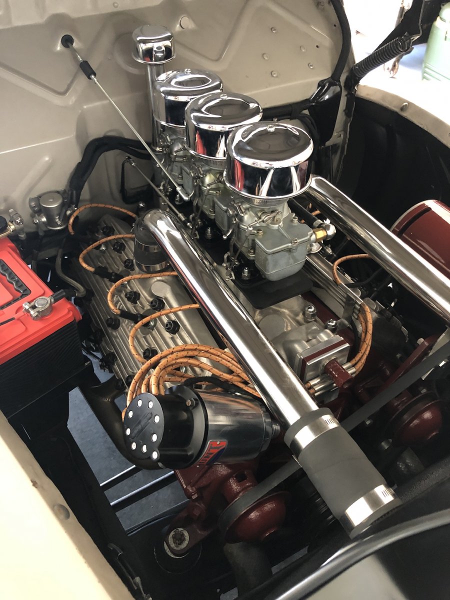

    Mallory Unilite install complete. I set it up with the lighted advance springs to try to get all of the timing advance in as early as possible.
    Runs much better. No more popping on acceleration. I need to readjust the mixtures, but it just might be ok. I’ll drive it tomorrow morning.....we’ll see.

    What is the black plate or sheet under the carbs?
    Dave
  7. Norris McCarty
    Joined: Apr 19, 2007
    Posts: 326
    Norris McCarty
    Carb insulators. Suppose to shield/insulate them from heat. These are from The Carb Shop.

    Dizzy fixed it. The Joe Hunt May need a coil. I’ve seen where guys have used an external coil.....not sure. Anyway got the new plug wire ends on and mounted the coil, finished the wiring and drove it. Mucho bueno! For the first time since I’ve owned it the carbs adjusted easily. It idles like a sewing machine and runs out extremely well. Transition to the “other four barrels” is seamless.
    Thanks for y’all’s help.
    Oh yeah.....KEEPING THE TRES 97s
    Here’s a couple of pics.
