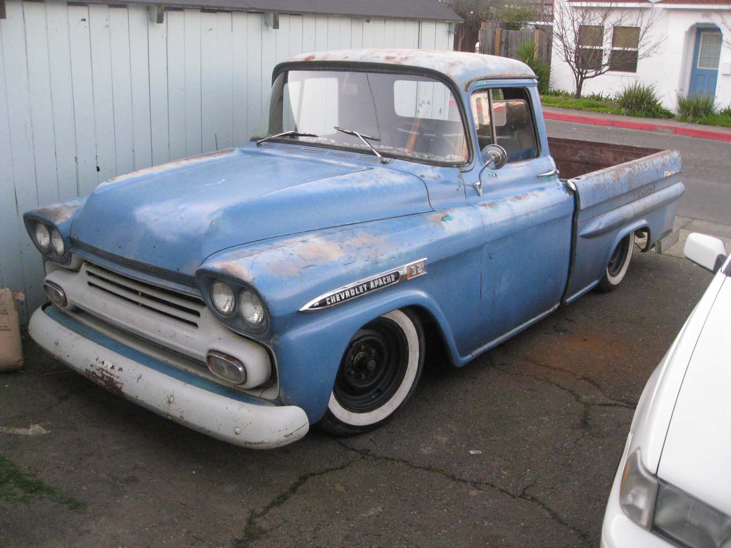

    The ride was great just like stock till I put it the mono leaves in front to bring the front down the extra 3". Now the axle hits the frame on medium+ bumps and is kind of stiff up front. When I have time I will C notch the frame for the front axle and possibly de-arch some stock springs to get them to the same or a little lower ride height. In the rear the axle is flipped with 3 springs taken out of the leaf pack. Going to add 1/2" blocks to the rear to bring it down a hair.
    Here is a picture of how it sits. I wish I had a better one

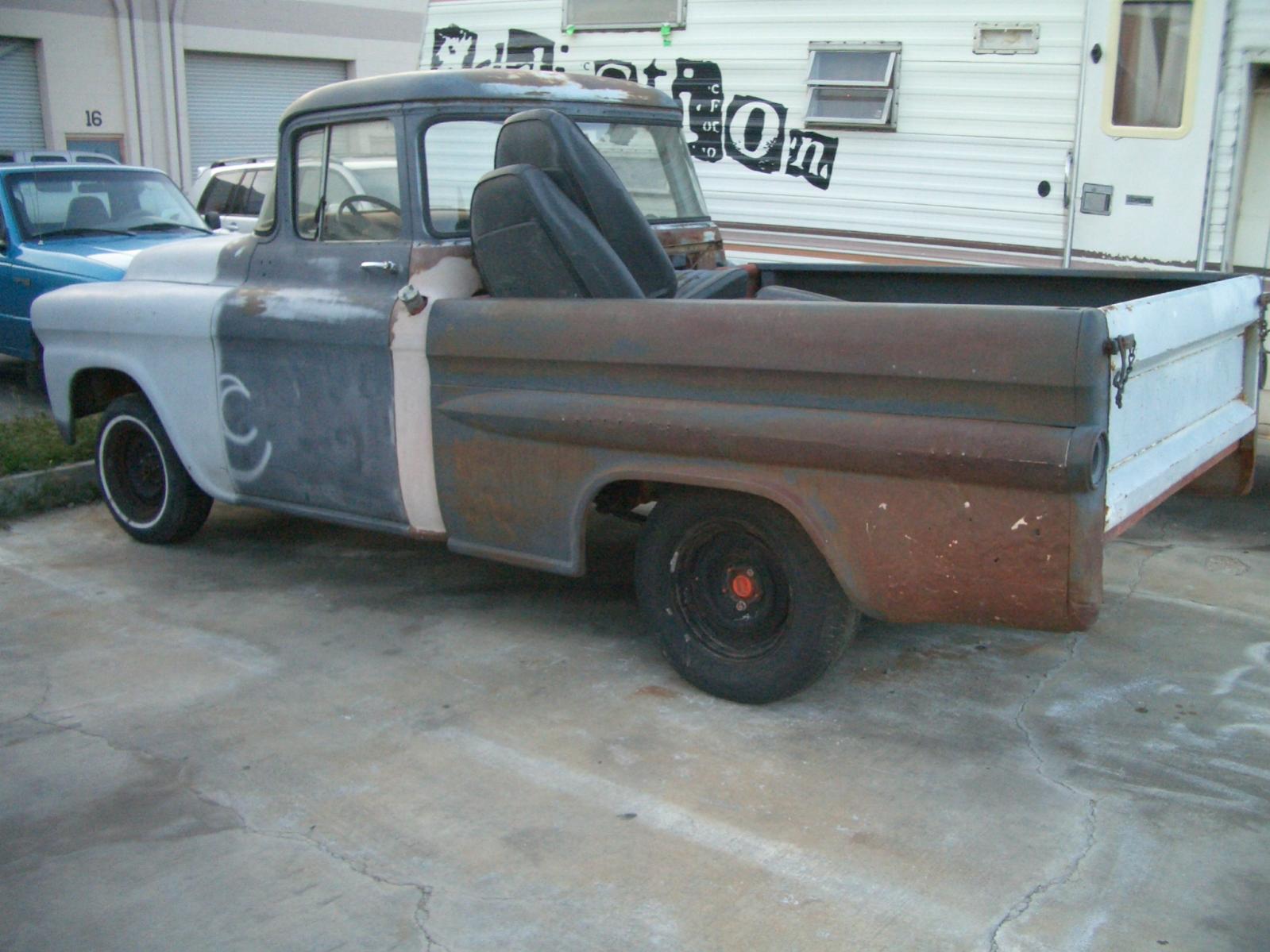

    Update:
    Ended up going the Camaro clip route. To make it even more interesting, I managed to find a '67-'69 Camaro clip with disc brakes and rear steer power steering.
    The really cool thing about this clip is that with the rear-steer setup, the steering box is much closer to the original position as a '58 Apache, and less crowding up front by the radiator/core support. So, that much easier (I hope).
    Haven't begun the actual install yet, however I'll post some pictures when the work begins...hopefully soon. In the meantime, here is the patient:
