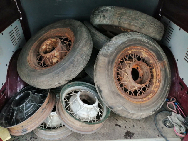

    Hi Guys,
    I scored some wirewheels today which i tought were ford 5x5,5.
    Kinda rough but very cheap
    Much to my suprise They didnt fit.
    So i measured them and They were 5x5,91” or 5x150mm.
    I havent found any results by searching Google.
    Does anyone know what i scored?

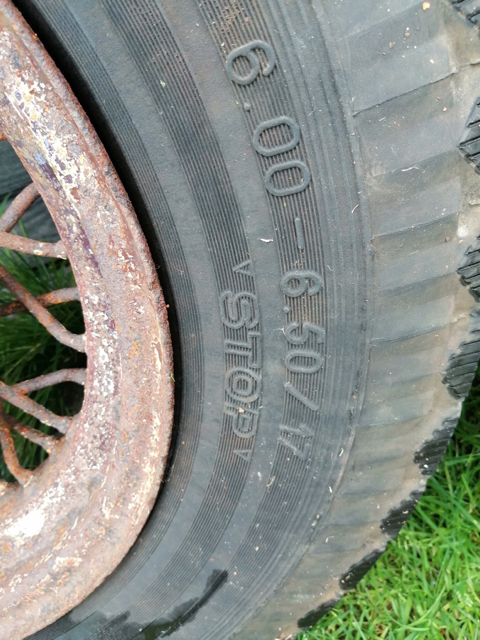

    More pics [​IMG][​IMG][​IMG][​IMG]

  3. Looks like the 40 bent spoke wires, there were two aftermarket manufactures of these wheels, Motor Wheel and Kelsey-Hayes. HRP

  7. All Buick from 1930 on is 5 on 5 inch
    All Cadillac from 1930 on 5 on 5 inch
    All Oldsmobile from 1930 on 5 on 5 inch
    All Pontiac from 1930 on 5 on 5 inch
    No offense, check how you are measuring, you can find posts
    here on the HAMB
    Or and maybe your drum is not Ford.

    I pulled the tires and look inside the rims
    KH-made in U.S.
    So my guess is as Good as anyone
    Verzonden vanaf mijn iPad met H.A.M.B.

    They look like 33 Buick 60, 80, and 90 series. What's the hubcap size? 7 1/8"?
  18. demonss
    Joined: Feb 8, 2007
    Posts: 64
    demonss
    from Belgium
    yep, that's the hubcap size!
    so i guess they are '33 buick!
