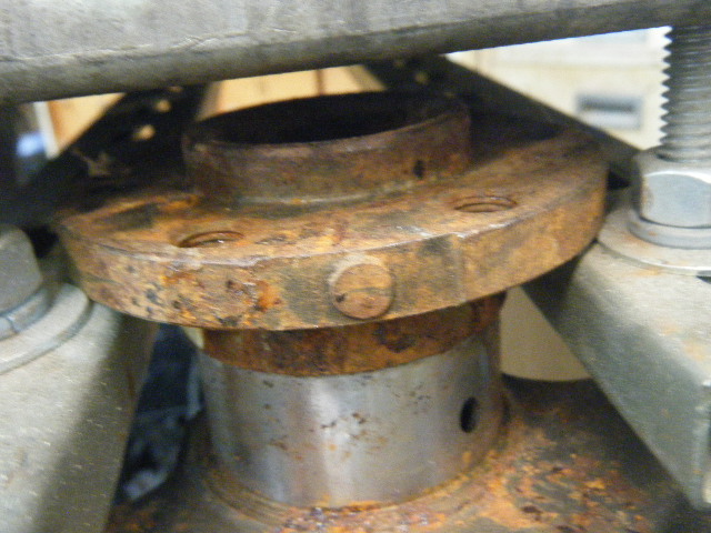

  3. Almost all of the 312 cranks have the "dot"
    I have heard and also experienced one 312 crank that did not have the "dot" .That engine/crank without the "dot" was in a Canadian produced 312 engine.
    I dont believe there ever was a B8AE casting. There is a B9AE casting that is both a 312 and a 292. You will usually find those B9E casting in Mercurys.
    Picture of the 312 identifing "dot" below.

  5. My understanding is that crankshaft is the easiest identification. And, the one 312 I own has that feature on the crankshaft so at least that one was verified that way.
