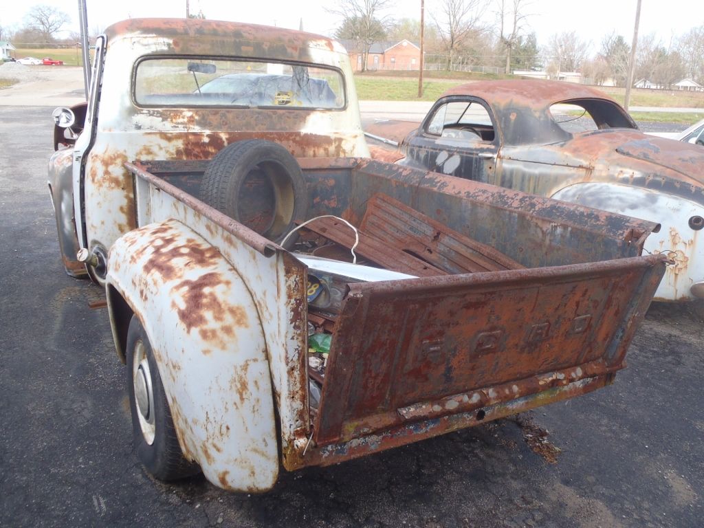

    And since everybody likes pictures...
    It's really not as rough as it looks. I've got a good F-600 hood and fenders I'm getting with it, but if I'm not painting it, I'd just as soon sell the good hood and fenders (and not have to worry about cutting them down to fit the F-100) and leave the originals on the truck. The biggest thing that bothers me about leaving it unpainted is it just doesn't have any patina. Someone did a poor, half job with some rattlecan primer and just left it. Except for how long it would take, I'm tempted to strip it with a wheel and/or chemicals and leave it bare metal to at least look more like the hood.
    [​IMG][​IMG]

    You're going to strip a truck to bare metal so it's rusty like the hood, then film it doing burn outs to attract customers?

    :rolleyes: You can make anything sound bad when you take it out of context.
    In my opinion, and yes it's just an opinion, the truck looks kinda like crap the way it sits. Somebody did a half @$$ job with a primer spray bomb on the truck. None of the panels are even close to matching, not to mention how many times I've seen someone use primer to cover up a piss poor bondo job or crappy work. Like we were discussing in Leave it or Prime it? What's better?, people will shoot a vehicle in primer just to hide stuff and try and make it look better. A lot of people, myself included, will steer clear of one that's just been primered because of that. So, even if I am able afford shooting the truck in primer, I won't unless I can paint it as well. That leaves: 1) leaving it as-is, 2) spray painting the entire truck, 3) at least sanding off the gray primer. None of the options appeal to me, and I doubt that I will sand it down, but I hate the uneven, half @$$ look of it. If it were original paint, it would be one thing, but it's not.
    ETA: I don't know, maybe even a cheap, roll-on paint job or something I can do myself and then sand down to make it look worn (or not) might work. All I know is I just don't think it looks right the way it is.

  25. I'm a long way away. But that trucks looks like a lotta work to get to a stage where it would be attractive to a customer or a tool to advertise what you can do.
    Depending on what you plan as the type of work for your business. I'd be looking for something a little better to begin with.
    We have one of these trucks in the shop at present, a lot better than that one to begin with for a customer.
    The Jag front end is an easy fit, but the tracks a little narrow. A jag rear is possible but it's not as straight forward as the front conversion.
    If you want to do a cheap, cool affordable project try something like a 30's truck cab, fabbed rails, SBC or Ford, Auto, four link or hair pin rear end and live axle and a beam axle out front with any grill shell and a shortie pick up bed.
    Not much body work to dal with. The parts are avaialble inside you budget, and done right there's plenty of impact as well.

    Whoa. I hate to pop your bubble but IMHO there is no way to get around bodywork on that truck, it's rough, it's ugly and it's rusty. I'm not trying to be mean here but that truck is a sink hole. You sink all the work and money you decribed above, trying to sell it I would think you would be real lucky just to get your parts money out of it. Without doing anything to the body, it will scream pos. Can't say for your area but around here that is a parts truck/ junkyard fodder, adding some nice parts would mean it's a better parts truck!
    You admit you hate the way it looks and can't afford to do anything to fix that. If you hate the way it looks do you think your buyers will feel any different? Maybe you should look for a better project to start with?
    My first post I said I avoid any project that require a bunch of bodywork or rust repair, the labor involved is a deal killer. Sorry, but your truck is exactly what I was reffering to, I see no way that it would be finacially feasable to take that one on without losing money on it. It would be ok if you liked it and wanted to keep it (build it as a hobby like a lot of guys do on here) but thats not your intent according to your op.
    FWIW I don't think the cheap, roll on fake patina will help. We have a guy around here that builds trucks and his trademark is fake patina. Not my cup of tea but they really look convensing and their popular, he gets good money for them... but. He does the bodywork first , then the paint job and really, it's as much work if not more then a normal paint job. Without doing bodywork the truck you have the fake patina really wouldn't hide anything.

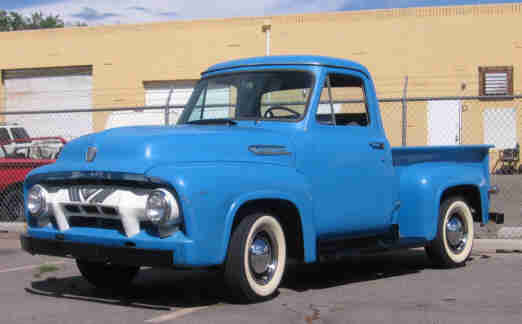

    I'm going to throw this out for example and again I realize things might be different in your area rather then our dry SW.
    This 54 is in our warehouse waiting it's turn. We bought it awhile back, it's the type of project we seek out. Runs and drives with stock original drivetrain (motor recently rebuilt), absolutely zero rust, cheap paint over ametuer body work but you can tell it all minor stuff other then it needs a tailgate and bed front. Good glass all around. We got it for $2500.
    You never said what you have to pay for the one you are showing but even if yours was free can you not see this one has a $2500 advantage?
    FWIW here the rough build budget on this truck. Purchase, $2500, Body off (show) paint job, $10000. Rebuild suspension, brakes ect (motor & tranny already done), $5000. Repop interior kit, $1000 Add another $1500 for tires and misc. These prices are parts AND labor. Since this truck is so stock and all there it will be a stock restoration instead of custom. Grand total is 20k. Restored trucks like this have been selling at auction for around 25/35K (average 30K) lately, down from the 45K they were bringing a couple years ago. Still, even with a soft market still doable and make a few bucks. Might seem to some to be high on the paint and body but that is by far what make vehicals like this bring top dollar more than anything you do.
