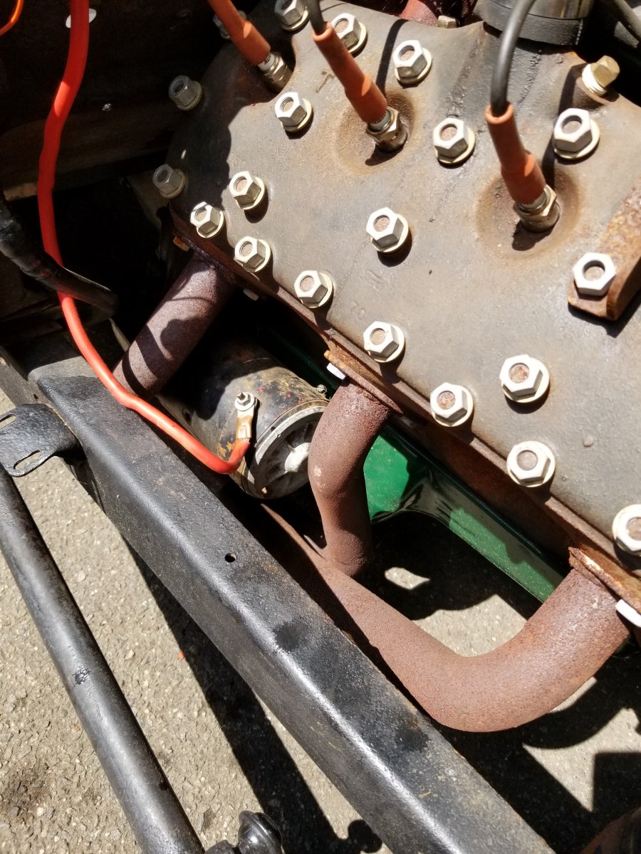

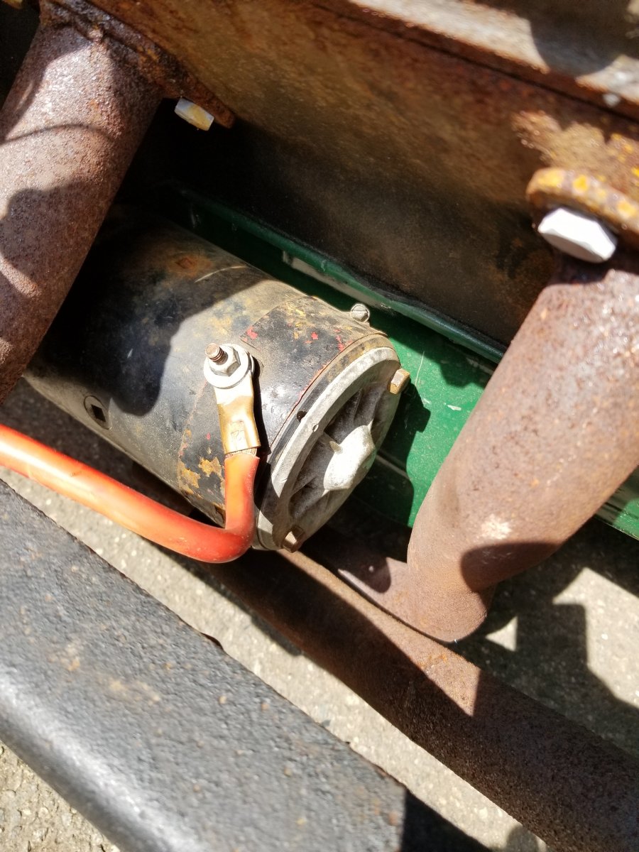

    This starter is bolted to the bell housing via the two bolts shown, they pass through the body of the starter

    Try confirming a good ground, by clamping a good jumper cable to the ground on the battery and to that bolt you see going through the starter body. The starter needs to complete the ground circuit from the starter housing back to the battery. It requires a clean connection to the bell housing and a flex ground strap from the engine to the battery. Rubber motor mounts are not a good conductor.

    you should also have a small bracket that goes off the case bolt and over to one of the oil pan bolts. they help ground it and really add a lot of stability to the starter

    Also it appears the bracket from the starter bolt to the oil pan is missing.

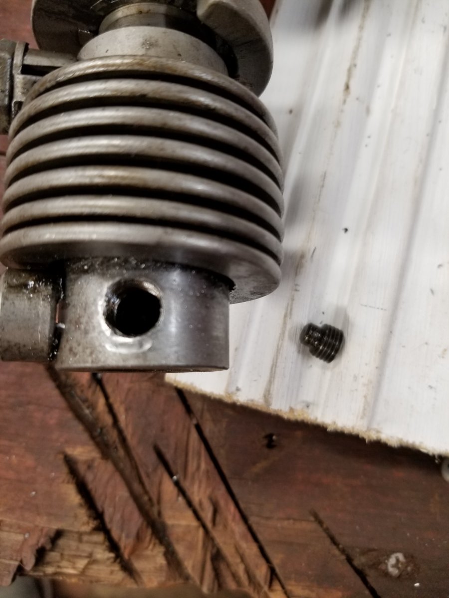

    Well, I think I found out what's up with the starter. . . . I will drive that out and try to locate one tomorrow.

    Turns out what I thought was a pin is a bolt that broke off, yay! I get to drill this out. Wish me luck.
    Anyone have a picture of a similar starter? I would like to know if I need a special bolt head and if I need a lock washer, flat washer, both, etc. Thanks, Ron

    15976103658518196155390254272529.jpg feeling very fortunate right now.

    yes, its a special bolt with a shoulder, and a special lock washer to do it rite
  18. Yes it is as rusty valley said. Take the other bolt out of the spring for a sample. Doubt you'll find anything close at a hardware store.

    might want to find the head of that bolt too before the flywheel does
