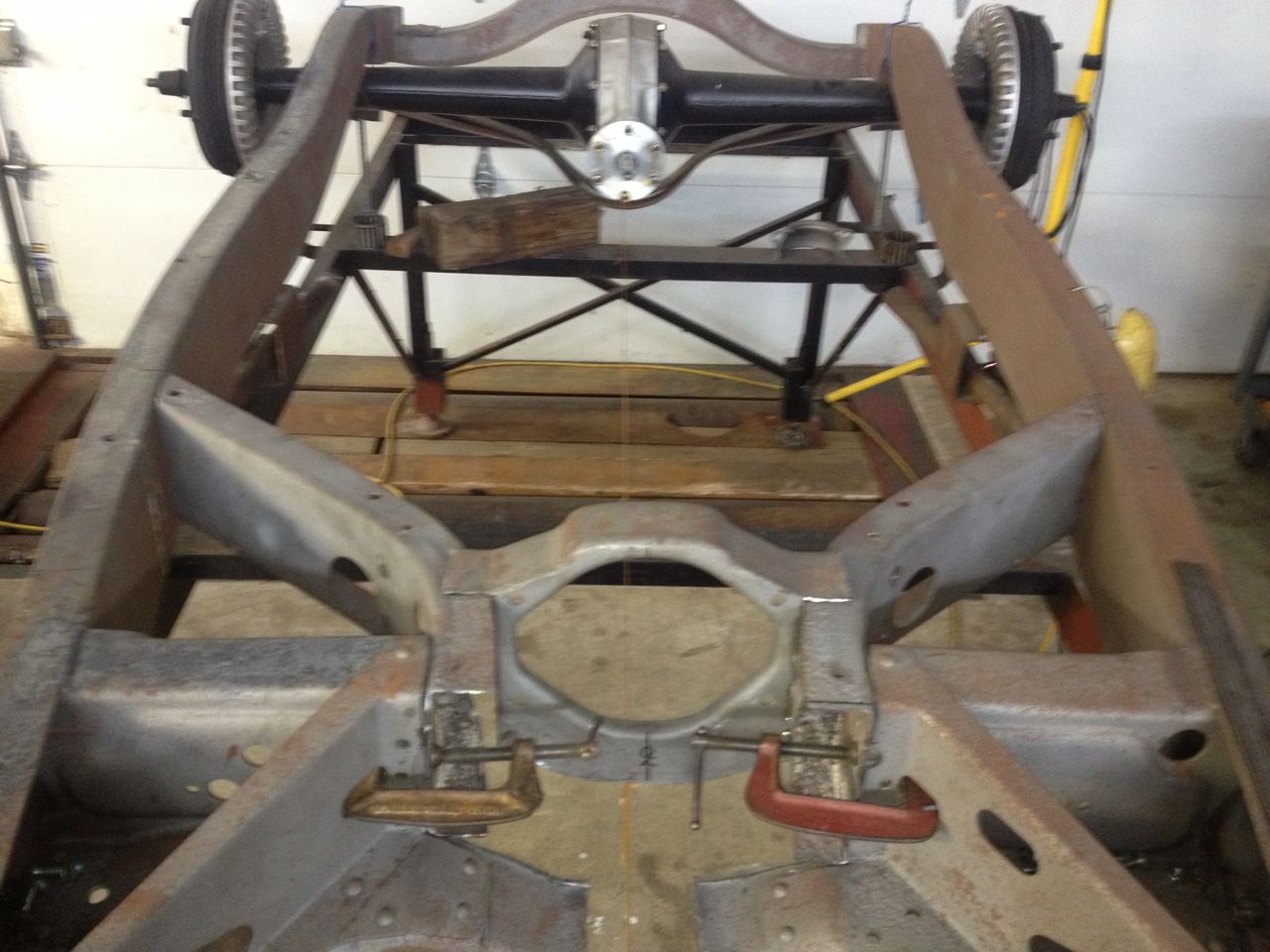

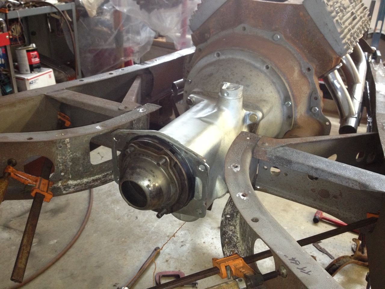

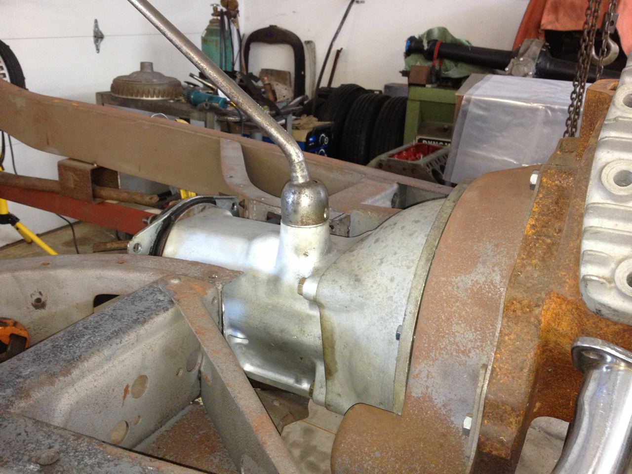

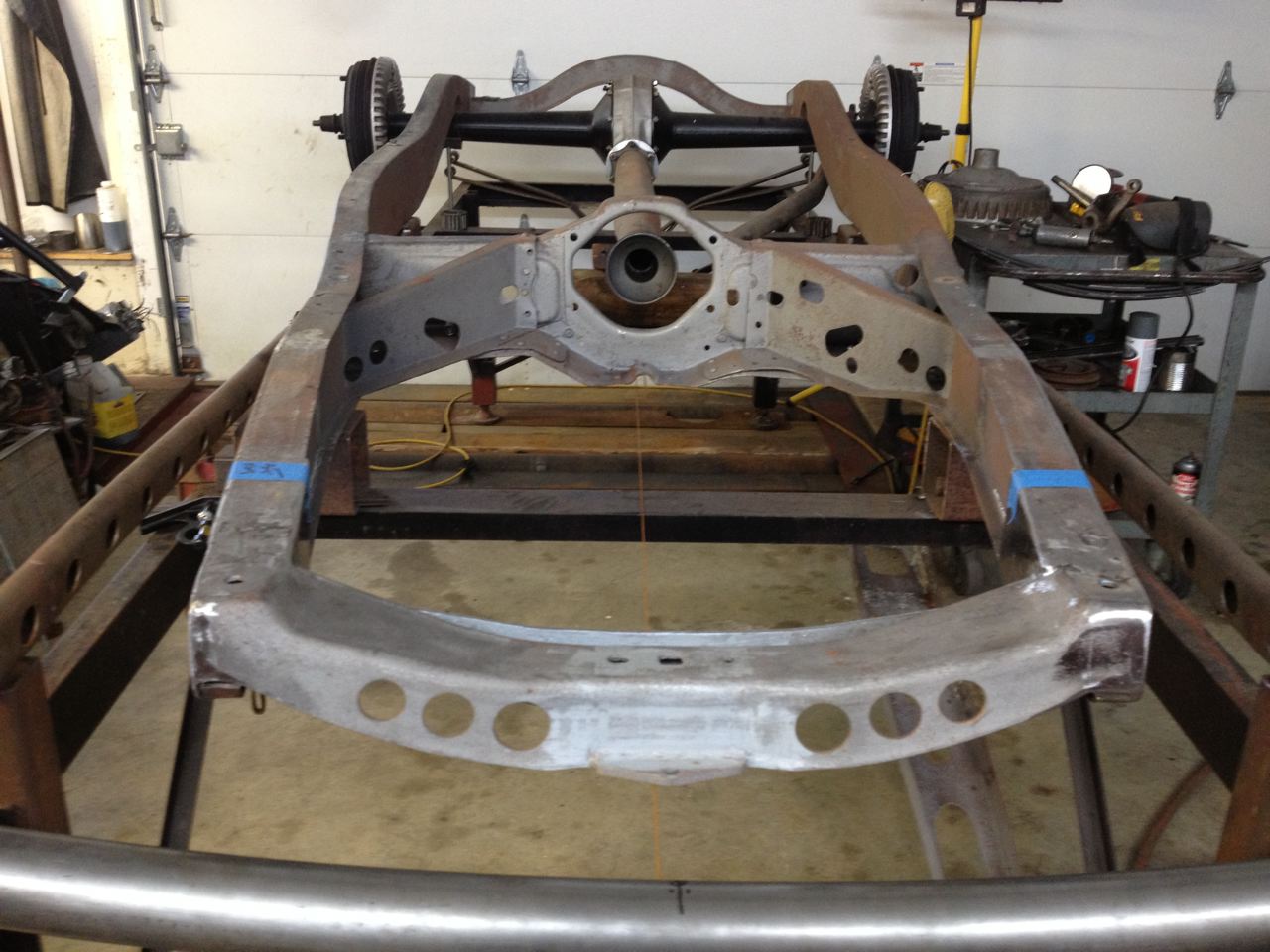

  22. mcbay
    Joined: Aug 20, 2007
    Posts: 512
    mcbay
    32 frame.jpg cut k member.jpg donor x member.jpg right leg .jpg mock up.jpg Ford trans.jpg Cad box Offy adapter.jpg Cad in place.jpg Cad in place 2.jpg 32 frame.jpg
    Submitted for your approval....after much talk on this topic it was time for Action.
    So, out came the sawsall and the K member was cut as shown in the photos. A 36 X member was cut to make the rear legs as shown.
    Then, the Offy adapter was mounted to the mockup engine and then the converted 37 case and 32 rear mount. This set up was just under 3" longer than the Ford parts. Once this new assembly was lowered into the frame and positioned I made the frame mounts and was ready to address the rear mount.
    Several options were apparent, use the 32 mount or a later saddle mount, but I think I will use the 32 and box the legs from the mount forward to the K member.
    Thats it so far....

  25. Bruce Lancaster
    Joined: Oct 9, 2001
    Posts: 21,681
    Bruce Lancaster
    That's shaping up well...and it all looks very Ford, not a rat's nest of steel stock like on a streetrod.
    So, ultimately the center of the K is going to move back in with enlarged center hole and a new home 3" aft...is that correct?

  27. mcbay
    Posts: 512
    mcbay
    That's it and here it is in place...
