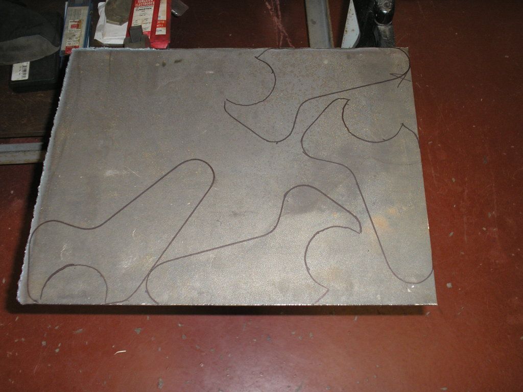

    I'm on a little break from work right now I thought we would build some ladder bars. I'm going to be busy tonight so this is all I'm going to do today. I could not find a good built ladder bar that was at least 48" long all the ones I found were just to weak looking or had rubber bushings I guess they were for a street car or something. An old school gasser needs long bars to look right I think. In this pic the brackets are drawn out on 3/16 4130 plate.[​IMG]
