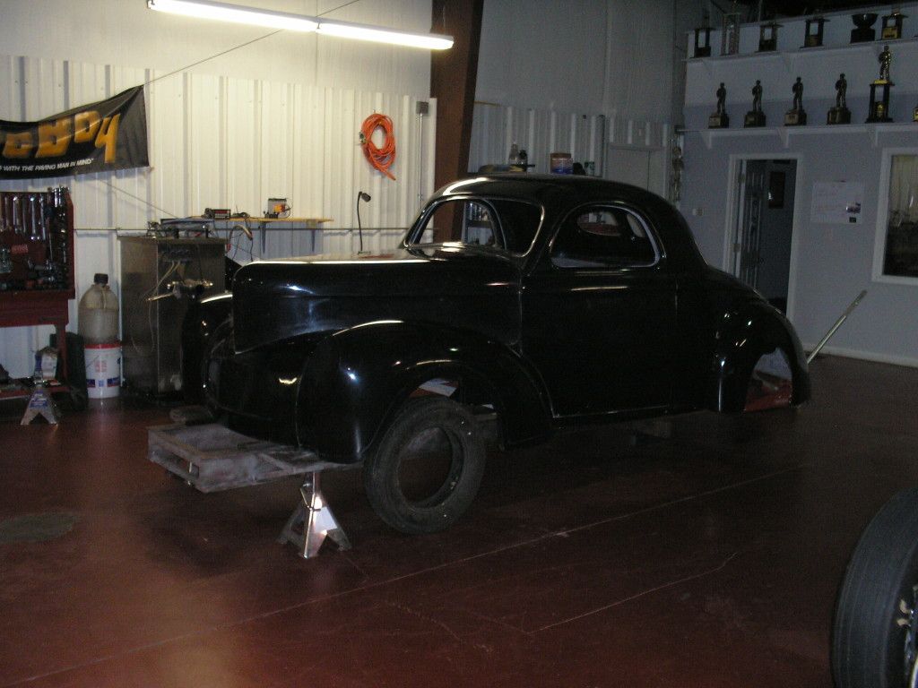

    Ok here it goes first off I'm not a computer dude but I try I'm also not good at taking pic's. But everybody keep's asking me to do this. The car has already been run so this is a pic of the way it looks now then I'll start with the build If you guy's that do this all the time see that I need to do something different with this thread let me know[​IMG]

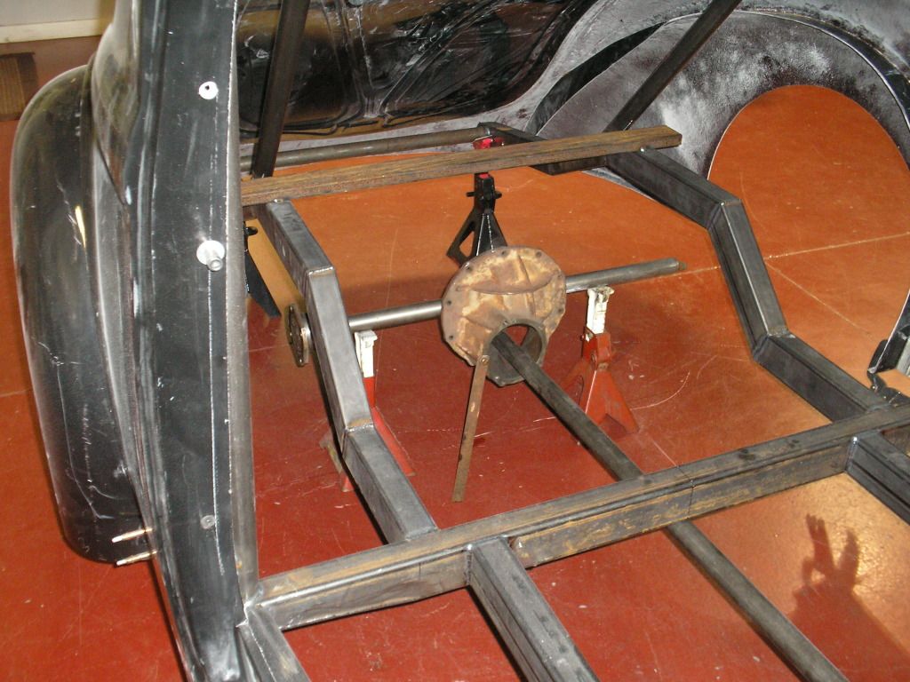

    This is the rear section of the chassis. I left room for the ladder bars to go on the out side of the frame rails. You might notice that they are mig welded I had intended to mig weld the whole car because I wanted to build it quick but I changed my mind these welds were ground of later and tig welded[​IMG]
