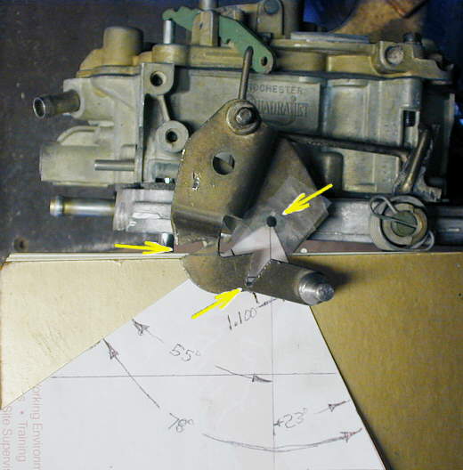

    TH350 cable is just a down shift cable. TH700r4 is a pressure regulator that has a different linkage for the carb to supply correct pressure through the throttle range. They sell correctors for the different carbs. If you don't use it, the trans self destructs on short order. All Holley Street Demons have the correct geometry for the 700r4.
